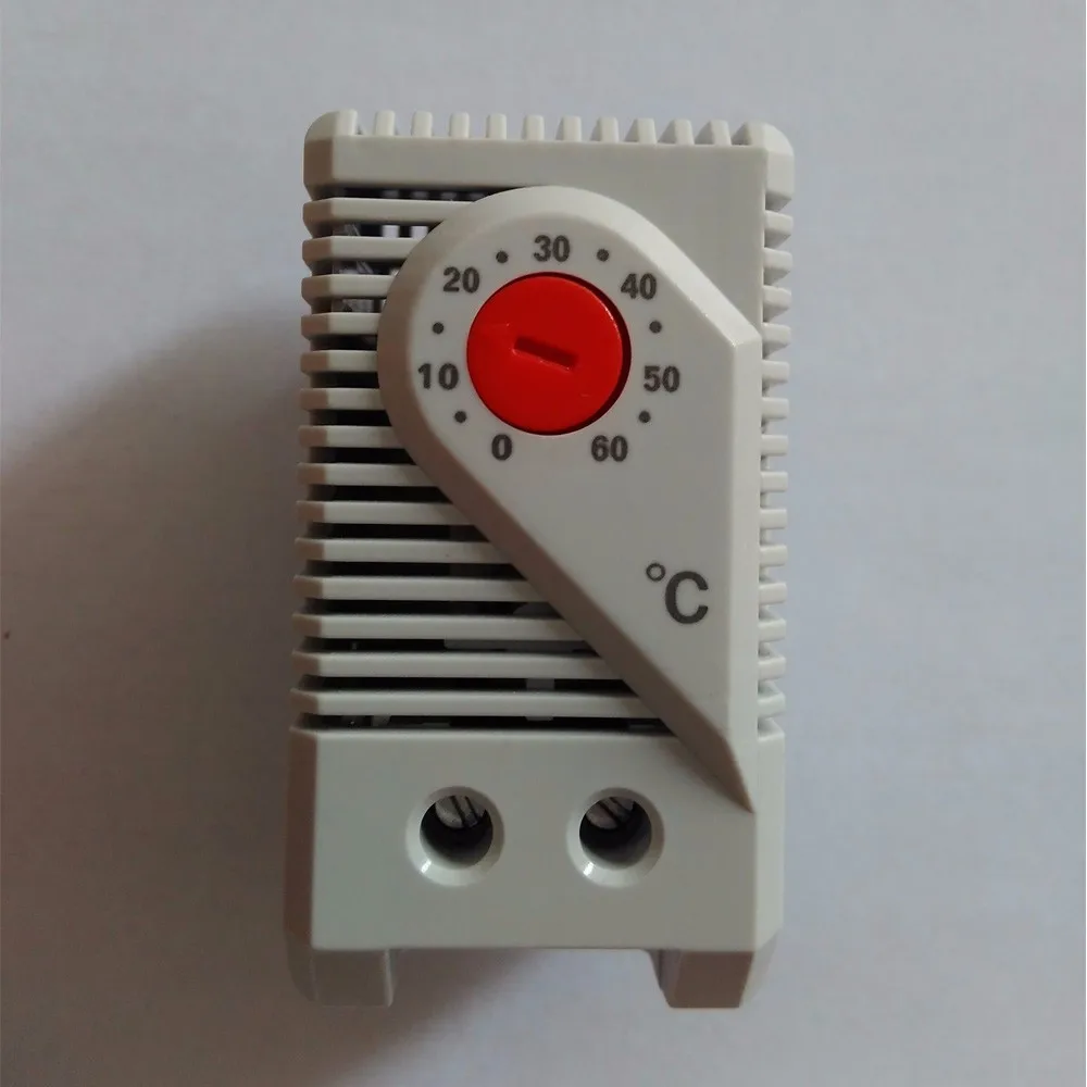

You could use a basic mechanical thermostat to stop and start the fan when the temperature changes.
100-pieces-KTO011-Industrial-font-b-Thermostat-b-font-0-60-Degree-with-normally-closed-contact.jpg
Depending on the type of fan it may be possible to completely control the speed using a PID controller and SCR but that's probably over complicating things!
