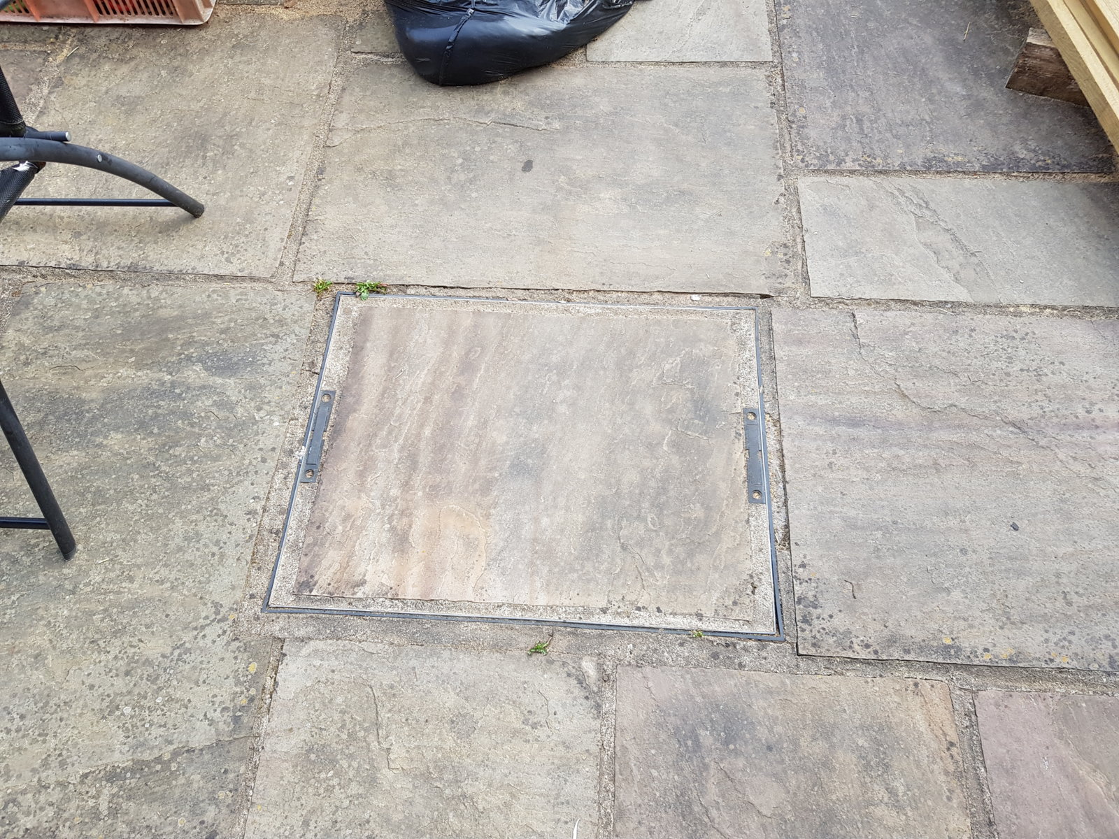

Fit a recessed lid.
This is what the guys did who laid our patio a few years back, doesn't look out of place imho..
