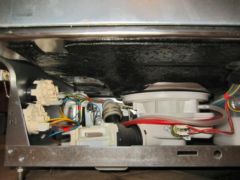

Then I removed the lower front (black plastic) panel and found all the main 'engine room' gubbins.
Apart from the motors, the most interesting thing seems to be two conjoined round white plastic devices which the parts list identifies as "level switch" with red/white polythene hoses leading to the filter basin. It's all surprisingly clean under there and all connectors seem sound. Further suggestions will be most welcome - many thanks.

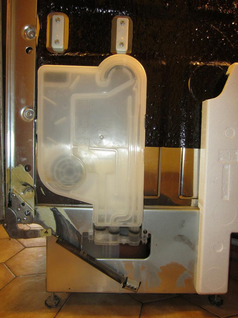

Looks like the water softener unit on your model is on the RH side.
In which case the brake-tank will be on the RH side as well. Typical Candy.....changes not documented :rolleyes:

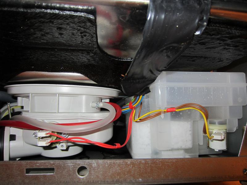

Ah, there it is! - behind the right hand front panel...
The service manual refers to is as a "water softener capacitor". However, I can't see a "flow meter" - there are no electrical items attached - it's just a plastic tank.
There, is, however, an electrical connection (yellow/brown wires) to a gizmo on the bottom of the water softener visible from the RHS lower front of the machine...
The only other electrical connection I can see in that area is to another gizmo on the lower front of the filter basin (2 red wires), which the service manual refers to as an "NTC probe" (item 287 on the diagram)...

Since you don't have a litre counter turbine...or a flowmeter on the brake-tank we can assume water load is handled by the two white pressostats in your photo, the pcb, + a safety switch which you can't see without removing the baseplate. It also looks like this machine is fitted with an Askoll circulation pump, & these have been fraught with problems. The original error code you got (8 flashes) indicates a heating error. Which seemed like a red herring to begin with, but now I'm not so sure. When the machine pulsed did you notice a pronounced clicking noise? If yes then I would suspect this comes from the safety switch. This in turn may be caused by a bad circ pump. If you feel up to a challenge I would remove the baseplate & check the circ pump for a loose/damaged impellor.
