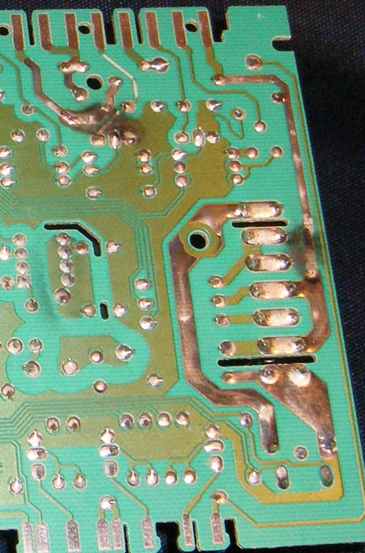

I was cheating as my wife was doing the typing while i was looking at the washer, anyway removed the pcb just to see if i could see anything obvious...and look what i found (looks like TC3 has blown and destroyed most of the tracking around it also the tracking at the top of the board J12 J13 J14 has burnt out)

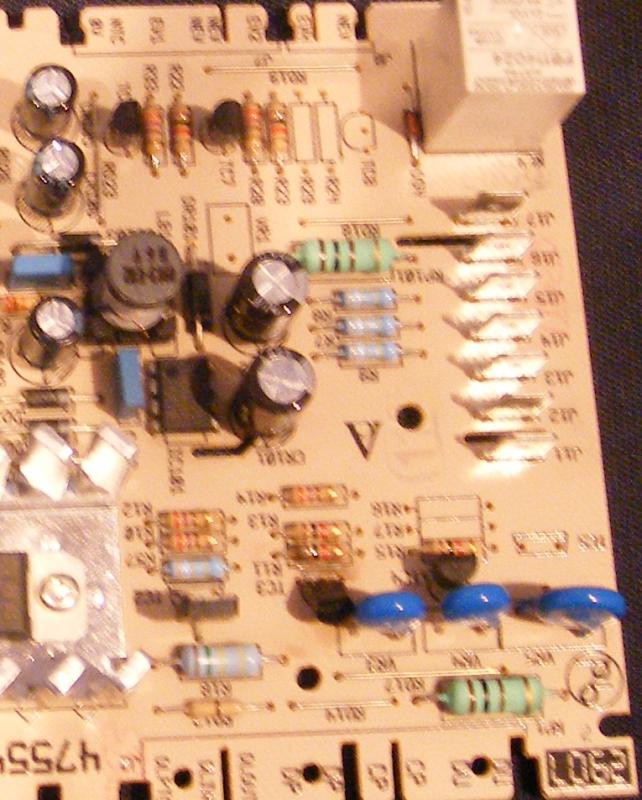

Photo's a bit out of focus but I see what you mean. If you post a good close-up of both sides of the board & the details printed on the pcb case I will try to identify the root problem. Can't promise anything but I'll try. It could be as simple as the the heater relay/tracks are blown & that caused your issue. But often another shorted component can easily take out the pcb. So replacing the pcb before first verifying that the other electrical components are intact can soon become a very expensive affair :eek:
Ok...here we go.
TC3 is the drain pump triac.
J11 & J12 is the feed for the heater element (230v output).
J13-14-& 15 relate to the pressostat circuit (local damage here is likely to be caused by a flashover from J11 & J12 since the terminals are in such close proximity).
I would suggest the folowing;
Get your electrician to check the heater element resistance & IR value at 500v DC. If TC3 is blown it doesn't necessarily mean that the pump is bad but it is worth checking just in case. You could hook up a flex cable with a fused plug with 2 spade connectors & hotwire the pump to see if it runs ok (I imagine it will). Alternatively remove the pump & get the electrician to bench test that as well. You may be lucky & find that the heater (and pump) are fine & the problem is entirely down to the pcb. But it doesn't hurt to hedge your bets & get it all checked out before rushing out to buy a new pcb. One more important thing; take a good look at the connector plugs to the damaged parts of the pcb. They may be heat damaged as well, in which case you will probably have to partially replace the wiring harness. Hope this helps, let me know how you get on :D
