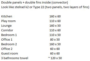

Estimated rads output is ~17 kw, average of 3 online calculators. These are the dimensions:

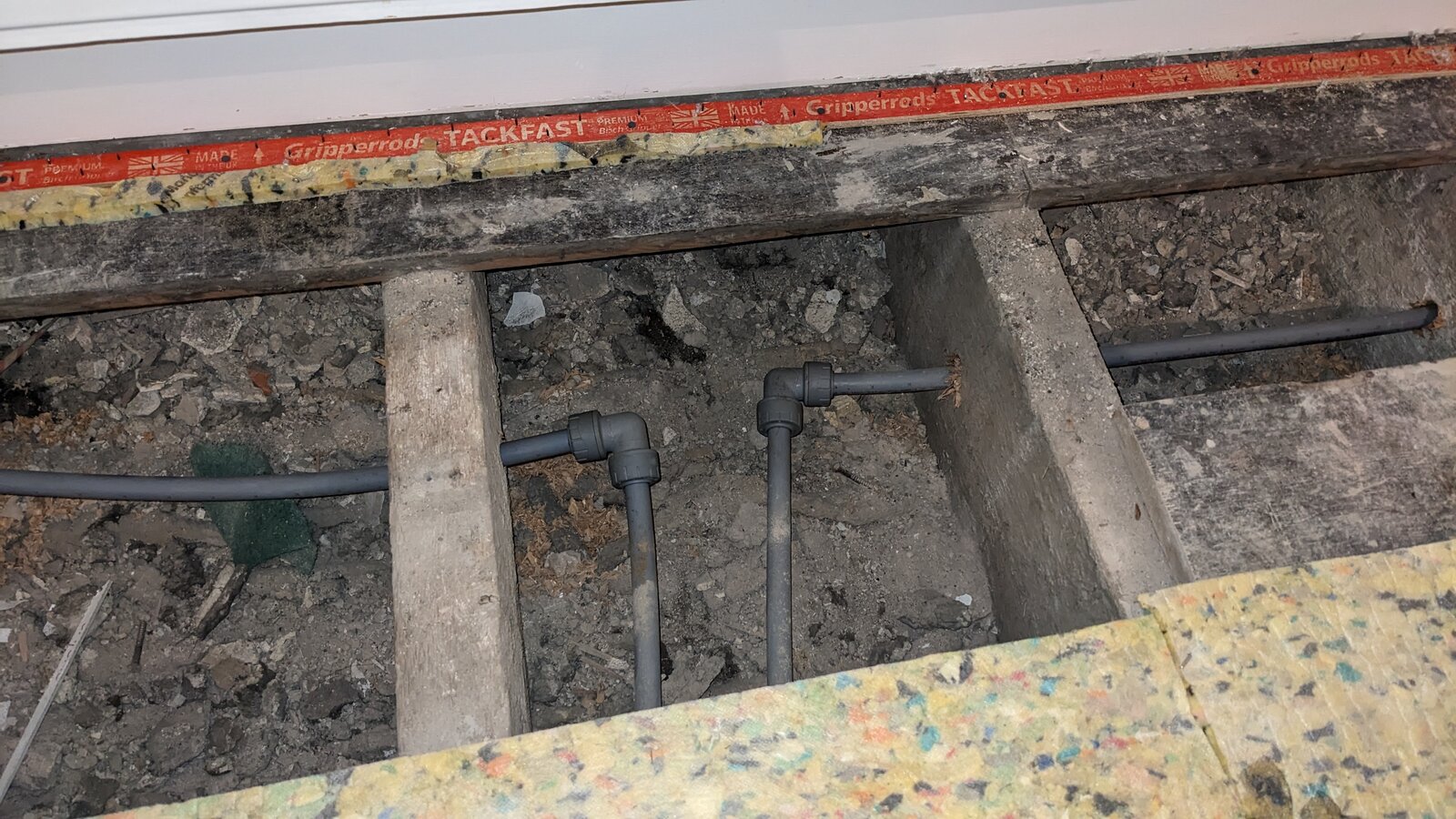

Regarding pipe work, it is 22mm downstairs where the new boiler / cylinder cupboard was set-up 7 years ago. Where the rads are it looks like this:
(Unsure if this is single or double pipe circuit.)
In your opinion what is the reason why there is only a 5 degrees differential, and how can the situation be improved?

OOI when I had a 5-bedroom detached Edwardian house, I had a 30kW boiler and rads big enough to dissipate it, and it was only just enough.
Is yours detached? How thick is the loft insulation? What is your calculated whole-house heat loss calculation?

If the radiators are fully hot and the house is cold, then your radiators are too small to heat the house.

I think your radiators are too small for your house and the boiler is bravely but unsuccessfully trying to deliver more heat than they can dissipate.

Fix the easy stuff 1st. Insulate the piping in the voids. Remove the dead pump. Check the boiler settings and system controls.

Draw the system out. Show the drawings here. Is something stupid happening?
