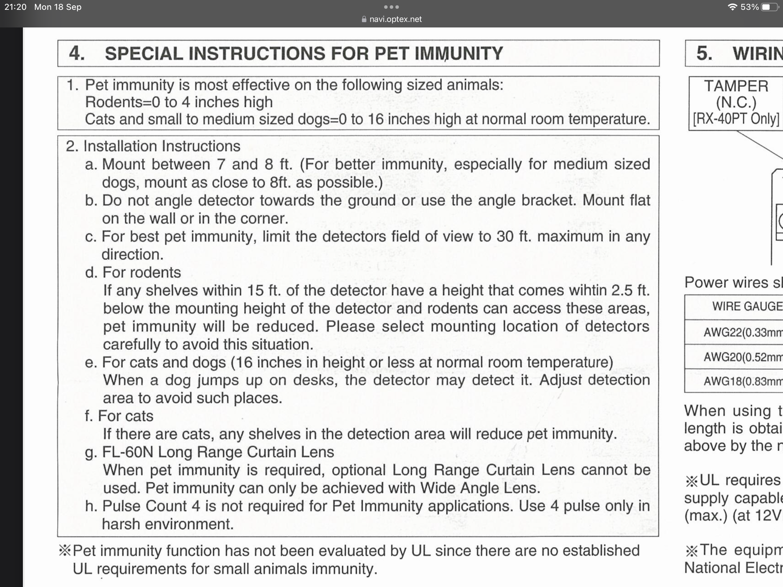

It’s not just putting up a pet tolerant sensor ….it’s seeing the layout of the room and seeing if a pet tolerant sensor is going to work …are there any tables ….curtains that the cat can climb onto or up can the cat get within 1.0 m from the sensor ?
Normally fit optex rx40 pt ( now apparently discontinued….but still available) or Bosch pet tolerant pirs
Kittens can definitely get high - table, curtains, probably the bloody walls too, tbh. The Pyronix was advertised as being insensitive to lower weight objects, but the reality seems to be that it's more about "low and high" which ain't much good here. Whether or not they can get within 1m of the sensor is hard to say, but "probably" is the answer. Would dual-tech sensors be any more likely to be more tolerant to them, or is it likely that I need to accept that kittens at head height will set off room sensors?
Eg

for example cats are usually small enough for normal sensors not to pick them up walking across the floor, but they rarely just walk across the floor.
however pet tolerant PIRs ignore below a certain height and are pointless in my opinion. As anything that gets the pet above this cut off height can cause an alarm and also allows burglars to be short or crawl around.
