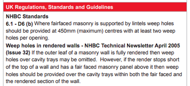

Render isn't impermeable so a small amount could escape over time. If render were impermeable, presumably water wouldn't get in so it would only be condensation anyway.
Even Encon, who have an incentive to sell more weep vents, say there's no need in rendered walls:
https://www.encon.co.uk/sites/default/files/products/downloads/rytweep_datasheet.pdf
Has the NHBC changed their mind after 12 years?
Anyway, the thing is it's bad practice and IIRC, several BS's relating to trays, render and workmanship mention that weep holes are necessary to deal with potential failures in any render, cavity condensation, or a partcular render type.
The question remains, "How does water get out of the cavity?". "Render should keep it out" is not really the answer.
Thanks for all the advice. I spoke to the builder and we will go for DPC as a cavity tray and fit a couple of vents just to be safe.
