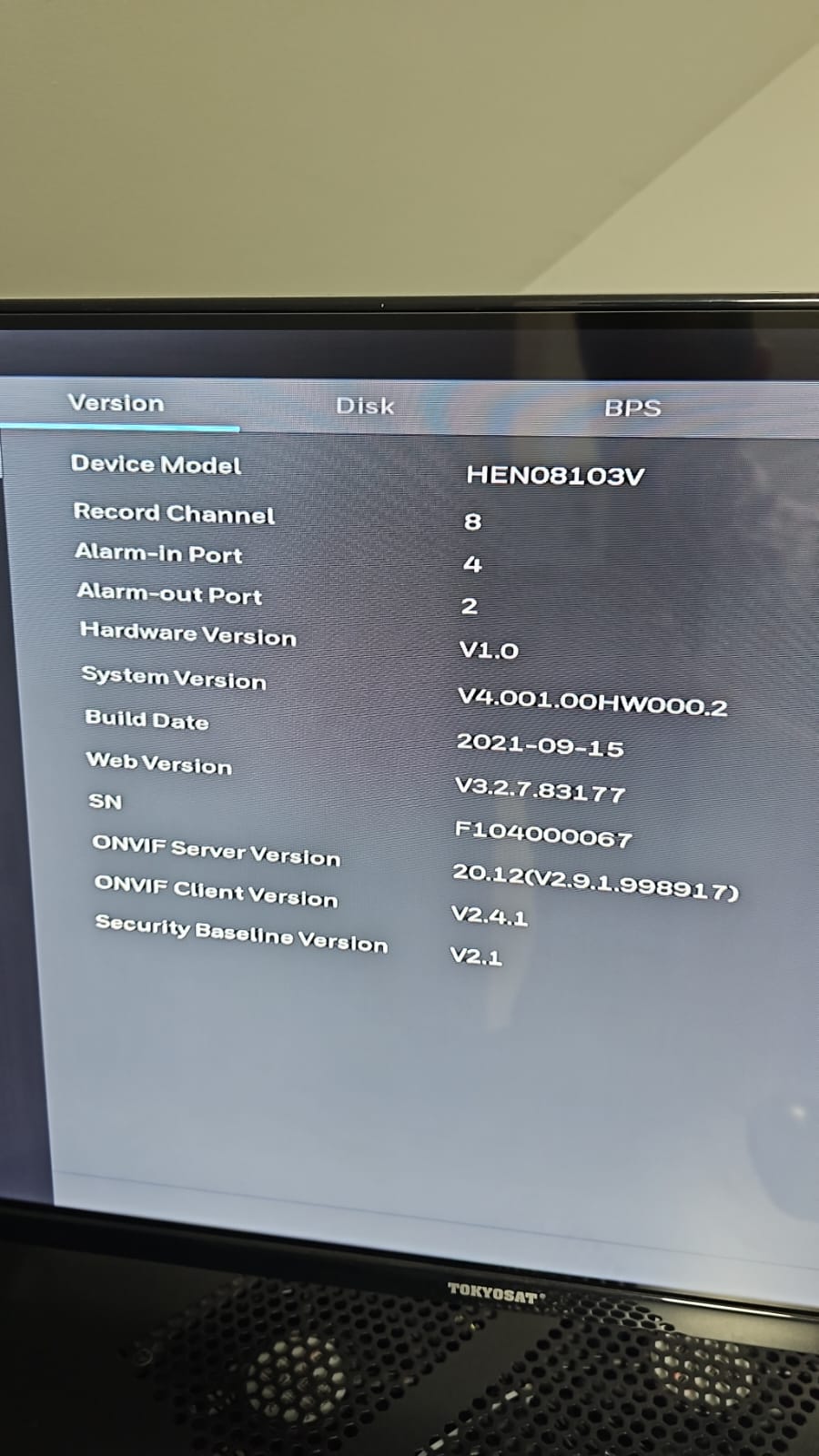

Hi All,
For Honeywell CCTV system, which mobile application we can use?
I have Attached the NVR details for your reference. Anyone can help on this?
