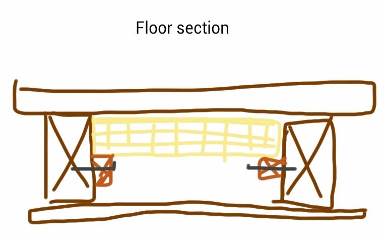

FLOOR:
• 80mm Raised piles to give air flow to base and avoid damp ingress
• 95mm frame
• 18mm WPB
• 25mm batton and celotex
• 18mm chipboard
• 5mm carpet tiles
Floor total = 241mm

Put your insulation between the roof joists - the full depth of the joists. If you want to, and add 12mm to the underside before the plasterboard to avoid pattern staining
Put floor insulation between the floor joists and the deck on top with no battens and no need for two layers of 18mm ply and chipboard. Just the joists and then 1 deck on top of them

The 80mm piles are to raise the base frame off the floor so air can pass through and to avoid damp ingress. If I don't put the base on raised piles it will be sat in/on the ground. Not sure how to overcome these issues
Thanks for the info but not sure i understand what you're saying about the floor construction - being really dumb here I know, please bear with me... I was going to build a sturdy frame that sits on the piles, then wpb, then insulation/batons followed by chipboard then carpet. Are you saying stick the insulation in the frame voids? If so how do I stop it falling out, getting wet and vermin in?
Yes no ventilation in the roof just insulation
You only need a minimum 25mm air gap beneath the floor for venting. But if you are worried, then just lower the ground beneath the floor to form a bigger void, and then keep the floor just above ground level
Or build the floor off paving slabs
Insulation can be held in with nails, battens, netting or expanding foam, and covered with polythene/membrane or 6mm ply
