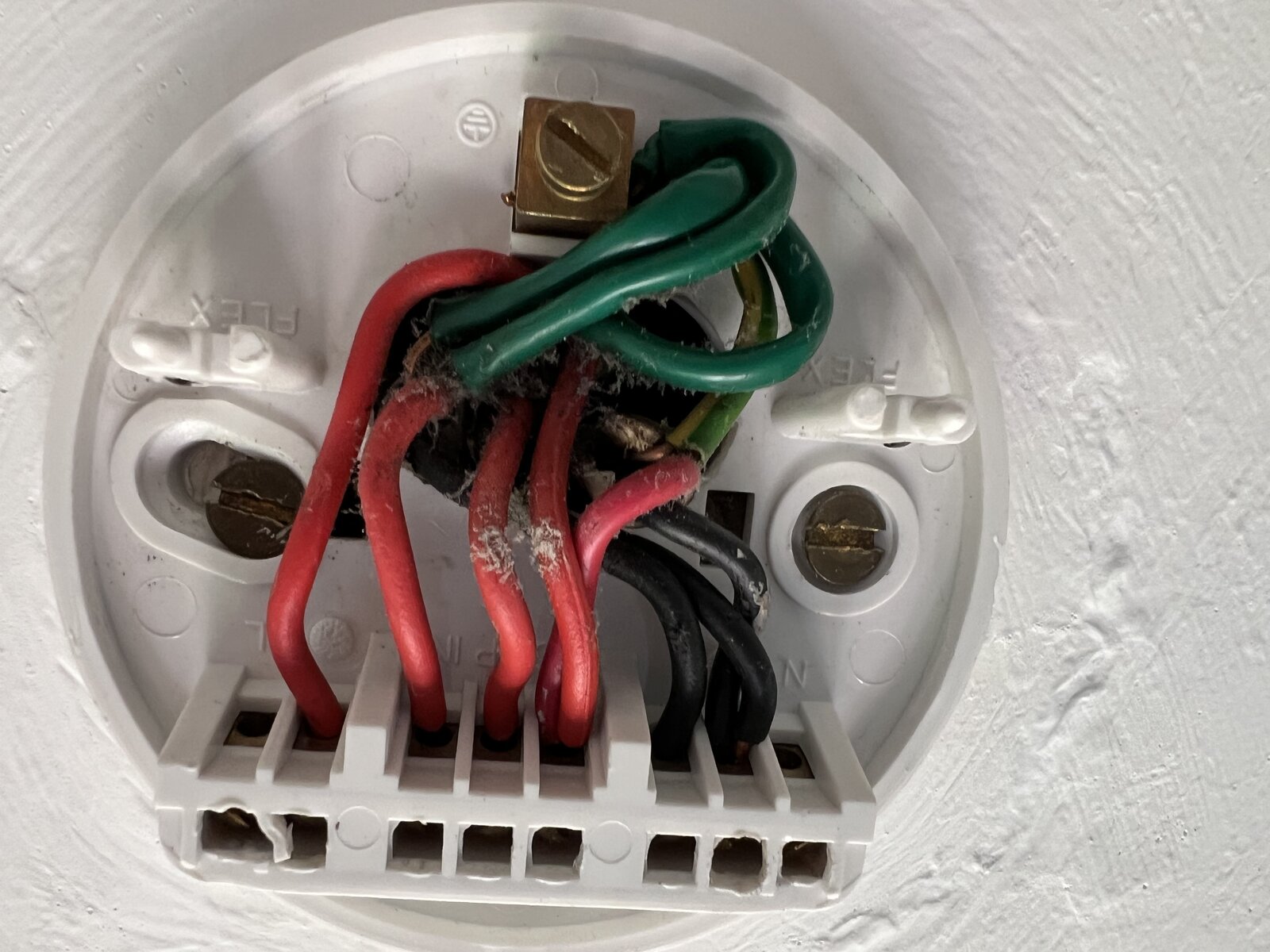

Before the decorator came in I opened up this light and discovered that it was just wired into the remains of the ceiling rose that was once there - the fitting itself was designed to fit around the ceiling rose once the cover had been removed.
The IKEA light has a simple setup of live, neutral and earth going into a terminal block (I believe it’s also called a chocolate block) so I’m going to have to remove the ceiling rose to do this.
I’m fairly confident I’ll be able to do this myself - I’ve been wiring plugs since I was 10 years old and I have done things like replace light switches and sockets. I also found a YouTube video where an electrician went through the process step by step.
In the video he talked about identifying the wires, and explained about loop in and loop out and switched live etc and then showed how to replicate the wiring in the ceiling rise using Wago connectors. I am fairly confident I will be able to do this.
I’ve attached a picture of my ceiling road setup here just for reference. I believe the single red wire on the far left of the photo is switched live. The red wires in centre will, I believe, be permanent live and run to/from other ceiling lights.

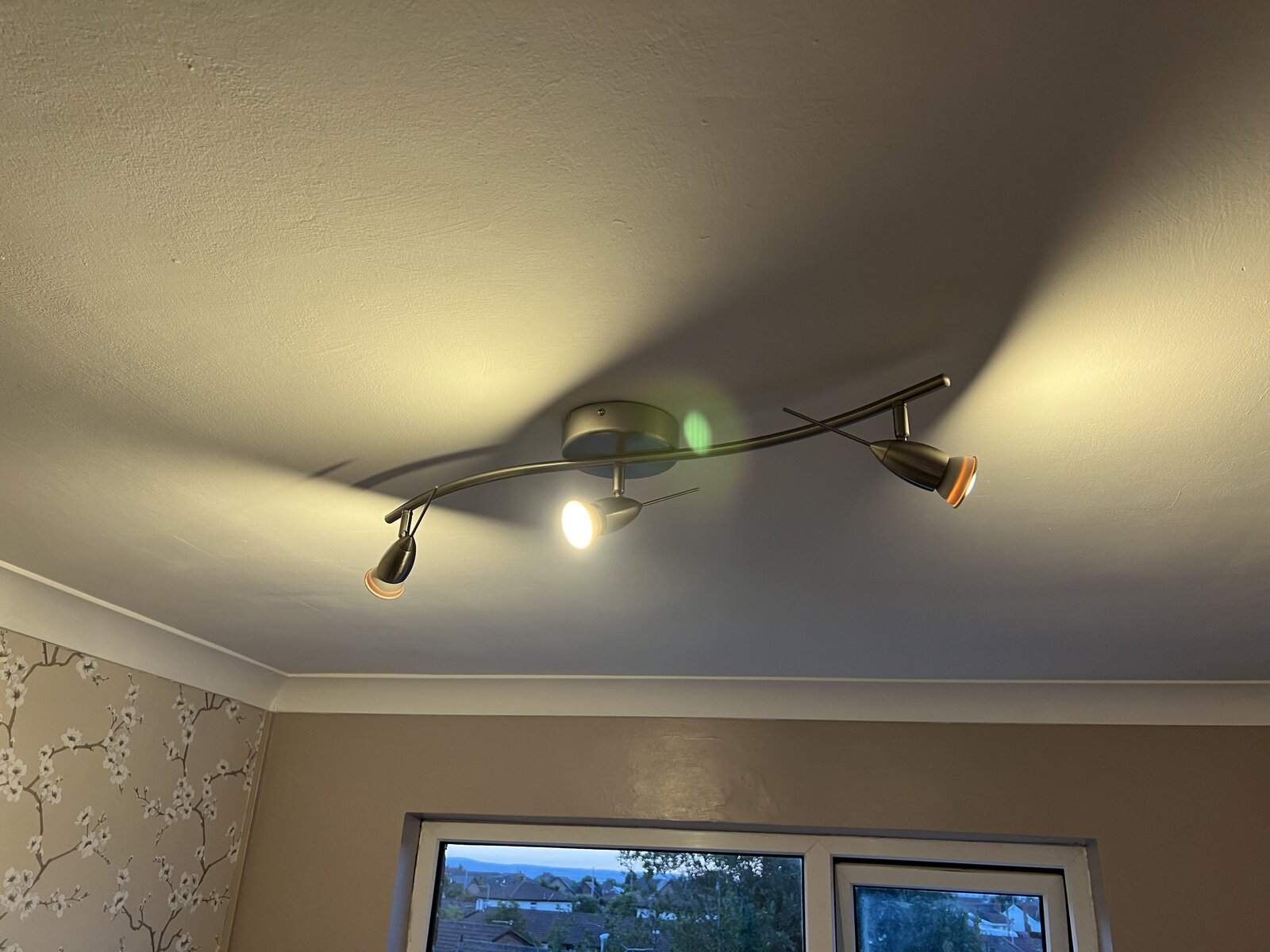

What does the new light look like? Would it hide the hole required for a junction box?
A photo of the business end of the new fitting, might also be of use.

Looks like you have an extra t&e connected there as well as the normal ones. Depending on how big a housing the new light has it might fit over the existing ceiling rose. I have been lucky in the past and done just this with the usual bit of bent metal bracket sliding under the rose and being held by the original screws!!

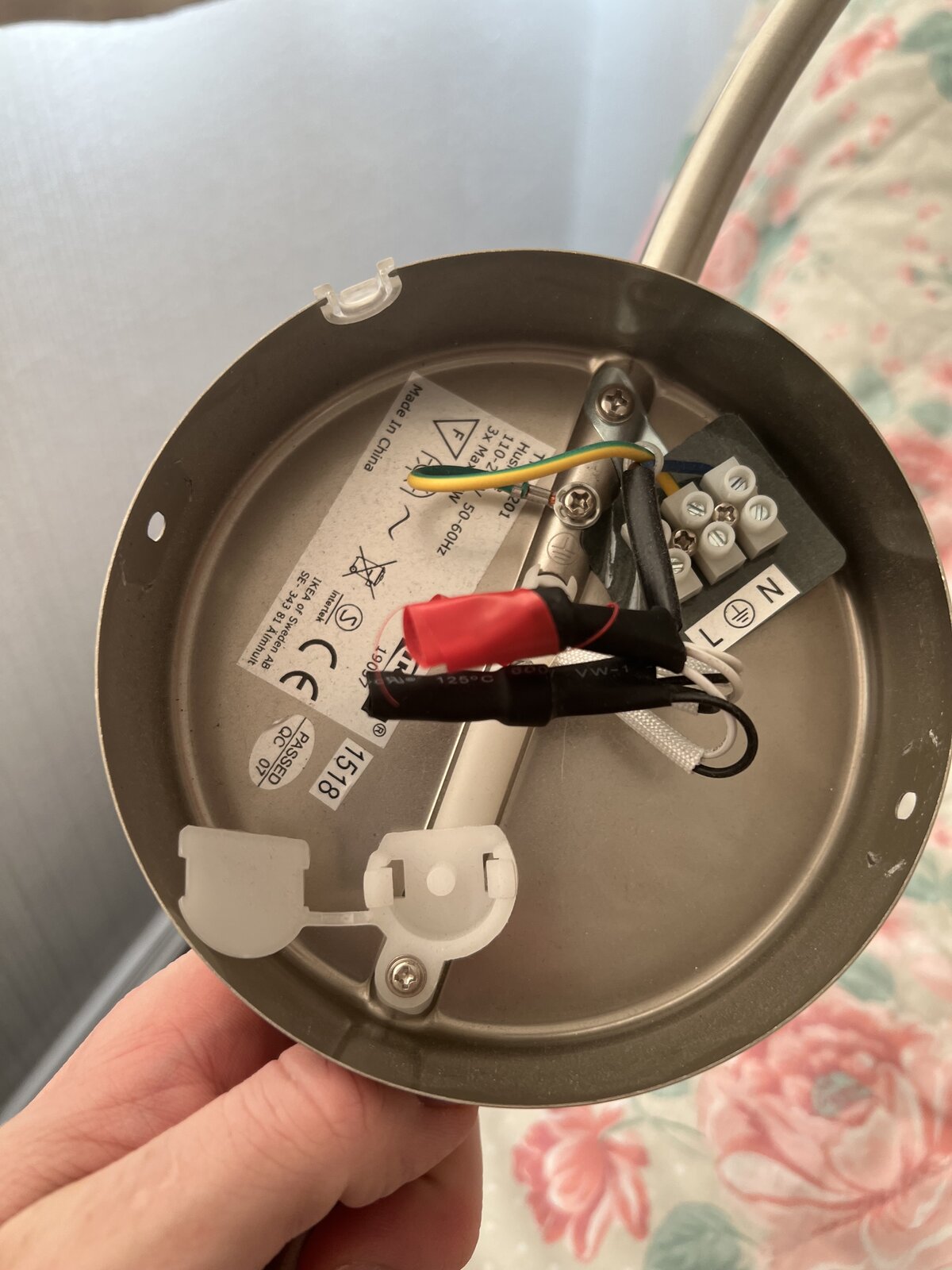

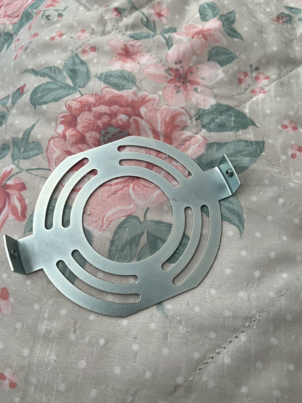

As regards what the new light looks like, see attached photos. The metal fitting is 13cm diameter and screws onto a bracket which screws into the ceiling. It might hide a hole, depending on how big the junction box is but I don’t particularly want to make holes in the ceiling if I can avoid it.

Any chance you can squeeze a strip of 4 connectors, into the fitting?
See the attached photo for the inside of new fitting. The thing is 13cm so I might be able to squeeze in some connectors if they are small enough.
Ok that’s interesting. Hadn’t considered that. The housing is 13cm diameter so it might actually work!

You will be able to fit the connections in the base of that fitting. Take the ceiling rose down, having made sure you can identify your switch live, mount the bracket and bring the cables through the middle. Make your connections in wagos and dress the cores so they sit flat on the ceiling, not stacking up on one another, strip down 6" of 3c flex to make some pig-tails and connect those into the fitting on the bench. Connect the other ends to the wagos, dress the excess length round in the base and fit the grub screws (bit of blue tack on screwdriver helps!)

If you just swap out the three 5amp connectors for a four, that may prove to be all you need. Mark the single switch wire, before you start, to avoid later confusion. Either a bit of tape, sleeving, or marker pen might be all that you need.
