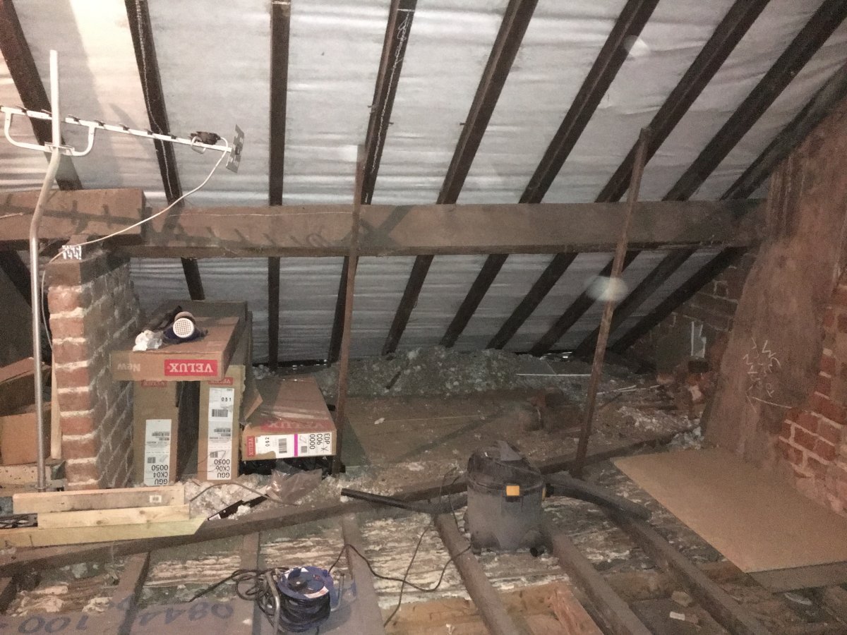

Loft conversion question ....
The designer has spec'd 3x2 rafters need to be doubled up with 75mm Celotex in-between and 75 under that with PB on top.
Trouble is that the rafters are only 400mm apart so if I double them up I will have gaps of 350mm ( which seems fiddly ) and rafters 4inch wide and 3inch deep... Won't this cause thermal bridging ?
My idea was to instead of sistering the rafters with 3x2 I thought maybe use 2x2 ( will of course check with the SE ) fixed to the underside of the rafter with a thicker ( 125mm celotex between ) and a 25mm with PB under that. The cost is about the same give or take £5 a sheet.
What are your thoughts ?

Without knowing what the rest of the roof is like, the timber sections, or the available space it's not just a case of suggesting this or that.
There are several options, but whether the specified one is better or worse that other methods is unknown.
Photo for reference ... 3x2 rafters at 400mm ctrs

Why can't you put 75mm between no air gap, and 60mm or so below?
I can't see why the rafters need to be doubled up.
From your previous posts, it seems that you can't rely on your designer or SE.
