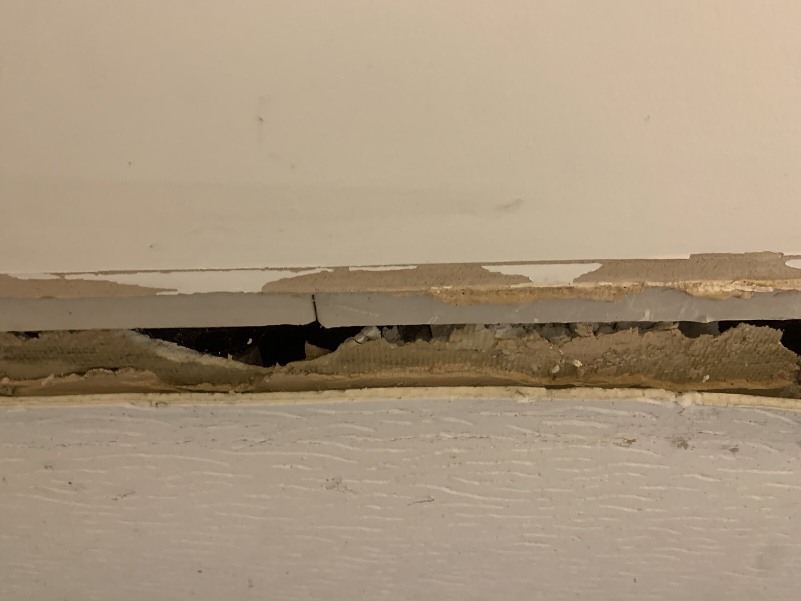

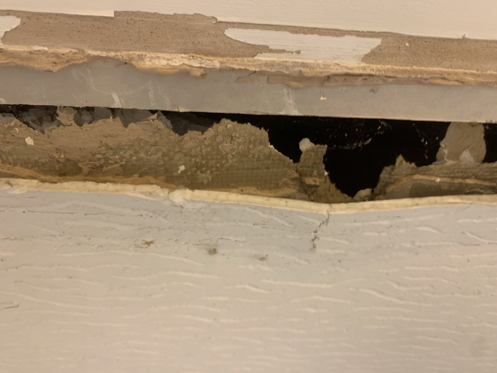

Hi,
Window fitters just took out a door for me. Guy said it might have exposed asbestos but didn’t know for sure. See pictures. This is in my ceiling basically. I don’t mean the white polystyrene, I mean the grey board in the gap which has a hex pattern on it.
This is now open in my hall. I got a 3 year old so just want to make sure I’m safe.
He said should be ok if I don’t poke it. Seems like it was already disturbed and it’s all frayed already.
As I understand this would be cement board and this would be white asbestos and it’s one of the lowest risk forms.
I was thinking of spraying with pva and letting my builder just plaster over it.
So
1. Do you think this is asbestos and is it dangerous as it is?
2. It will take a while to get it tested and dealt with. In the meantime should I spray it with water/pva?
Thanks!

Spray it with some 50/50 PVA and water.
All looks like plasterboard to me.
I thought plasterboard was white or pink.
That stuff is the middle is grey. It’s an old house perhaps that’s how PB used to look?
Soft and chalky? Paper over? That will be plasterboard as asbestos is hard.
Re colour. Could be a few types like white, pink or grey
Looks pretty chalky to me, not hard.

Go look in DIY store at the sheet materials. Find both plasterboard and cement board which is like asbestos board.
Asbestos board is a bit like your dinner plate. Hard baked clay like. Can't dig you finger nail in it.

So is it safe to grab a wee bit to feel? It LOOKS soft, look how it’s been torn up, doesn’t seem like cement.
p3 mask, wet it, and have a little poke
...I believe the 'dig your finger nail in' referred to the plasterboard and (safe) cement board at your local DIY store! :)
You can buy test kits online, usually delivered next day, and results can come in by text the day it arrives at the lab.
I've used these testers a couple of times...
....although as has been said above, it looks like plasterboard to me - spraying with a PVA/water mix won't hurt.

I’d just add; the window guy suggested asbestos not plasterboard as he said there was a hex pattern in it. Not sure if you can see on the pics but it has a mesh look to it. Presume old PB has this in it
