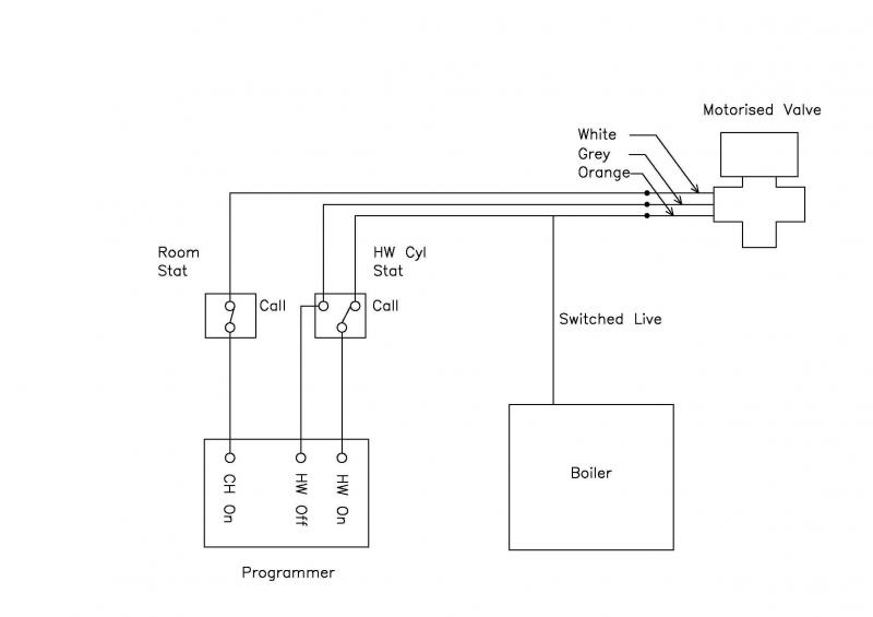

The wiring of a system with a 3 port valve is quite complicated and requires a bit of knowledge in order to troubleshoot. Sometimes there may be more than one fault. I have made a simple sketch of the switching part of the wiring below to assist. For clarity, I have omitted the main electrical supply, neutrals and earth connections, as well as the pump wiring because this can vary slightly from system to system.The basic principles are:
1. The white wire to the 3 port valve should be live whenever the heating is “ON” at the programmer and the room thermostat is also “ON” (calling for heat.)
2. The grey wire to the 3 port valve is live whenever the hot water is “OFF” either because it’s off at the programmer or the cylinder thermostat is not calling for heat. (Satisfied)
3. The orange wire to the 3 port valve is live when the central heating only is required (it’s used to switch on the boiler. When the hot water is running, this operates the boiler directly via the cylinder thermostat)
4. When the hot water cylinder thermostat is calling for heat this switches the boiler on directly.
If you are able to check the wiring you have safely, see if it corresponds to the drawing. (You will likely have to trace the connections through terminal boxes or a wiring centre) If the connections are not as shown, please say (or draw if possible) what you do have. It’s not uncommon for someone to do a DIY swap of the cylinder thermostat or programmer and connect one or more of the wires incorrectly. If you are not competent to do these checks, then the troubleshooting is probably outside of your capability and you would be best to call in a professional.
I know what you are getting at stem but your above statement can be misleading,
though correct in principal, the orange wire will always measure live whenever the boiler has a demand on it whether it is hot water or central heating if you are metering it while the orange is connected to the system
Matt
Thanks Matt, you are quite correct. My explanation wasn't very good. In practice, I always remove the orange wire from it's terminal to test it, so that it doesn't get a 'live' fed back from the cylinder stat. Because I do it automatically I guess I forgot to mention it. Thanks for pointing it out, I will try to be more concise in future.
