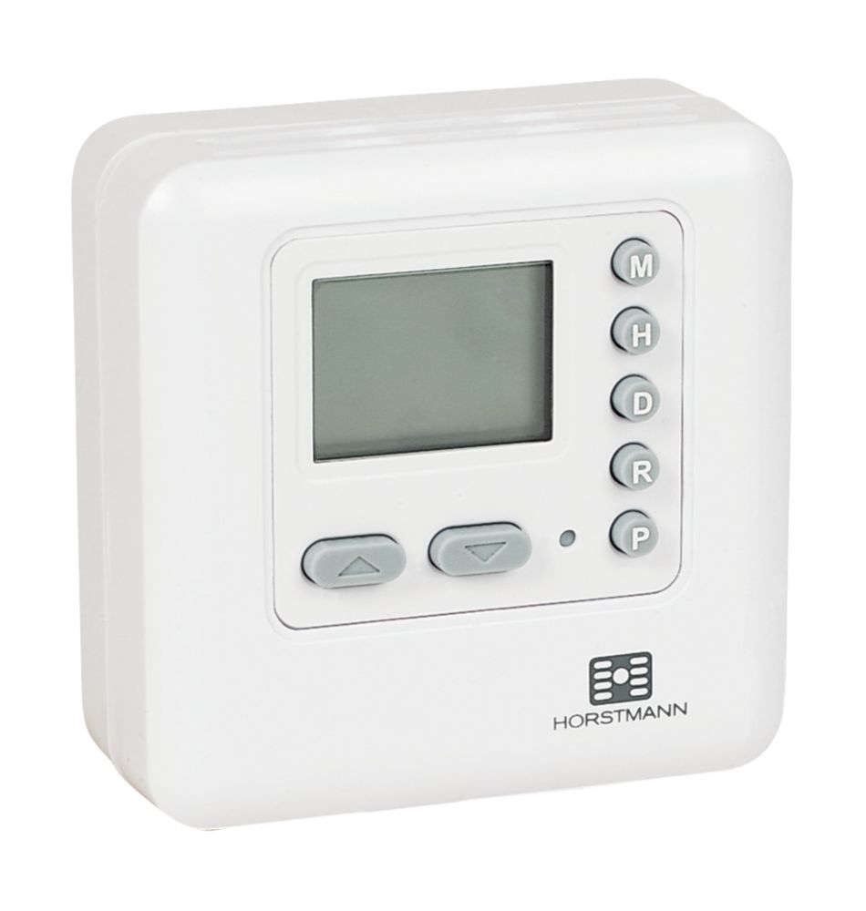

At the house the flex cable rises from underground and is wired directly into a mechanical timeclock. The timeclock is then just plugged into the ring main.
I want to relocate and renew the timeclock and hence extend this existing flex cable to the new timeclock location (via a junction box from the point where it enters the house)
