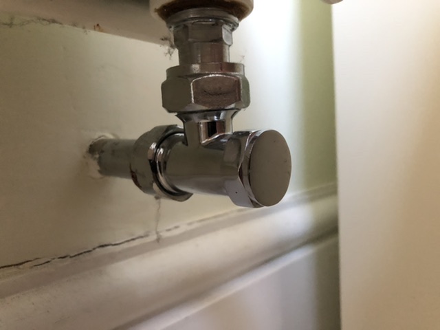

Hi - I need to drain my central heating to replace the pump, it’s an open vented system, but as the gate valves are also corroded it’s a full system drain first.
I do not have a drain valve that I can find but I do have a downstairs radiator, by a door, that has this - if I undid this bolt and attached a hose would this suffice to drain down the radiators?

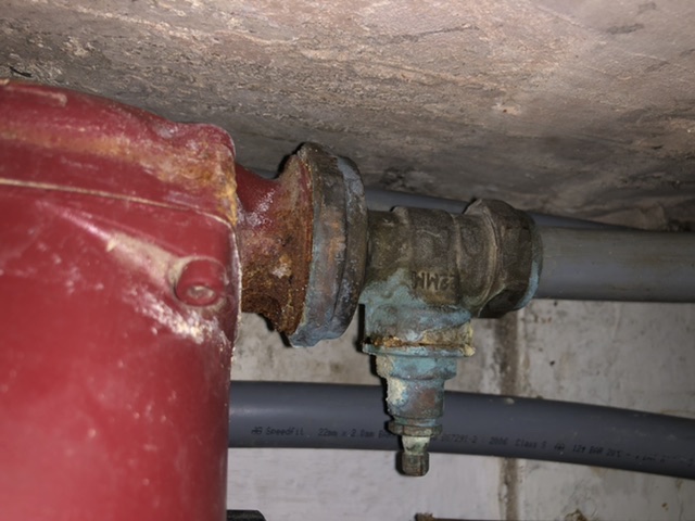

and the reason to drain down is to replace this
Cheers

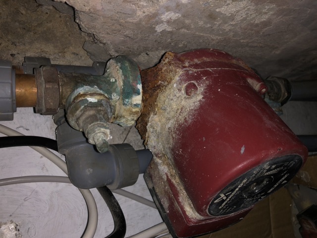

That crud on your pump is because there is a leak above it, its not the pump that is leaking post a pic showing the isolation valve above the pump

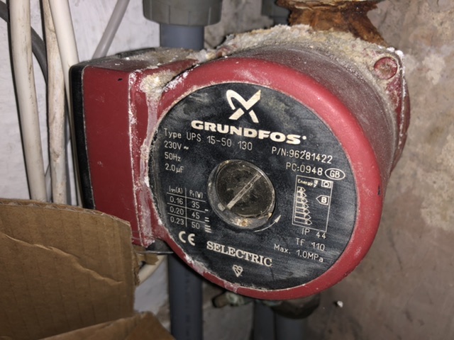

Ok when I get home I will. The main reason I want to replace the pump is that I don’t think it’s working correctly or consistently moving enough water.
sometimes the heating works perfectly and others some of the radiators take an age to get hot. No amount of bleeding or balancing helps and when the uneven heating happens the pump seems to be making more noise. It’s always the radiators in the loft that are effected and so I thought it was a circulation issue.
It’s a 3 storey house with 12 radiators, I was thinking about a pump with a 6 meter head may help?
But you have isolation valves above and below the pump, you close these to swap the pump over , no draining of anything required , but in your pic it looks like the one above the pump is leaking but cant see enough of it to be sure

no on an open vented system just use a bung kit and swap the valves then the pump , no need to drain it

here are a couple of pics of the valves that also need replacing. As I said sometimes it gets noisy and others it just seems to lack efficient circulation hence me wanting to swap it out and see where I am at.
