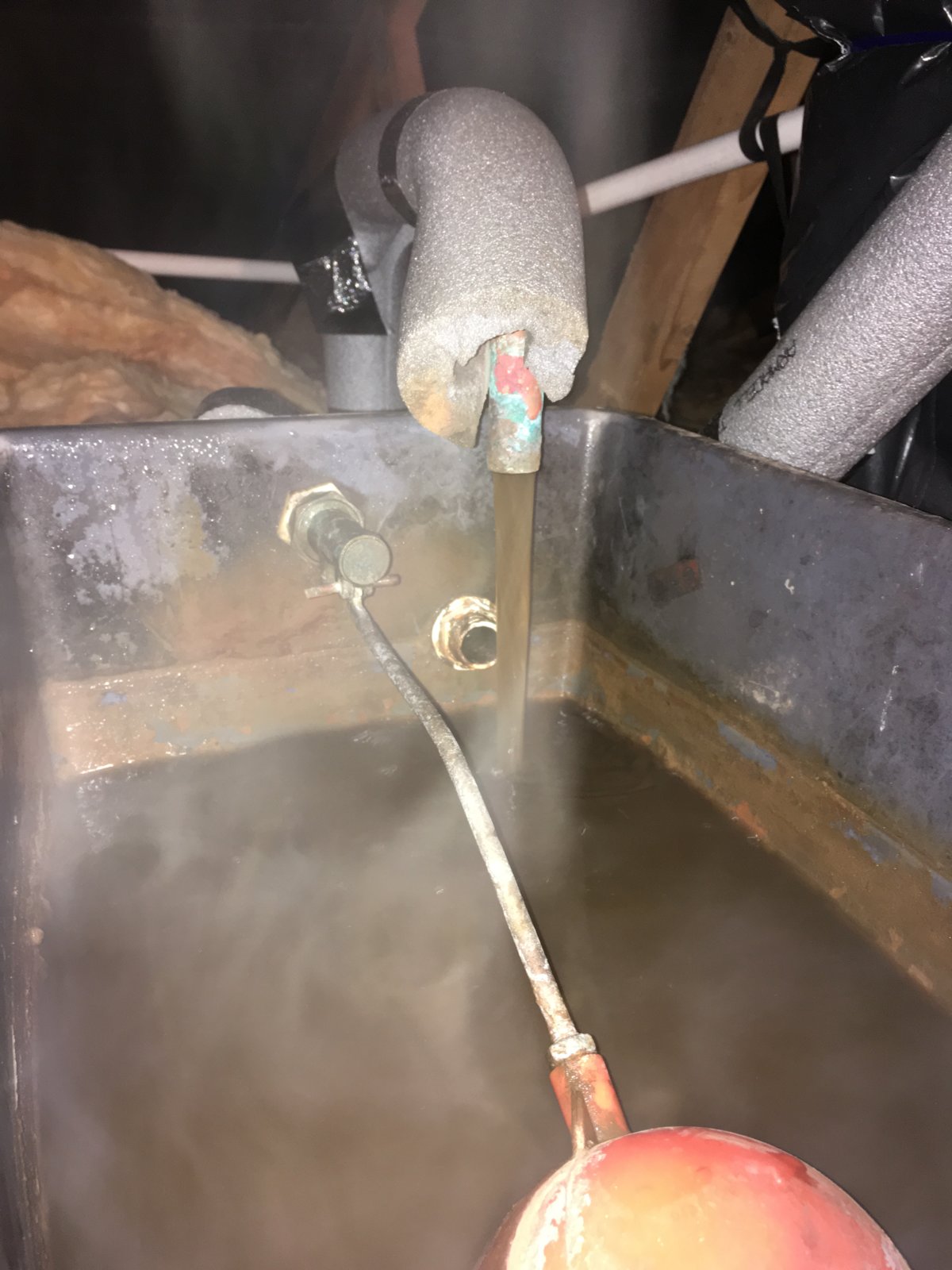

Although the vent is pouring quite heavily into the tank, it’s not filling up fast, after a few hours it will gush out the overflow for about 1-2 minutes (potentially scalding someone below)

There’s the tank pouring.

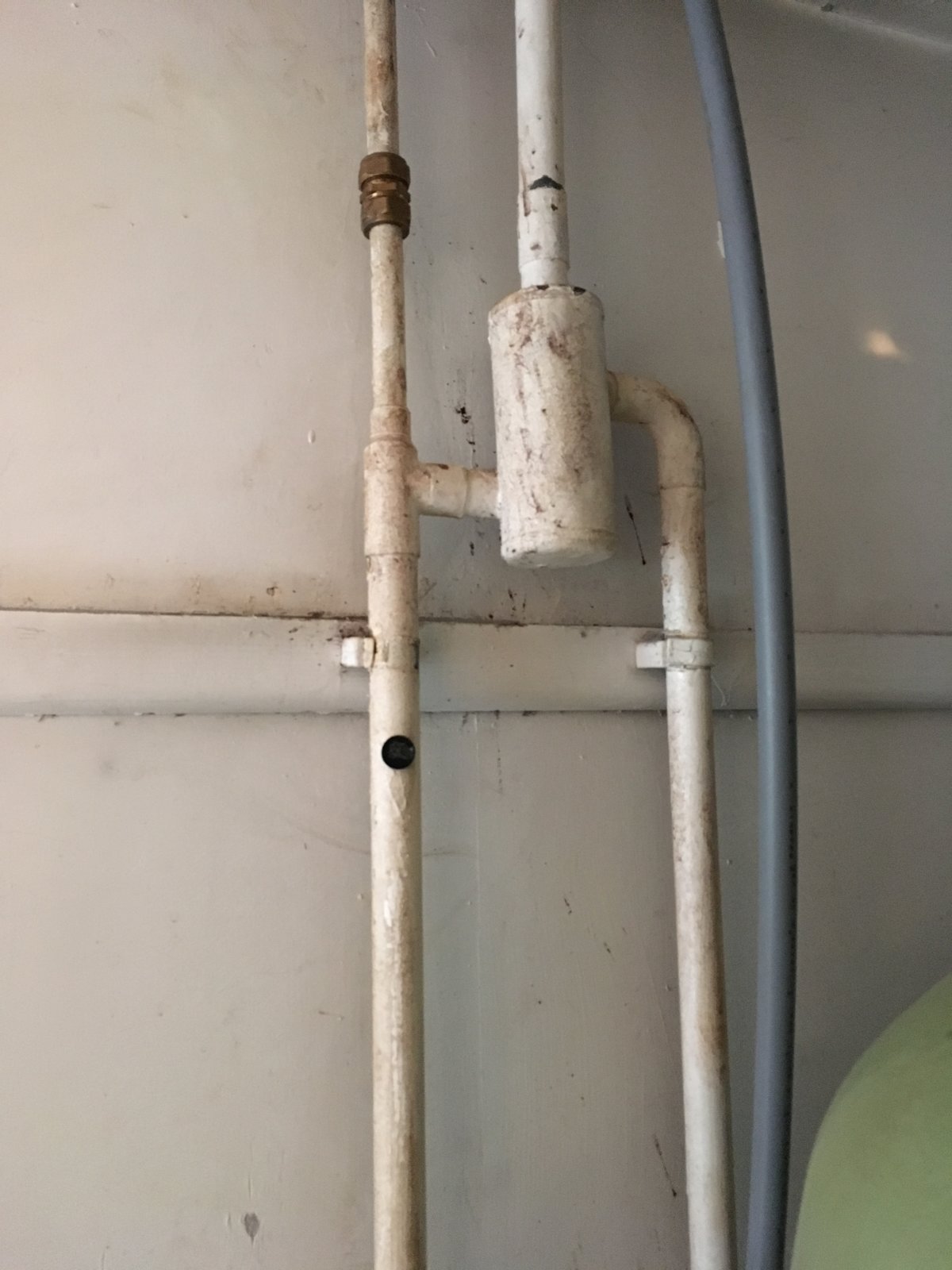

The little black spot is the magnet. It’s sticks for about 6 inches (3 above, 3 below)
I take it that’s a blockage and most likely the cause?
The water level is below the overflow there. Not clear why it should rise to the overflow, unless it's thermal expansion, and refilling via the ball valve when the level falls on cooling. But at least it doesn't look like an inward leak. I don't much like the colour of the water!
I'd have expected restriction in the short piece of horizontal pipe to cause your symptoms. Maybe there's something there but not magnetic.

If the X400 doesn't cure it, you might consider removing things and rodding out physically. You could cut the three 22mm pipes and spring the pipes or trap horizontally to get it out. Good idea to refit using compression fittings for future maintenance, but you would need a bit of upward play in the 15mm cold feed, or disconnect at the F/E tank, to reassemble it. There will be plenty of upward play in the open vent.
You have a blockage where the magnet sticks. Your plumber should of check with a magnet.
