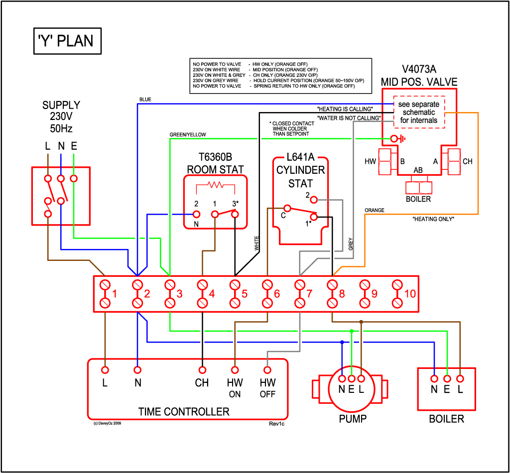

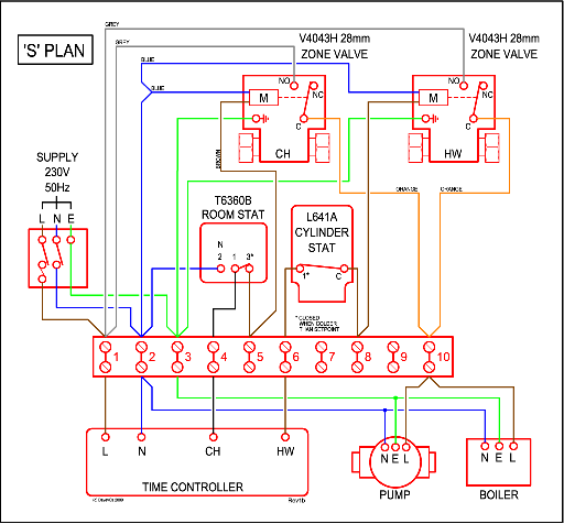

Normally, I think a cylinder stat in S system has only one set of contacts with live to the common C and 1 to the boiler and/or zone valve, you could use a cylinder stat with two sets of contacts like used in a Y system where you have C, 1 and 2, terminal 2, C & 1 should be used so that the 1 opens when the stat is satisfied, if C & 2 are used then 2 will close when the stat is satisfied, but couldn't work in a heating application?.

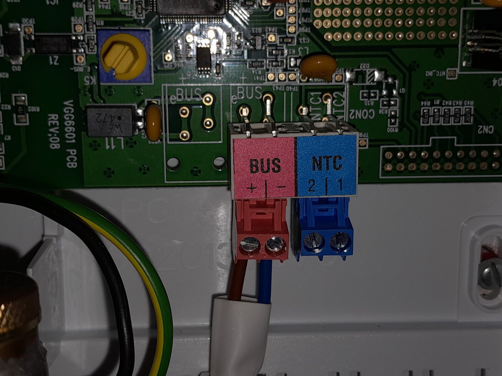

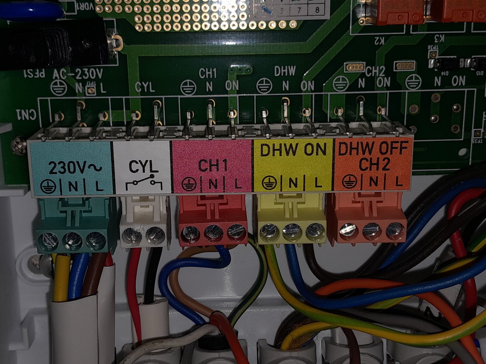

The VR66 Controller has direct connections for the thermostat, central heating pump, DHW zone valve E Bus and the central heating zone valve. I have attached a couple of photos of the controller wiring. This appears to suggest the controller is managing the switching without the use of the zone valve microswitch interlocks (please correct me if I am wrong)
I also have to make a few corrections from my previous text. Upon further investigation I realised the zone valve microswitches did not make when I opened the valves manually but they did switch state when the zone valves were energised. I also ohmed the microswitches in both zone valves and both are working properly. Also the zone valve motors are working properly.
Currently, none of the zone valve microswitch wires are connected (e.g. white, orange and gray wires are not connected) all switching occurs through the VR66 controller.
