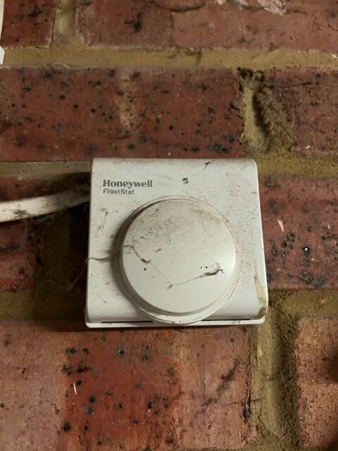

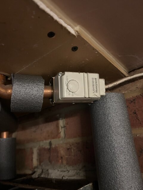

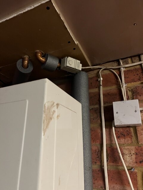

Looks like these two are sold together as a frost protection kit. I think these were added years ago when the boiler was moved outside into the garage.
Seems to have been doing it's job lately!
View attachment 289227View attachment 289228
Fairly standard setup.
The frost stat fires up the system when the temperature it is exposed to falls below about 5 deg C. However, since that space is unheated, running the boiler will never warm the space up so the frost stat wont be satisfied until the spring! The answer is to fit a pipe stat to the boiler return.... once the boiler has got the system water warm, the pipe stat opens & shuts things down again.
