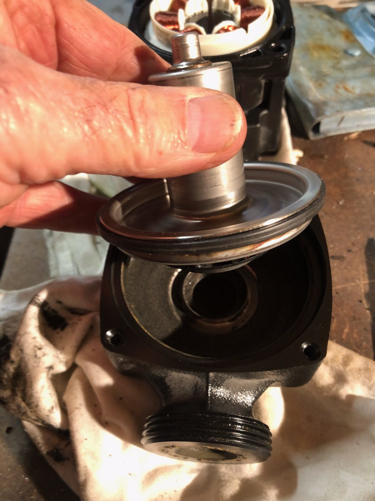

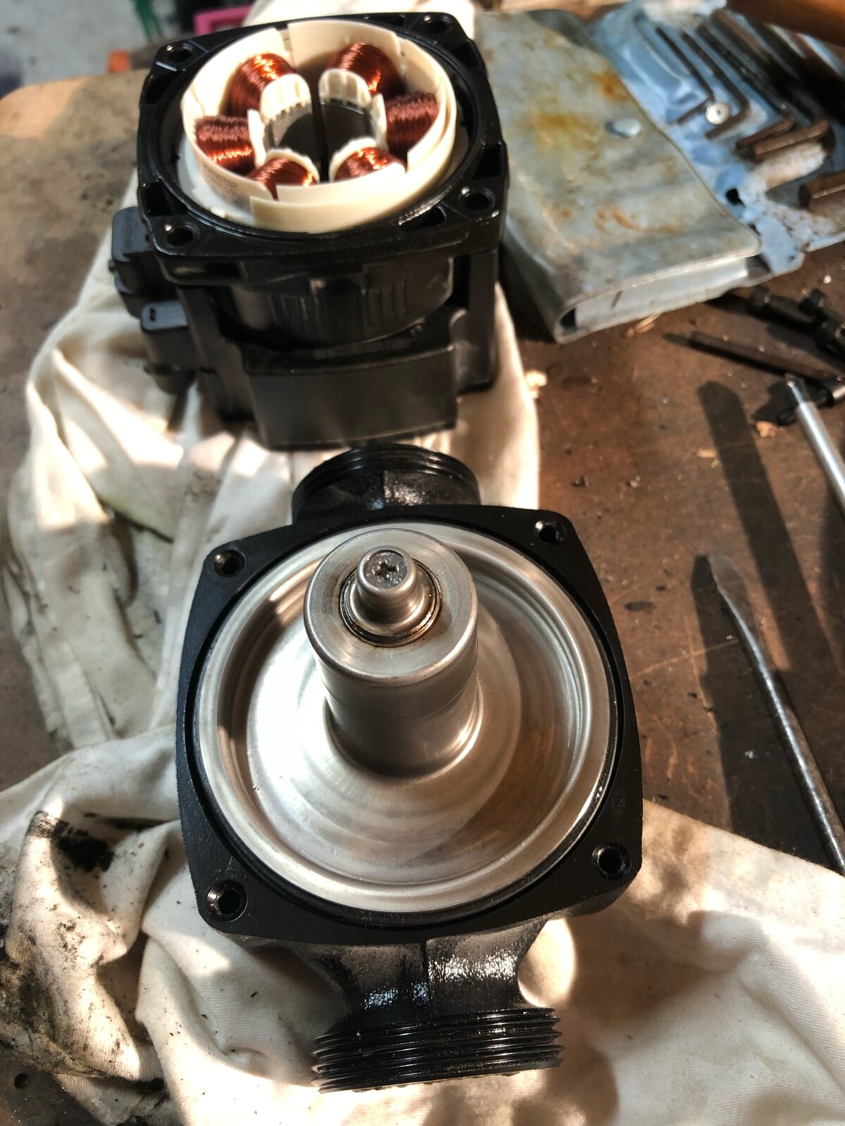

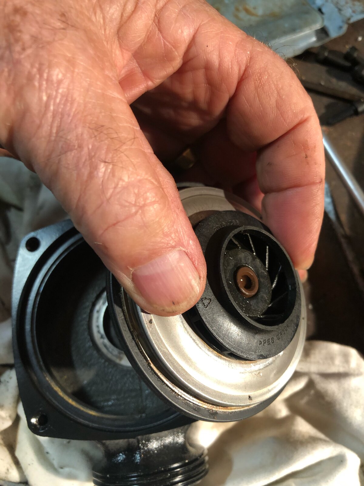

For Sussexman and anyone following this thread this is what I did to solve the issue:
- I removed the pump completely (plenty of YouTube videos on this procedure)
- Opened the pump (4 Allen bolts)
- Removed the impeller unit (pops out with a screwdriver pushed into the hole in the face of the housing - or, if it’s attached to the back of the housing as Sussexman mentioned, just pull it off by hand. (See pic).
- Found the impeller completely stuck - not turning at all despite pushing and turning the screw as recommended in Grundfos clearing blockages guidelines.
- Gently freed the impeller with mole grips taking care not to damage any part of it.
- Turned impeller by hand until it was spinning freely
- Pushed and turned the blockage releasing screw several times checking the impeller was lifting (~5mm) and turning
- Cleaned the unit and ports with dry cloth and reassembled
- Refitted the pump and electrical connection.
- Switched on - all working again!
Observations:
It appears it’s fairly common for these pumps to have ‘blocked’ impellers if they are off for a length of time eg summer. The recommended unblocking method should have worked but in my case the impeller was essentially seized. This indicates to me that I may have further issues with this pump but, for now, it works and has saved me ~ £130.

The blocking release doesn't seem very effective?, it mustn't be lifting the impeller if its stuck.
Was the impeller as clean as it looks in photo 3?.
Hi Johnthe05.
Whilst operating the blockage release screw with the pump in situ it seemed to be fine. It was pushing in and turning giving me the impression the impeller was turning. However, switching on again just gave the same ‘blockage’ alarm. Also, there was no hot water being pumped confirming the impeller wasn’t spinning.
After disassembly I did find a small amount of ‘crud’ on the impeller but, even after removing the dirt, the impeller was still seized. I tried pushing the screw but the lifting of the impeller was imperceptible. Also, the screw turned but the impeller didn’t. That I cannot fathom out as they are both at opposite ends of the same shaft so should turn together.
After freeing the impeller, pushing the screw did lift it the required 5mm and it turned when the screw was turned.
I suspect that moisture or dirt (or both) penetrated the bearing behind the impeller enough to cause it to seize hence my opinion that this issue will recur next summer (if the pump lasts that long!)
