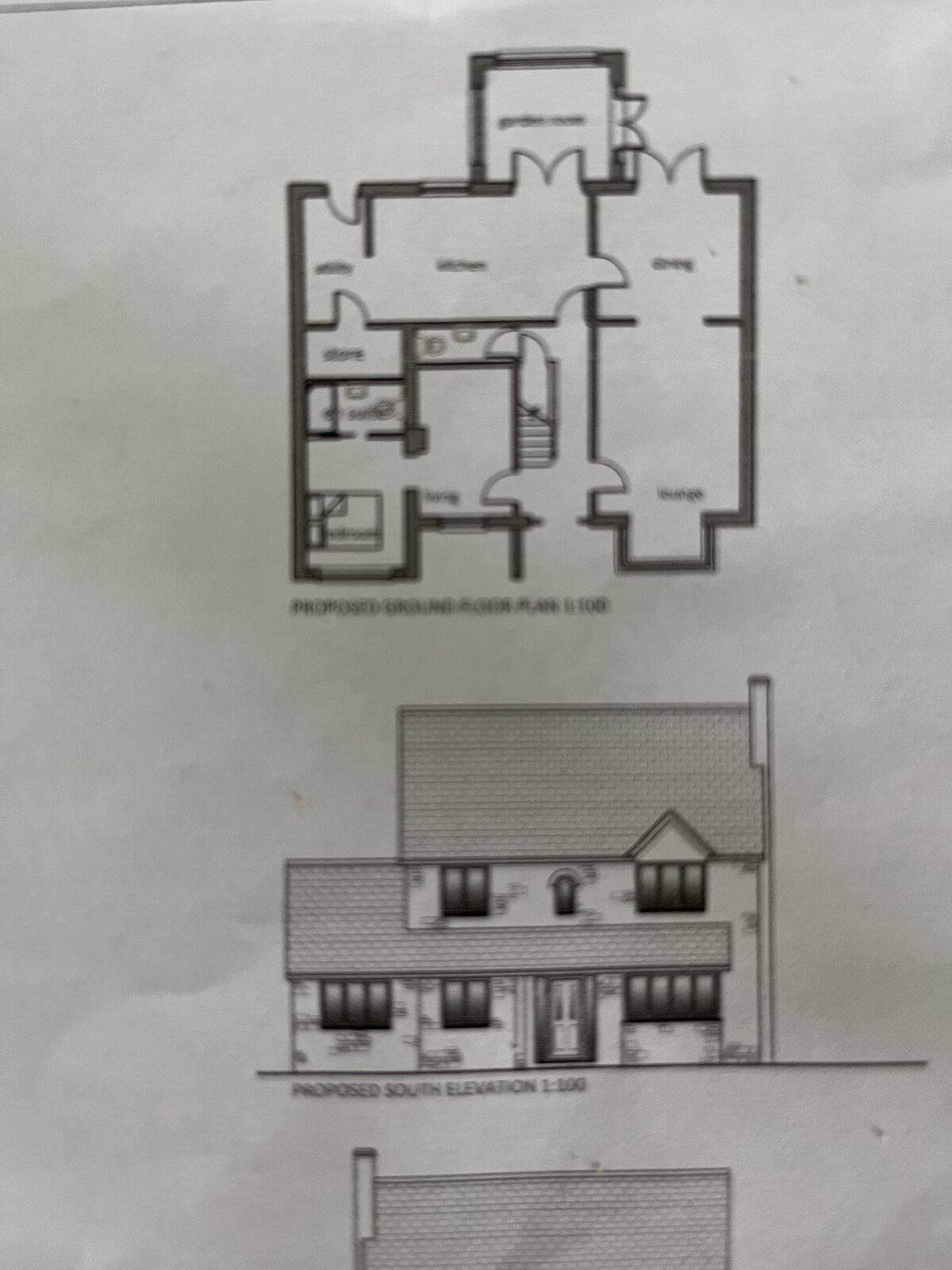

Good morning, I wondered if anyone can help me? We have got planning permission for a garage conversion (permitted development rights were removed when estate built so had to apply). In the planning application we put a three pane window in the design. We are now hoping to change it to a two pane window. Are we able to do this or wd we have to reapply for the planning permission?

Have attached a photo of the drawing the architect did if that helps.

It will be a smaller. Will be the same size as the window in the office instead of slightly bigger as in the drawing
Personally I think matching is more aesthetically pleasing, the council “could” decide that you need more light? But I doubt it
Yes I agree. I think it was because it is an inner room so the architect said it needed to be an Egress window. The builder has said we can use a window the same size as the office and put special hinges on it so it cd be escaped from if needed.
When I looked at the plans today I realised that the window was bigger in the drawings sent for planning permission. It wd be better being smaller as we cd then fit more bedroom furniture in it.
It’s a non material amendment so would’ve thought it needs a variation, which I believe means submitting new drawings and another public consultation period of 4 weeks min.
personally I’d just go ahead and fit a different window.
Planning are only concerned with the visual appearance. Not how much light you get, not whether it's an escape window
The permission seems to be for "a window" and a smaller window of the same overall design will not alter the look of the house to any significant degree so would be covered by the permission

Just crack on Becky. First risk is whether the LPA knock on your door? The risk of that is vanishingly small. If they did actually knock on your door - what then? It will be one of two things; they'll either do nothing or they will ask you to resubmit. Second risk, if they did ask you to re-submit, is there a chance they might not approve the resubmitted plan? There is no chance of that so the risk is also nil. Neither of these will happen for a minor alteration to a non-critical window and worst case is you resubmit if they do kick up a fuss, which they won't.
I submitted plans for extensions, some windows on the plan were not fitted, some were moved from original position or redesigned completely, not a problem .
