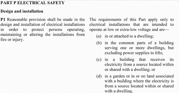

Part P, BTW, is a Building Regulation, nothing to do with being registered, and all electrical work whether done by registered electricians, unregistered electricians, bathroom fitters or DIYers has to comply with it, no matter where in the house it is done.
Everyone who does electrics must work to Part P, which states:
What you are talking about is notification to the Local Authority of work in Bathrooms, etc.

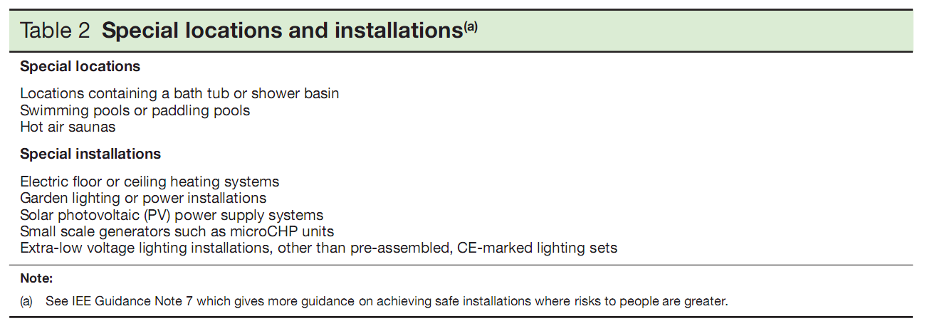

Actually, I think that in Wales they might still use the old definition of "special location", which is simply "Locations containing a bath tub or shower basin".
And I think they may still get agitated about "Extra-low voltage lighting installations, other than pre-assembled, CE-marked lighting sets".

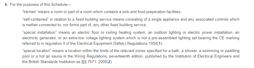

Wales still uses the same notification rules that applied to both England and Wales prior to April 2013, which say ...
“special location” means a location within the limits of the relevant zones specified for a bath, a shower,a swimming or paddling pool or a hot air sauna in the Wiring Regulations, sixteenth edition, published by the Institution of Electrical Engineers and the British Standards Institution as BS 7671: 2001 and incorporating amendments 1 and 2. "

AFAICT, this is what was in the 2006 edition:
Schedule 4 - Still applicable in Wales.
Why are you quoting ADP?
Isn't that the definition from BS7671 which is different than The Building Regulations.
Wales did not change in 2013.

Schedule 4 (which still applies in Wales, and which I quoted in my previous post) is still present in our wiki - so not too hard "to access".
