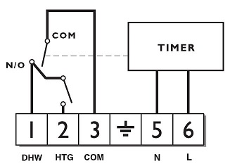

First ever post so be kind, as the title says, Randall 102 wired
1dhw, 2htg, 3com, 4earth, 5N,6L, this is looped at 3-6

The Randall 102 terminals are as below....

So the wires simply move from the Randall to terminals at the Drayton that have exactly the same function
Randall (1) DHW = Drayton (3) HW on
Randall (2) HTG = Drayton (4) CH on
Randall 5 (N) = Drayton (N)
Randal 6 (L) = Drayton (L)
No "loops" required anywhere at the Drayton. As you can see from the Drayton diagram the COM connections are made internally for you already and not brought out to an external terminal like the Randall.

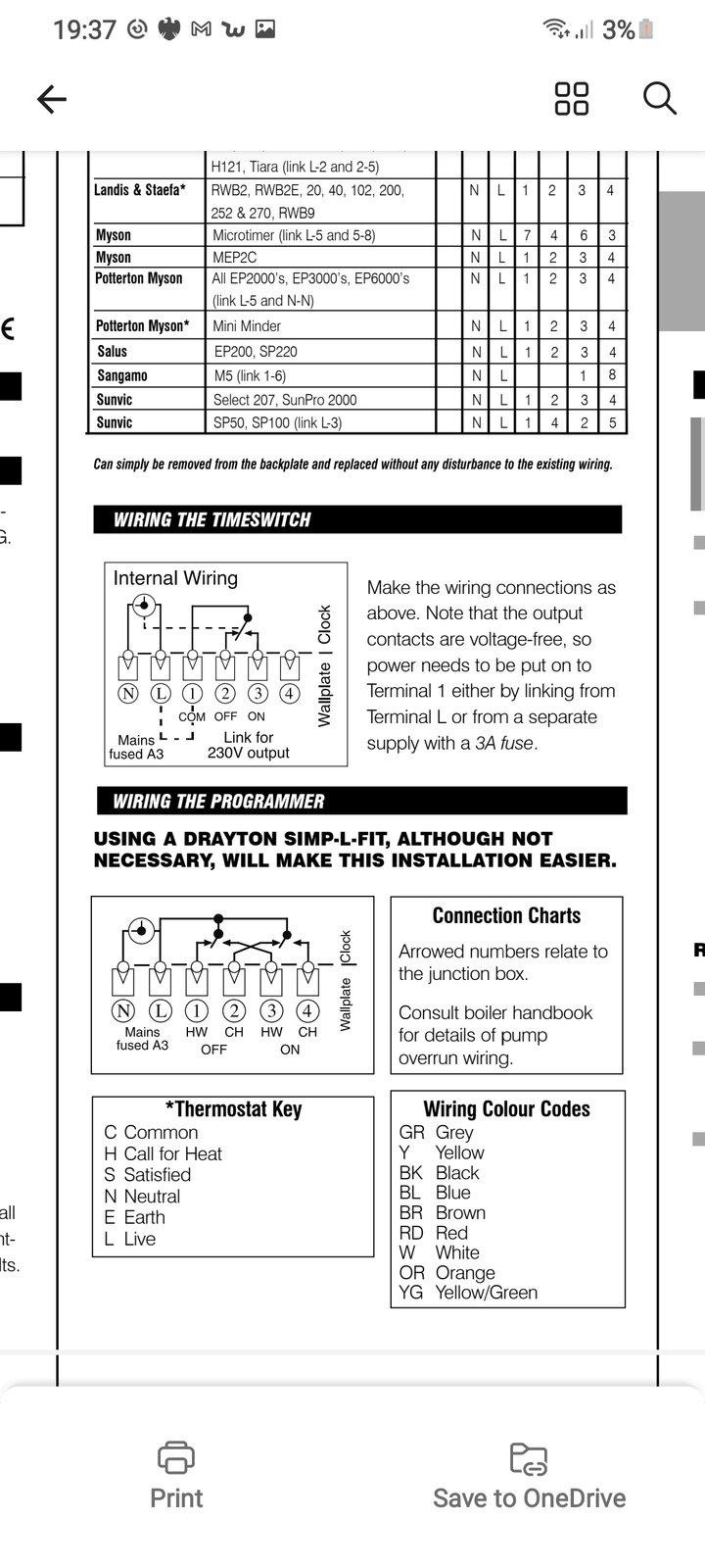

Yeah I was getting a little confused with the attached instructions, cos the 102 was a com, I assumed after reading this diagram that term 1 was a com, cheers for the reply
That diagram you have just posted is not for a Drayton 722. You said you had a Drayton 722 which is a dual channel programmer with heating and hot water control. The diagram you posed is a single channel programmer for only heating control. They are completely different beasts with different connections.

Hi thanks for your response, this is the bigger photo from my screenshot, must of been where I was getting the mistakes from
That is a standard document that covers every model of the LP programmer that Drayton manufacture. As you said that you have an LP722 which is a dual channel programmer, that should be the section you are looking at.....
