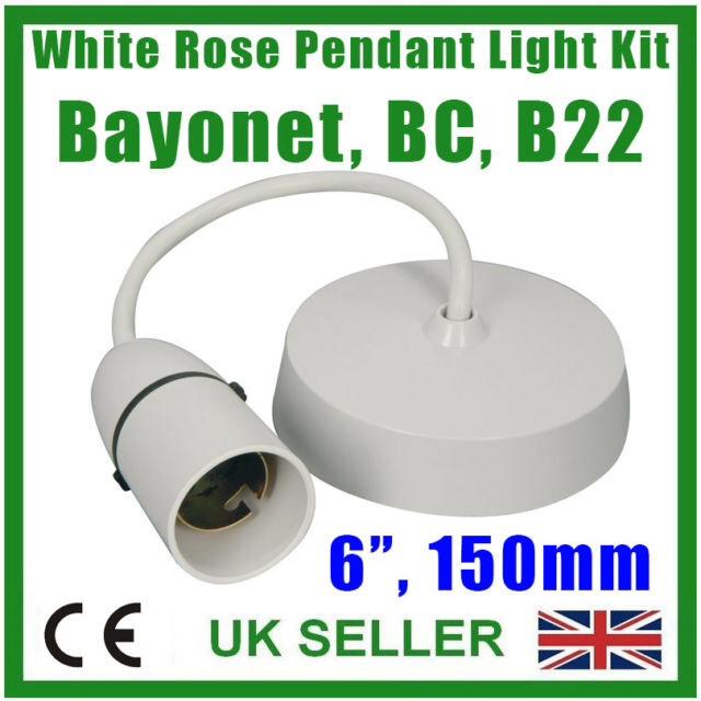

We have one bedroom that has a 3-pin bayonet fixture (the rest of the house has 2-pin).
I am looking at changing the 3-pin to a 2-pin.
I wanted to know if I can simply keep the base (already screwed into the ceiling) and simply changeover the hanging part?
It appears I can pull out the blue and brown wires; and then replace with new BC/B22 hanging socket?
Would the cover part fit the exiting base? Are these parts universal?
Current fitting:
View media item 87516
Proposed replacement:
you can replace the lamp holder and connect to flex or if you purchase lamp holder with flex connected, a straight swap to ceiling rose terminals.
