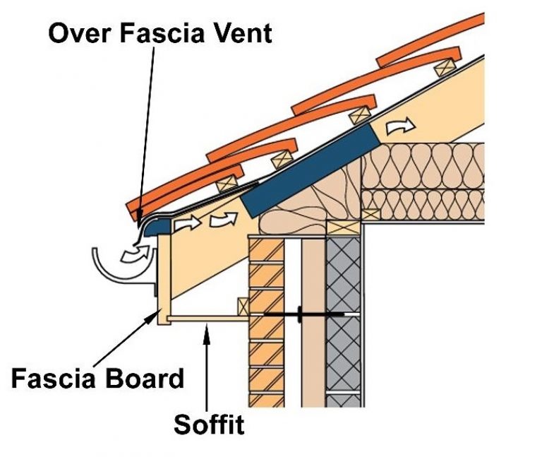

OFV! (y)
Though it could be difficult to retrofit?
And, I've still seen recommendations for ridge ventilation for good cross flow in the OP's situation :)
Over Fascia Vent
It's only difficult to retro on a slate roof. He did say he is putting vent tiles on one side.
He can achieve better flow with ofv. There's a choice of sizes

the facia vents are hard to install plus it is slate.

Regarding over facia vents
I have had a look at these vents and wondered how difficult it will be to fit them. Will i need to remove all the lower slates ?
Can you just lift the slate and fit the vents that way ?

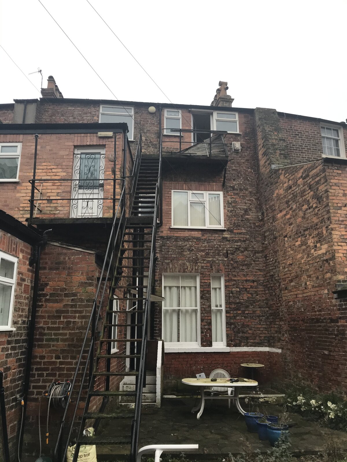

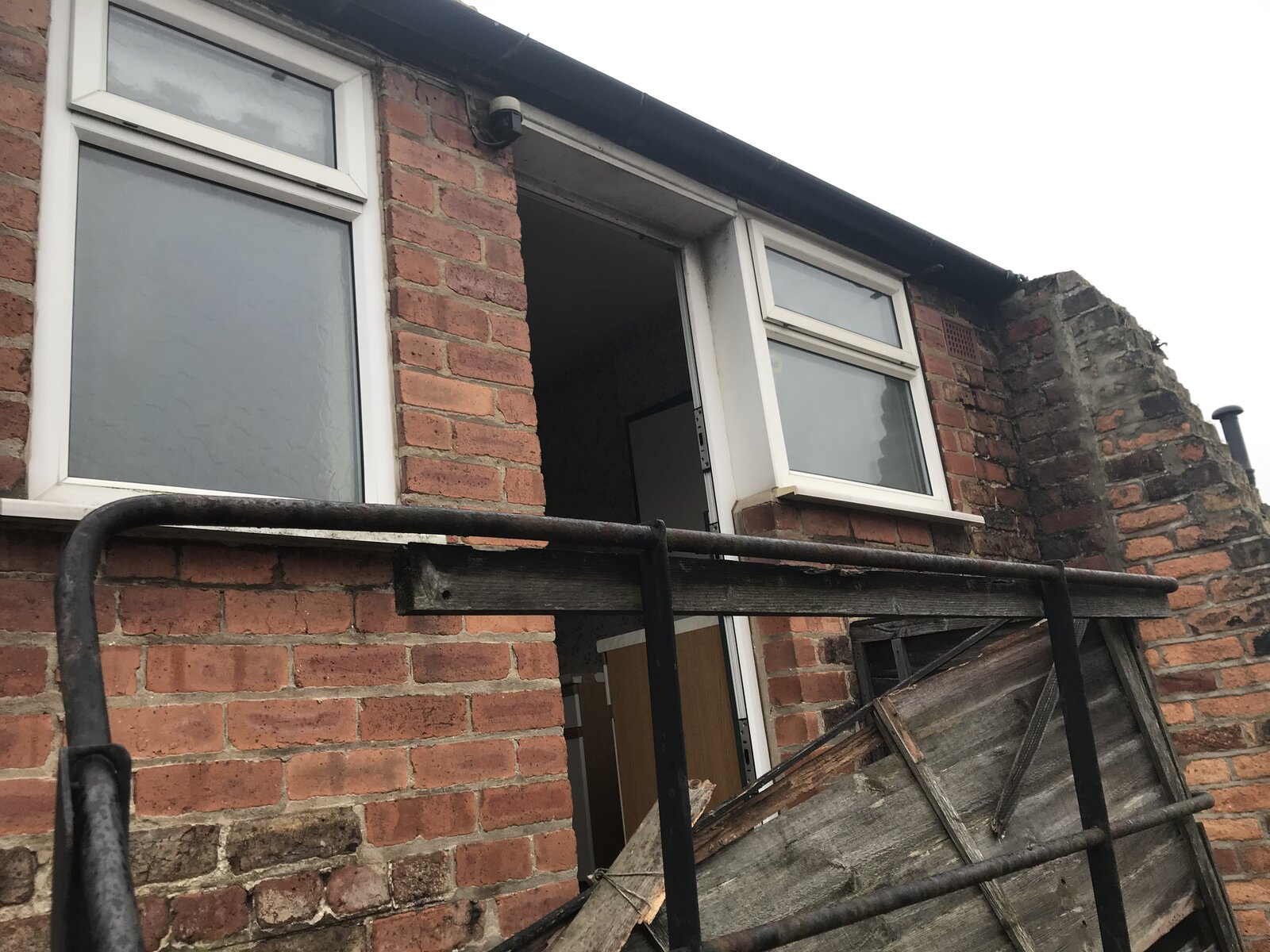

The photo shows the top flat which i am working on. Access on the left side is good as i can work off a flat roof. The middle section is harder as it is a narrow fire escape. So this would be off a small ladder. The right section will need my tower scaffolding being built to get up to this height.
