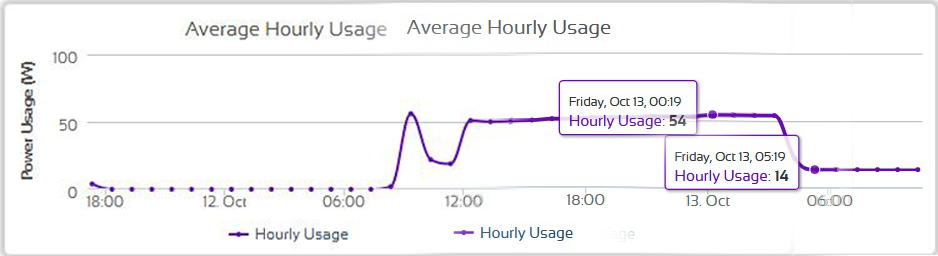

However over winter not sure if to leave in caravan or remove and use a small charger in the garage. I know what the charger in the garage is doing, measuring input I see 65W, 52W and 14W which I would think relates to 3.8A, 3A and 0.8A the fourth rate of 0.1A the battery has not been on charge for long enough for charger to drop to it.

I had intended to produce a chart showing charge rate, first peak was due to using a standard unregulated charger to raise the voltage over the threshold which causes the regulated charger to auto select 12 volt rather than 6 volt, because the battery was heavy sulphated the first 3.8 amp stage was very short, it went to 3 amp very quickly, I had intended to use Photoshop to extend the chart, and to start with it worked. However as it hit the 0.8 amp output which is 14 watt input the scale changed first to 40W and then 20W so can't really link them together.
The battery came out of the old caravan which did not have a motor mover, the place where it is parked has a 13A outlet not 16A so my wife was unable to plug the caravan in as at that time only one hookup lead since then we have two leads one with 16A the other with 13A plugs on them. Since it should switch from 3A to 0.8A at 80% charge and it took 16.5 hours it would seem the battery has lost capacity and is now more like 62 Ah rather than 88 Ah and I have calculated it should have run another 15.5 hours to complete before dropping to 0.1 amp charge, however now run for some 28 hours at 0.8A which seems to point to some recovery of the battery likely due to the low charge rate.
The charger a cheap Lidi one displays voltage it shows 13.7 at this point, the chart with the instructions seems to show at 14.4 volt it will drop to final stage with 0.1 amp charge then it will return to 0.8 amp if voltage drops to 12.8 volt. Without an energy meter drawing a graph I would not know when or if it changes stages, so this is the first time I have been able to see what a charger actually does, unfortunately it needs to be in range of the hub to record and produce a graph so don't know what the caravan charger uses.
