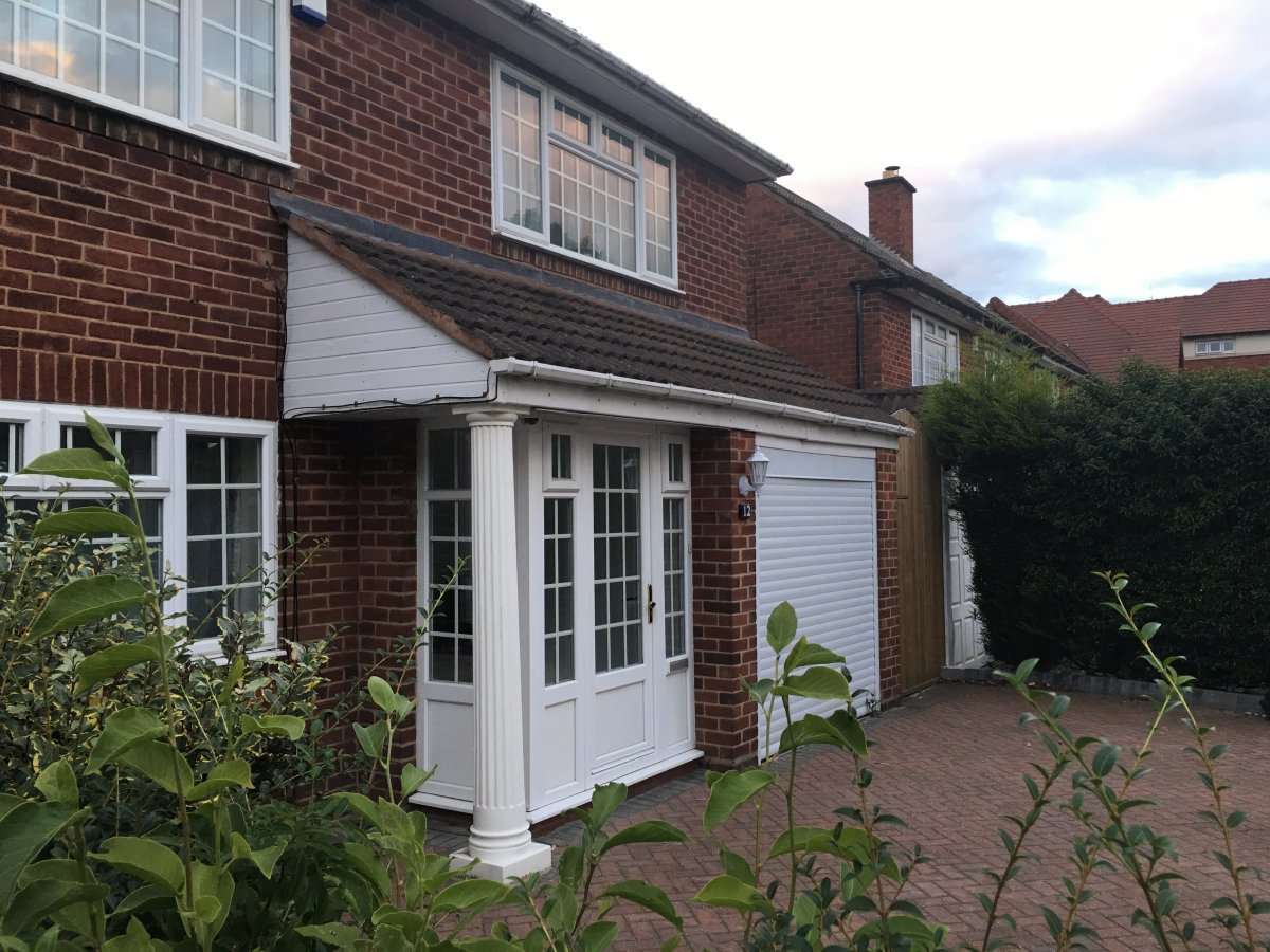

I am building a roof for my porch. The neighbour has something similar (see attached picture).
In order to get the roof please advise if I have all the correct materials and if I may have missed anything
