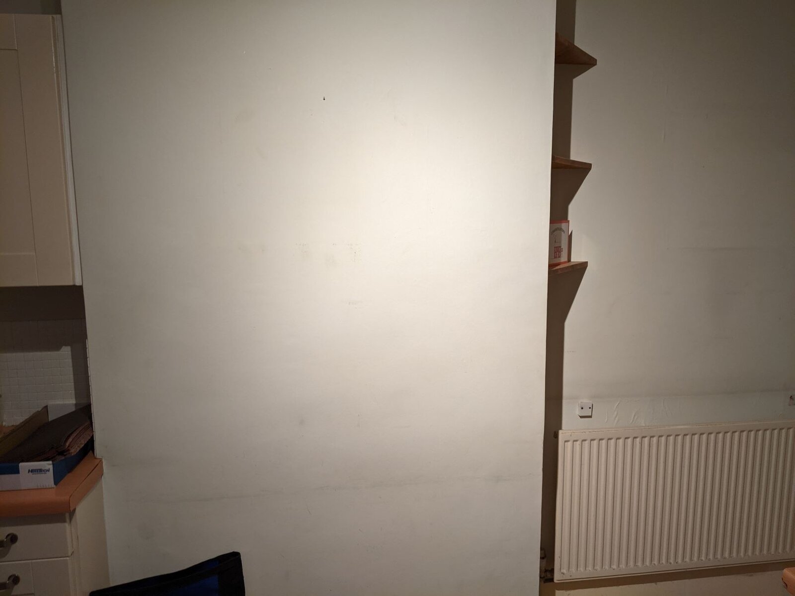

I've attached a photo of the chimney breast in the kitchen, and a rough Paint3D working out of how the hob / oven would be inserted. I've also attached a photo of a similar property on RightMove.
The chimney is on a party wall. We are on the ground floor, and there is also a flat above us. I think the flat above has covered up the fireplace.
Do I need to get a Party Wall agreement? I've read conflicting information, my gut says that we probably do but equally we are only opening up 'the front' of the chimney breast, rather than altering the wall as such?

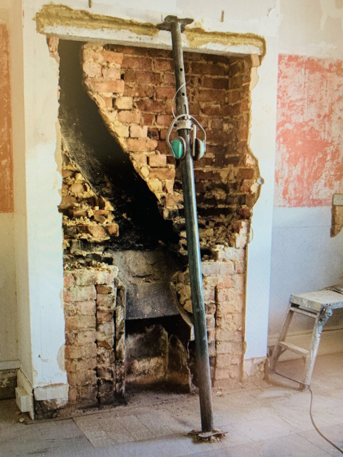

My fireplace to be opened up was just that, not originally a range, so I am concerned it will look like the below with a flue channel that will need to be removed and masonry above supported..

I think really what I need to do is take away the plaster and go from there. Lots of properties (of the same construction) have done what I would like to do so I am hopeful we can do it without too much issue.
