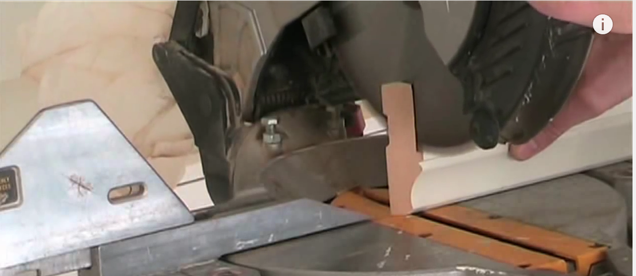

I've been checking out youtube videos on skirting corners and there seems to be a couple of options: mitre/bevel or scribe with coping saw.
When scribing with a coping saw, there is a straight cut that is required (after the bevelled cut) which needs to stop at the point the detail begins on the skirting. Hence the skirting needs to be cut upright. Would that be a limitation of the Makita LS100?
This is the cut I am referring to:
Cutting skirting upright would be a limitation on any mitre saw. There is no real need to use the saw to make that second cut. In fact I tend to make that second cut using either a jigsaw or a hand saw because I find that it's better to put a few degrees of undercut on it (as you would do with the coping saw on the top edge profile) so that I can handle out of square corners better. I find there's little difference in the amount of time it takes because I'm not having to reset the bevel angle twice in order to make the cut.
