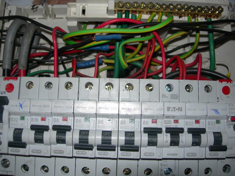

It sounds like a neutral on the CB you changed to 20A is in the wrong place. You should not have needed to move the neutral wire if you were just changing the CB.
Can you take the cover off the consumer unit and post a good quality photo on here? Use macro setting or we wont be able to see the detail.

i did change the 32 amp to a 20 amp for the conservatory but it is not working now should it be a 20 amp or should i change it back to 32 amp as it worked ok before
he means you might have connected it wrong, that's why he asked you to take the photo etc
Can you get a shot that shows the whole board at all - in particular where all the neutral wires go...
First thing to mention though is the butt crimps (the blue things) that have presumably been put in at some stage to extend some wires have been very poorly done, given bare copper is visible!
Realistically I suspect your best bet is going to be to get a proper electrician in (not homeserve as they appear to be useless from what you've said) to figure out what's going on - perhaps then send his bill to homeserve?
It appears the 20A breaker may be on the other side of the board to the 32A one it was on. Are you sure the neutral for the 20A circuit is in the correct busbar?
Or did you remove the 32A one and fit a 20 in place of it?
number 7 is the conservatory and number 8 is the house sockets, i just took the 32 amp out of number 7 and replaced it with the 20 amp
The gas man is correct about one thing though. It should not be a 32A MCB as it is a radial circuit (only on conductor in the cb).
Just to confirm, kes. When you replaced the 32A cb you only took the red wire out of the 32A one and put it into the 20A one? Pls confirm that you changed no other wires and did not change the cb's position in the board?

yes all i did was pull the clip up at the back, unscrew both screws moved the red wire took out the 32 amp put 20 amp in and put red wire in and did screws back up push clip down. Itdid work once so i though great it is ok when to use socket again no working now
