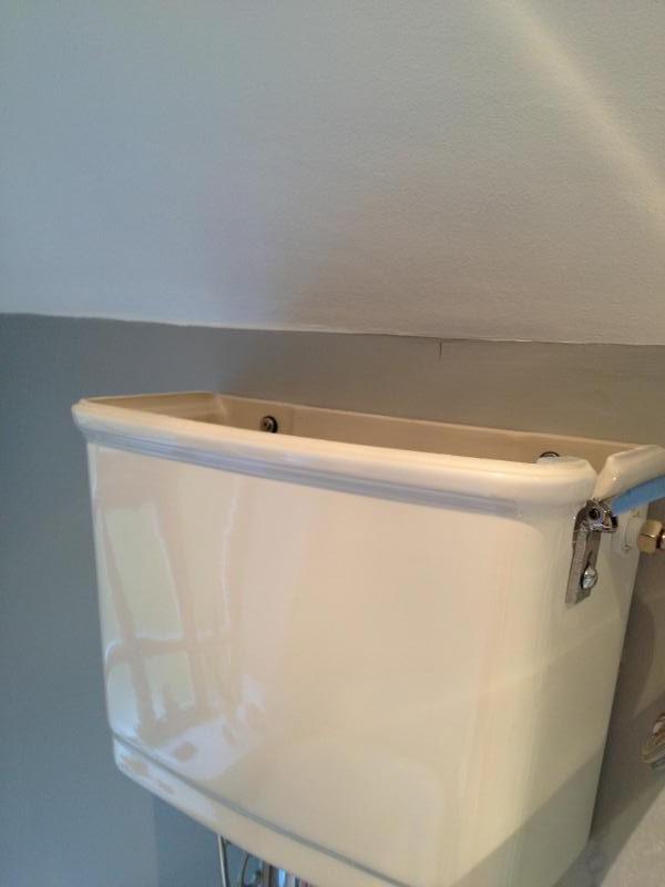

we have had a bit of a saga with a new bathroom. Our 10 day quote has not gone to over 2 months... However, i shall get to the point which is: can anyone recommend a flat lid to fit on Hadrian High Level Cistern?
Te long story is as follows... Our high level cistern was installed and when we asked for the lid to be put on it, it doesn't fit. The lid has a decorative ridge at the back and this doesn't fit as the wall behind it slopes....
The bathroom fitter has made every excuse under the sun to try and avoid responsibility for the measuring error they've made. And because of the shape of the room, I don't want it lowered (I don't want the contractor back, enough is enough!).

Fail to see how the existing lid can not be made to fit.
Not sure what you mean by "the wall behind it slopes".

For the sounds of it, could a little of the plaster be removed from behind the cistern lid ? When the lids fitted it wouldn't be seen and the lid would fit right. A bit of a bodge I know, but you can't make a silk purse out of a sows ear and all that.
What's the point of an upstand at the back of a HL cistern lid?
Only Dan and I would be able to see it.
Flat replacement, good luck with that. There are 1001 different sizes and models. Most manufacturers only sell complete shells nowadays.
Get a glass cutter, score between the horizontal surface and the upstand, then chip away, carefully.

I've posted a picture at //www.diynot.com/network/ahoy/albums/
The angle from the grey paint to the white is approximately 20degrees.

We don't want to lower it as it is already low due to the sloping wall.

Possibilty of a few spacers behind the fixing screws will take it away from the wall enough to give the lid room to sit on the cistern.

But as far as having it lower goes - it may well be a case of "tough".
You will not get a different lid to fit.
As suggested - try cutting off the upstand at the back.
Alternatively get a cut out made in the slope to accommodate the lid.
It will look daft though.

I wonder about a cut out into the wall or seeing if the ridge can be cut down - it's high and masked by the shower so it would have to be a tall person to see it! How 'simple' is that to get done?

How simple depends on what is in the slop. It could be easy enough with a bit of creative plasterwork.

Surely it only needs to drop another inch or 2 to accommodate the upstand. Is that really too much?
