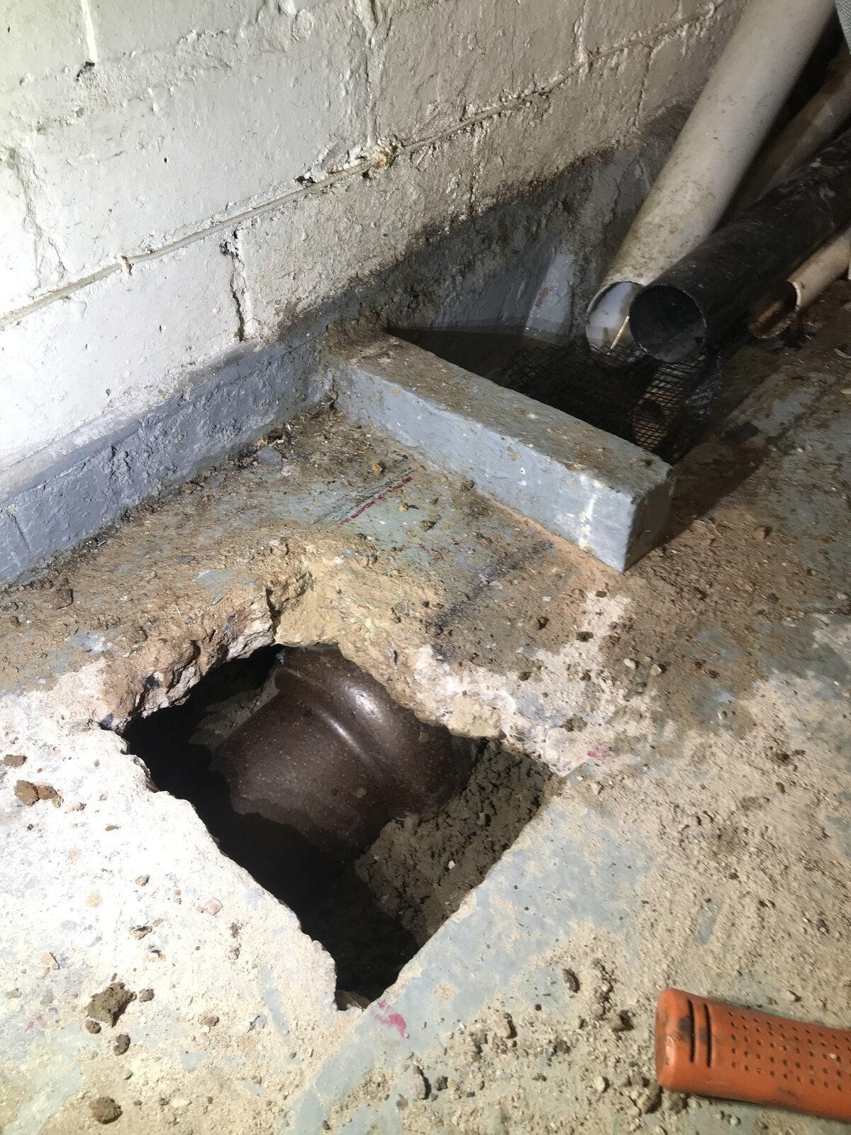

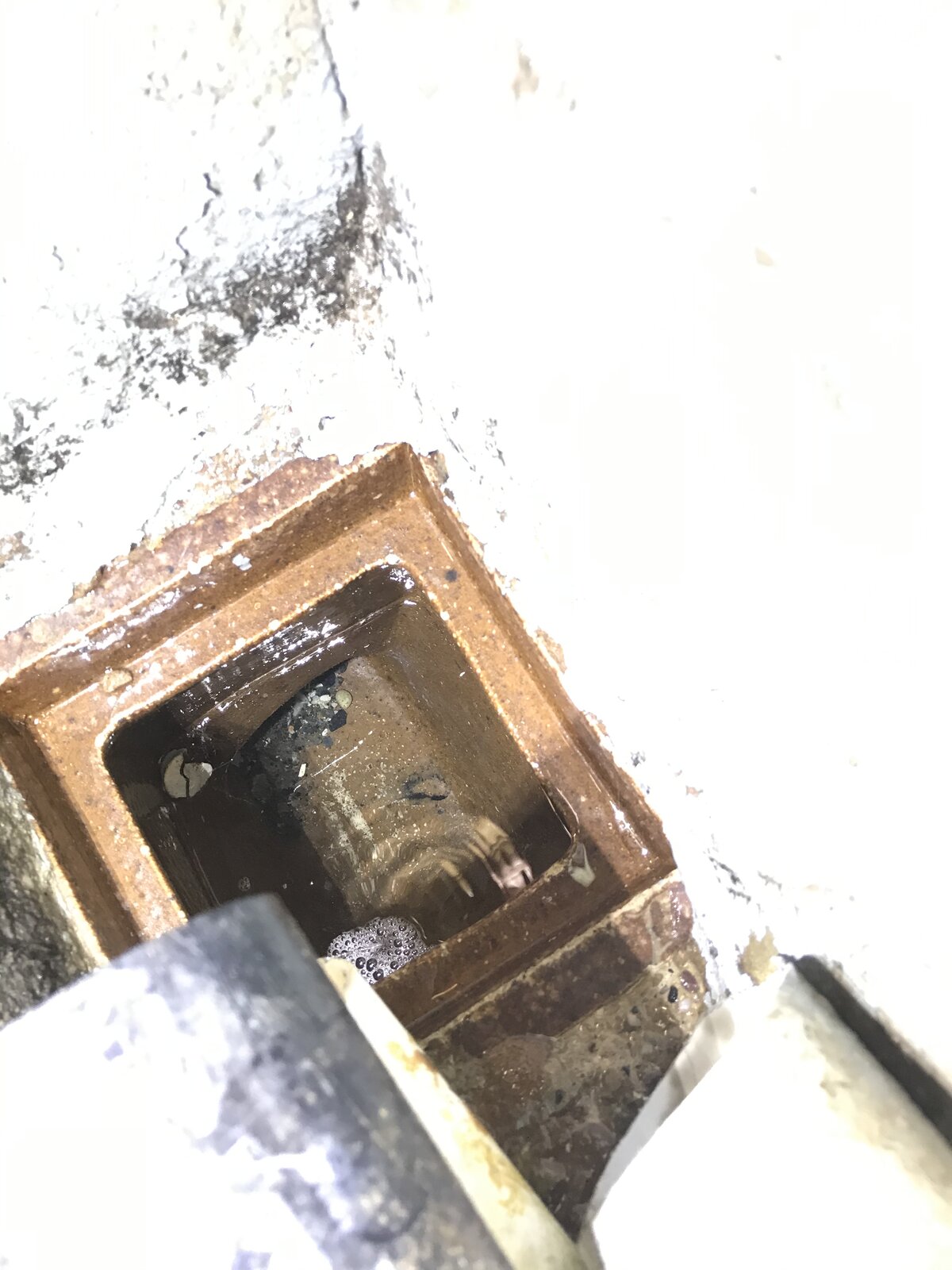

Hi everyone,
I’m trying to work out if this job is worth taking on myself or if I should get someone in.

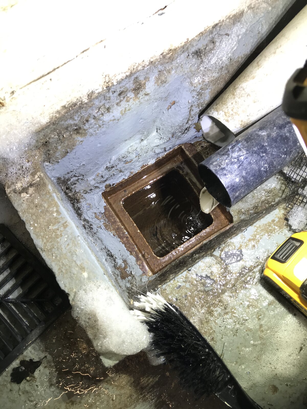

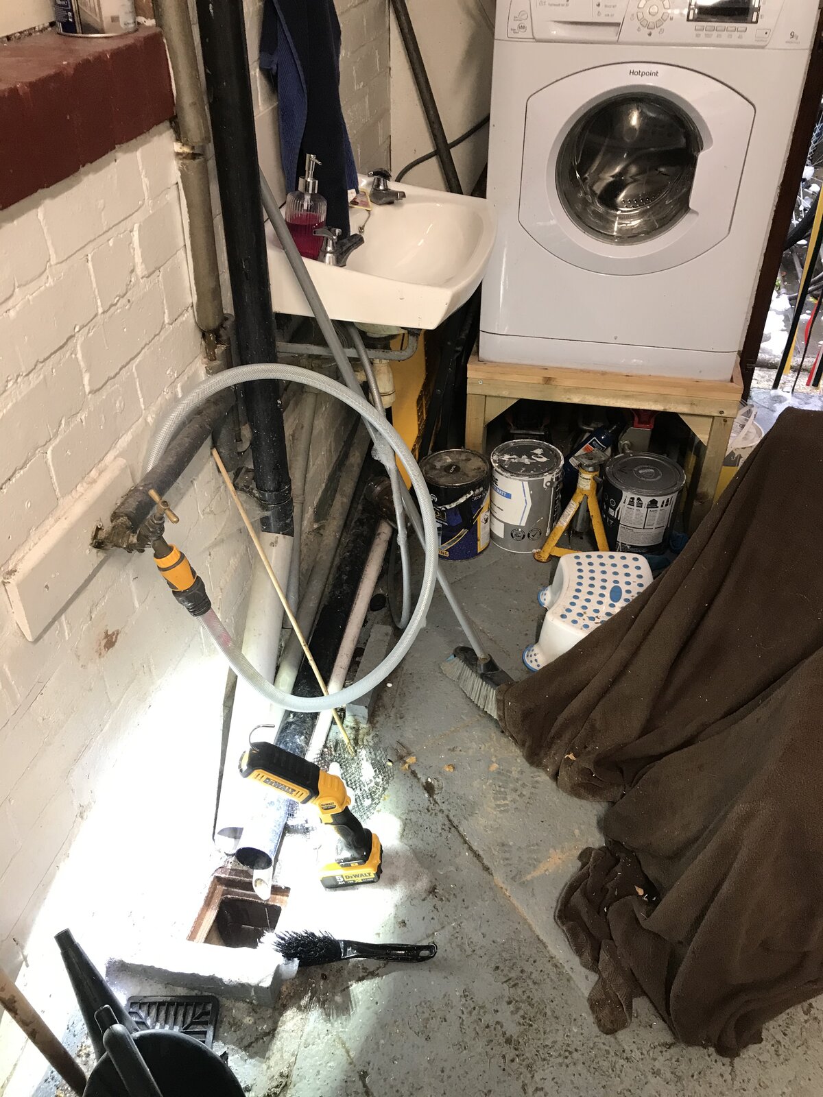

I have a clay trap in my garage that feeds into the combined sewer. An extension was added by the previous owner but the drainage wasn’t changed. Now I have half a dozen things feeding into this trap and no drainage in the garden. It’s pretty shoddy, the guttering for the rear of the house feeds back inside to this trap.
I want to change this clay trap for a plastic hopper and extend the run 2m to allow me to tidy it all up and provide various other options.
I’m pretty capable at DIY and have an SDS drill with some chisels, so breaking up the floor isn’t an issue. How hard would replacing the trap be?
I need to figure out a way to be able to work on it and also keep things connected as much as possible to minimise disruption
I figure I’d dig out the trench for the new pipe first then tackle the trap last before connecting it all up and testing? is that the best way?

The hardest part would be connecting to the existing drain. Worse case scenario is the original Builders have encased the clay pipe in concrete, which makes cutting it and getting a connection somewhat more difficult, but not impossible. I'd (carefully) break out the surrounding concrete and expose the gulley and outgoing pipework to see what you have before doing any more.
If you can expose the outlet pipework, then simply cut through it with an angle grinder and stone disc, chamfer the edges, and use a Fernco type coupling to take you to 110mm plastic and you're away. New Bottle Gulley can be fitted to take existing wastes, and if you want to extend the pipework to take the rainwater, look for one with a Back Inlet.

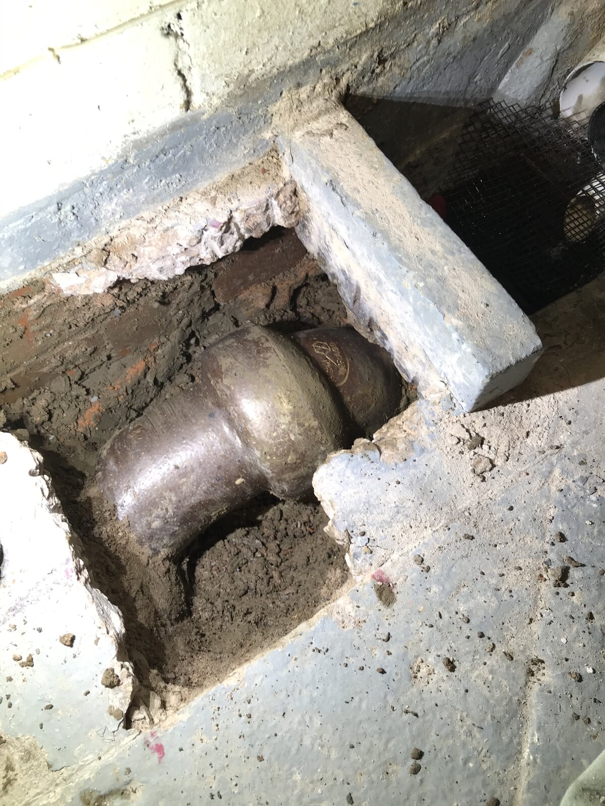

I had a look for the pipe today. Thankfully it’s not encased. It’s got a big shoulder on it that’s almost touching the concrete. Might be able to drill around the shoulder and remove the concrete without causing any damage.
hoping that I’ll be able to do this drainage work myself now

Remove as much of the concrete as you can/need to. You may find the gulley comes loose and is easily separated from the pipework at that joint, if not (and the joint was made properly), I'd carefully cut through the pipe just behind the collar. (Make sure pipework is supported before cutting in case the gulley is holding it up!) Once the gulley is disconnected, you can fit a coupling to the cut end, change to 110mm plastic and carry on from there.

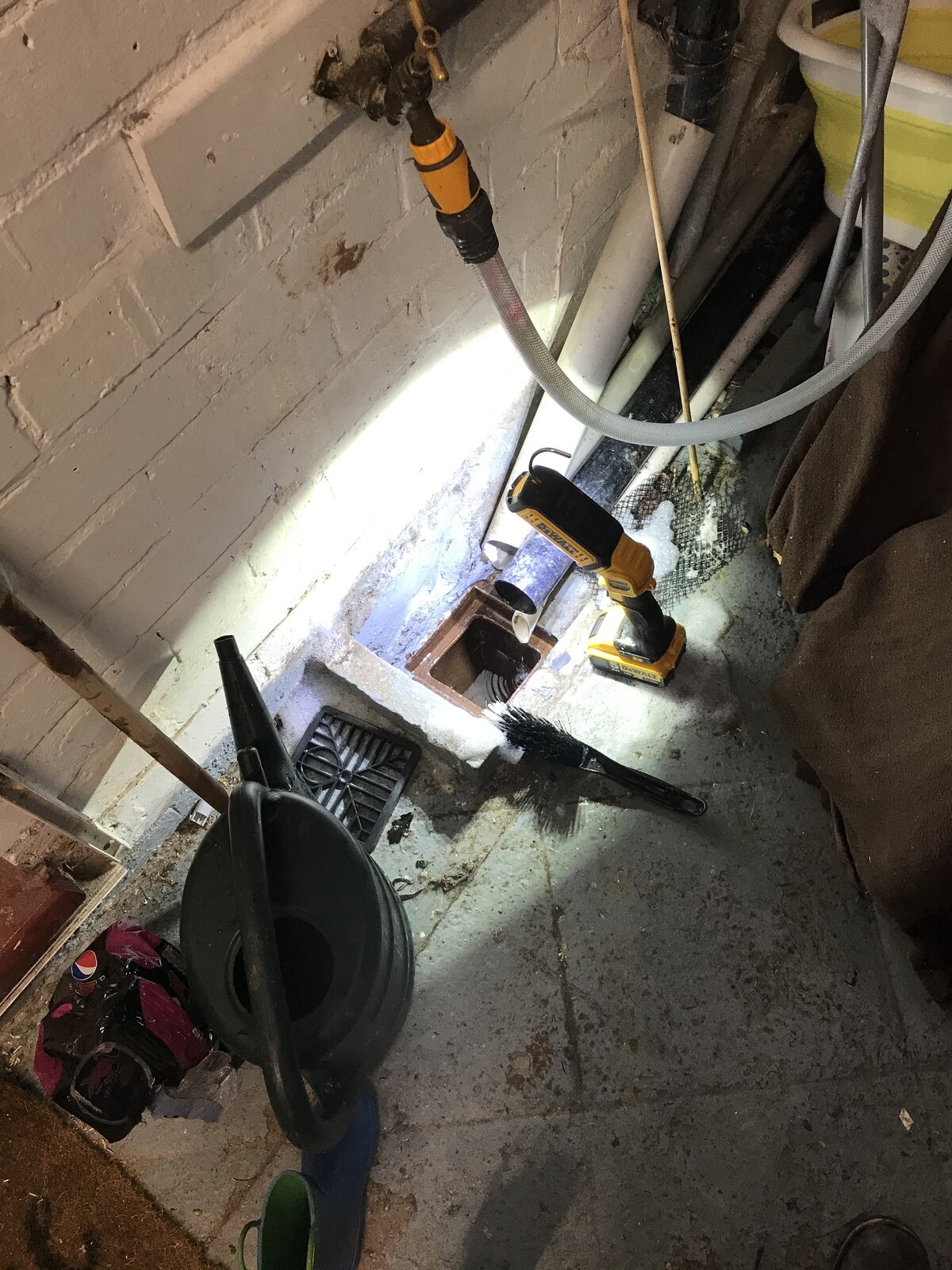

I uncovered some more of it. I’ll pick up some bits from screwfix this week and I’ll be able to get going properly with this now.
lucky I’m replacing it because I think it’s got a leak at the mortar joint.
I’m planning on putting in a bottle trap for the sink etc, then another one at the end of the run that will be outside for the roof gutters. As this is a combined sewer run should put in a p-trap where I cut the pipe to stop any smells coming up?

If you're using a bottle gulley, then that includes an integral trap. Personally I'd use one of these, FloPlast D530 Back-Inlet Bottle Gully | Underground Pipe Fittings | Screwfix.com to replace the existing gulley, and accept the wastes. It would then allow you to run a section of 110mm pipe from the back inlet to take the gutter downpipe, removing the need for another trap. Centre section of the gulley also removes for easy cleaning/unblocking should the need ever arise.
Alternatively, you could put a junction in and have 2 gullies, but connected to a combined system, both would need to be trapped.

While digging out I encountered an unexpected water pipe that seems to span across the garage which has stolen an inch of depth, not sure why that pipe would be there because there is already a sink in the garage and it’s not connected to it. But don’t really want to mess with it if I can avoid it
Given the age of the property, that water pipe could have fed a former outside WC, tap or even a neighbouring property. If it's Lead, I'd leave well alone!
Haha, yeah the last thing I wanted to do was mess about it with that pipe! I managed to use a spare fernco adapter to reduce the fall slightly make up for it, there was plenty of room for manoeuvre.
