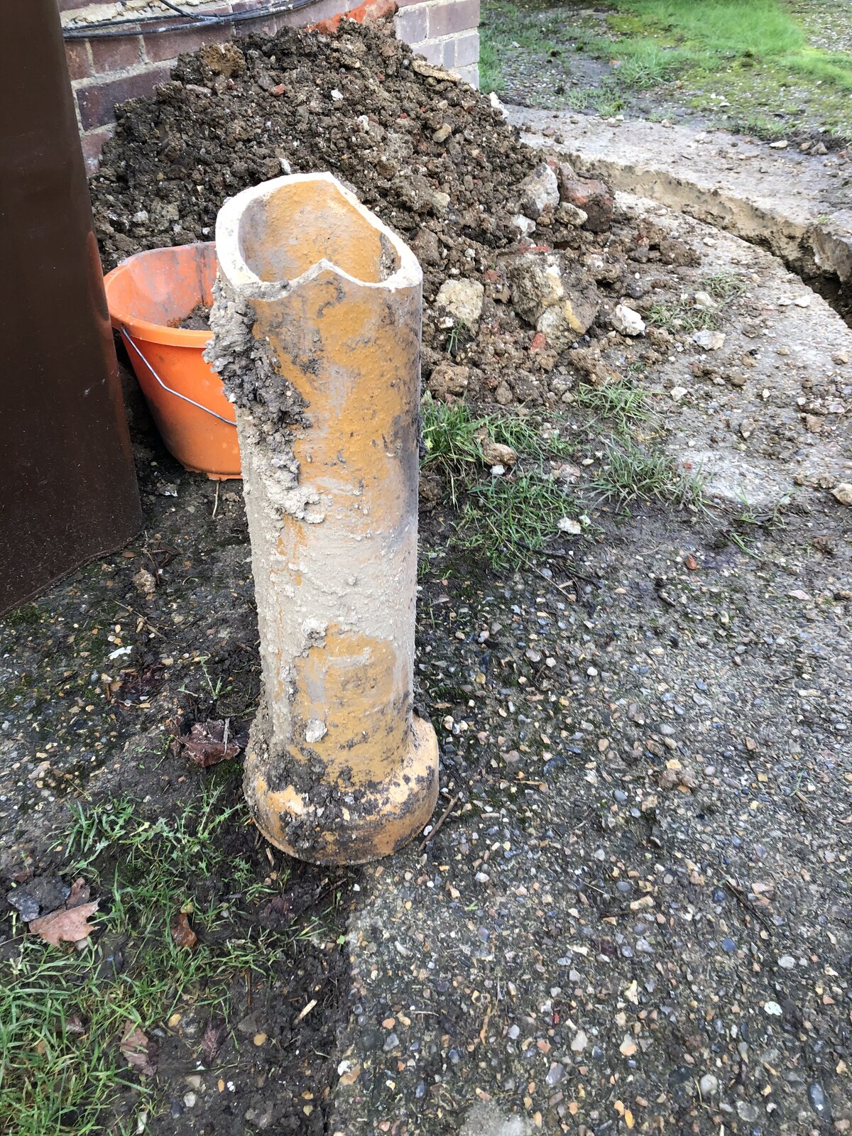

I recently had leaking guttering and traced it to backed up pipes. There was 1 metre of sludge and earth. Problem was a collapsed pipe. A local quote was £1260 to fix a 900mm run by cutting 90mm deep concrete.

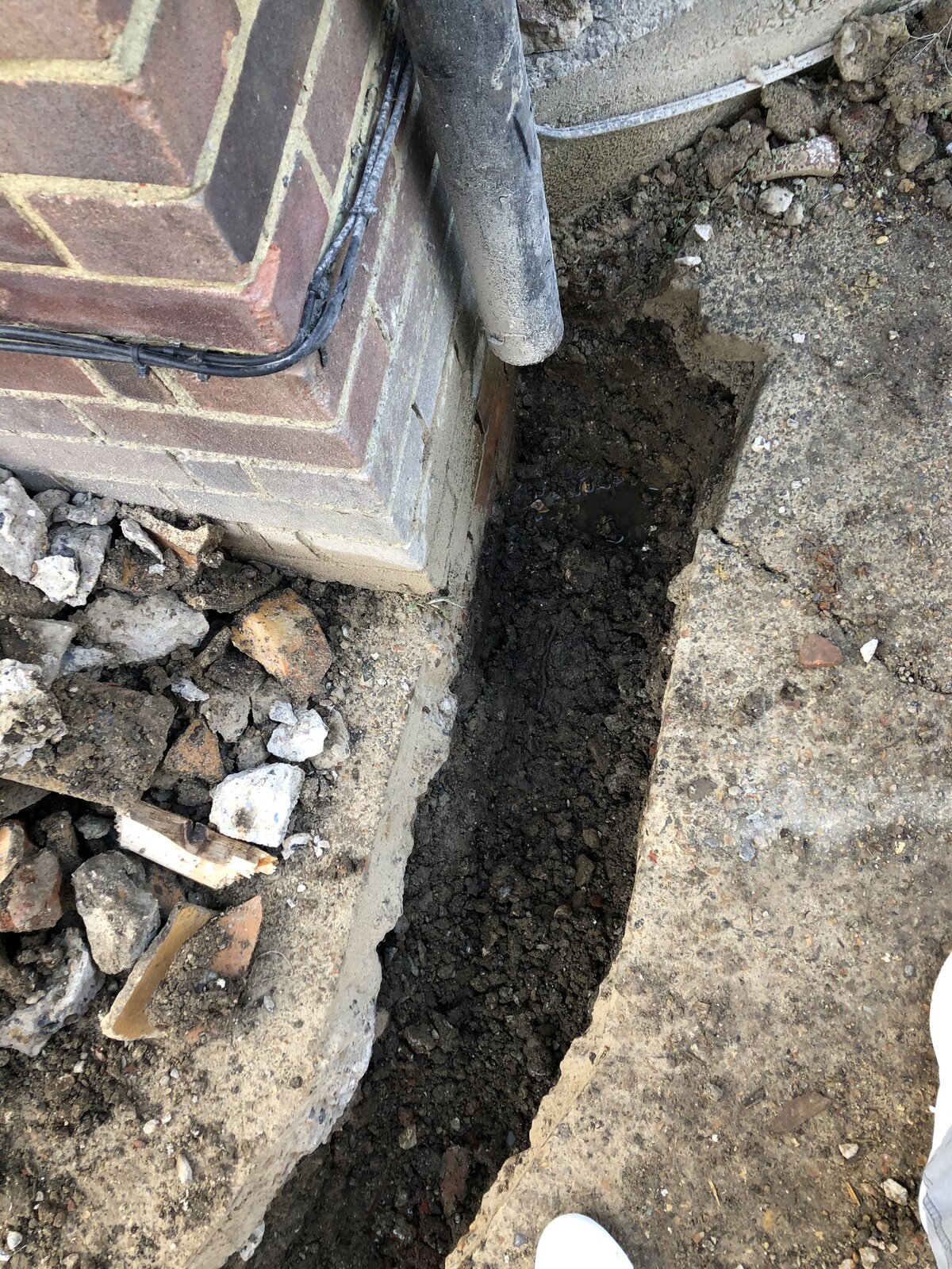

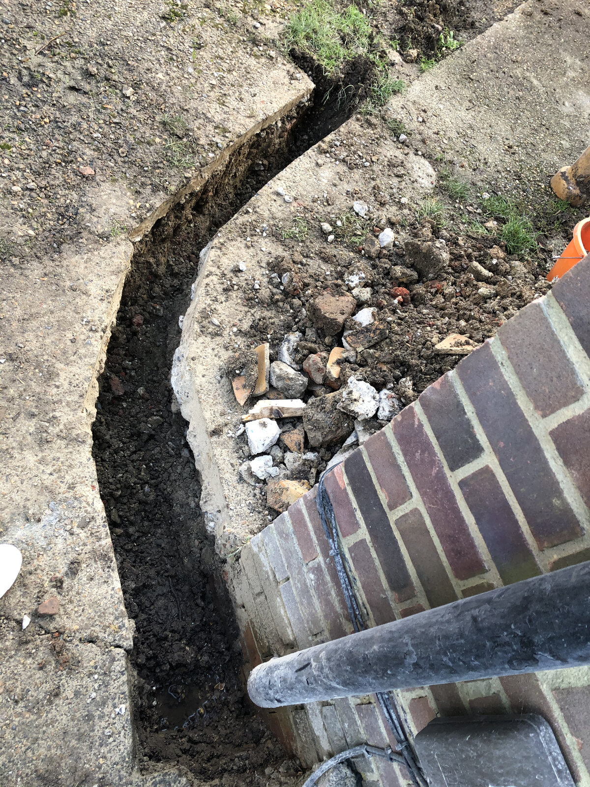

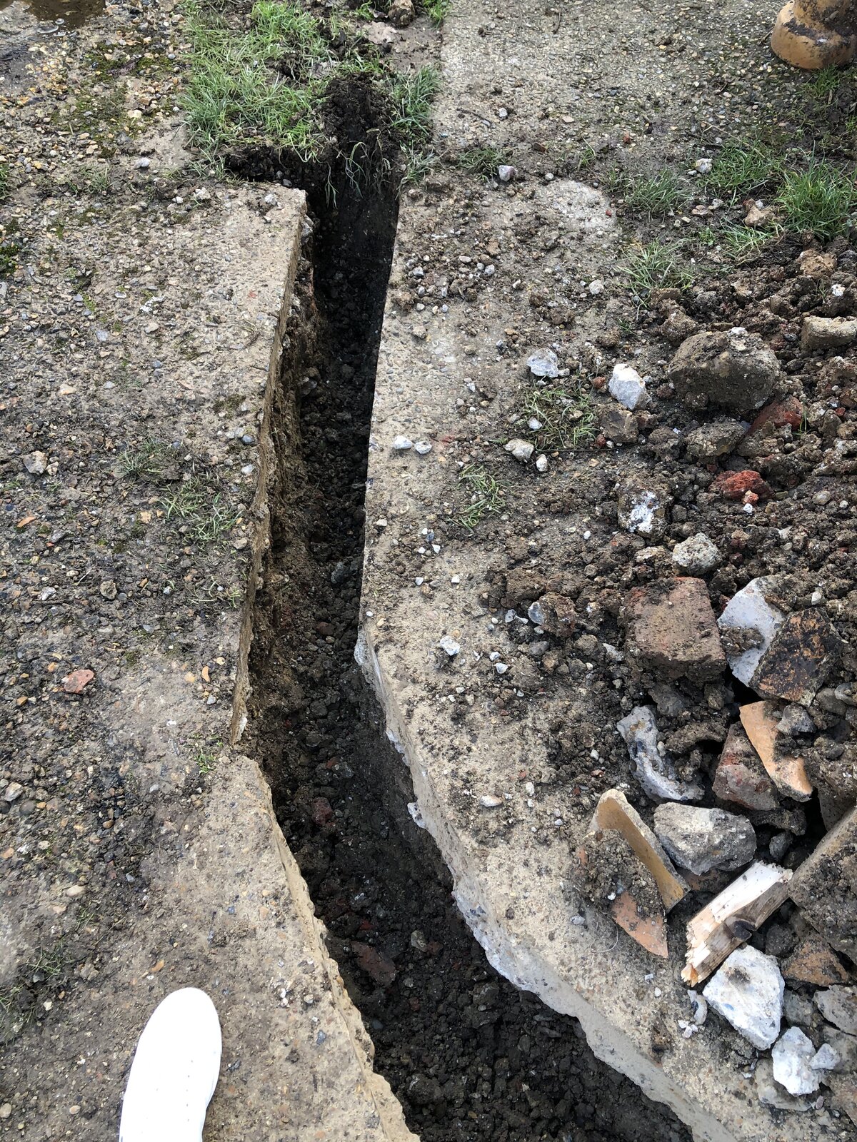

I borrowed an angle grinder and cut the concrete myself and dug down. I was able to see the clay pipe and took the length out which was smashed. It didn’t connect to anything as the rest of the clay pipe was smashed. I have chased the pipe but nothing but clay pieces. If I chase any more, I come to the garage which I am not digging up !!!
I thought about a soak away but am only 2 metres from the house in the area I need. I also have clay soil.
thinking of I keep digging down I might find the pipe that carries shower water etc. Not sure what I can do now to allow the gutter water to run away.
any suggestions
I’ve dug down to where the clay pipe should be and it’s smashed. About 2 metres in length now

There is a system to pull through new plastic pipe shattering clay pipe vs digging up. Will cost though... Might be worth keep digging but maybe look further down for manhole or where it goes. Laying new pipe is easy but you need to find the end that's in good nick
The pipe was underneath the down pipe. It didn’t go anywhere !! Just the run I’ve dug down. Lots of cracked and smashed clay pipe. The trough I’ve dug is where the pipe pieces were. It’s just disappeared now. Which is why I’m thinking of a soak away
Hi Wayners. That’s the issue. The pipe doesn’t go anywhere. I have a down pipe in the back garden but would have to go through a garage or a set of concrete steps which would be too pricey
Hi Ian, I don’t know where the drains are or if I keep digging I will find a pipe to tap into...
