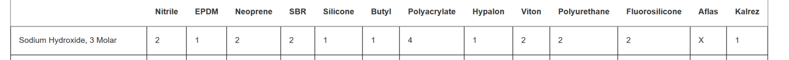

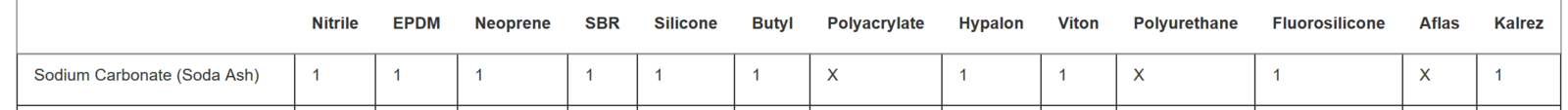

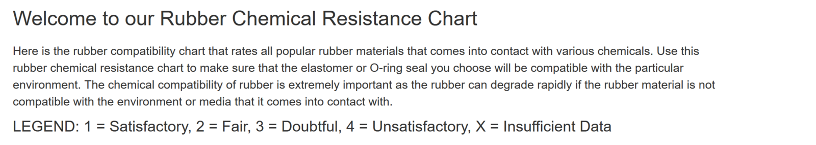

But I cannot find a waste cleaning chemical that will do the job. Can anyone please recommend a strong cleaning chemical that will fully dissolve the grease and not damage the push-fit seals?
