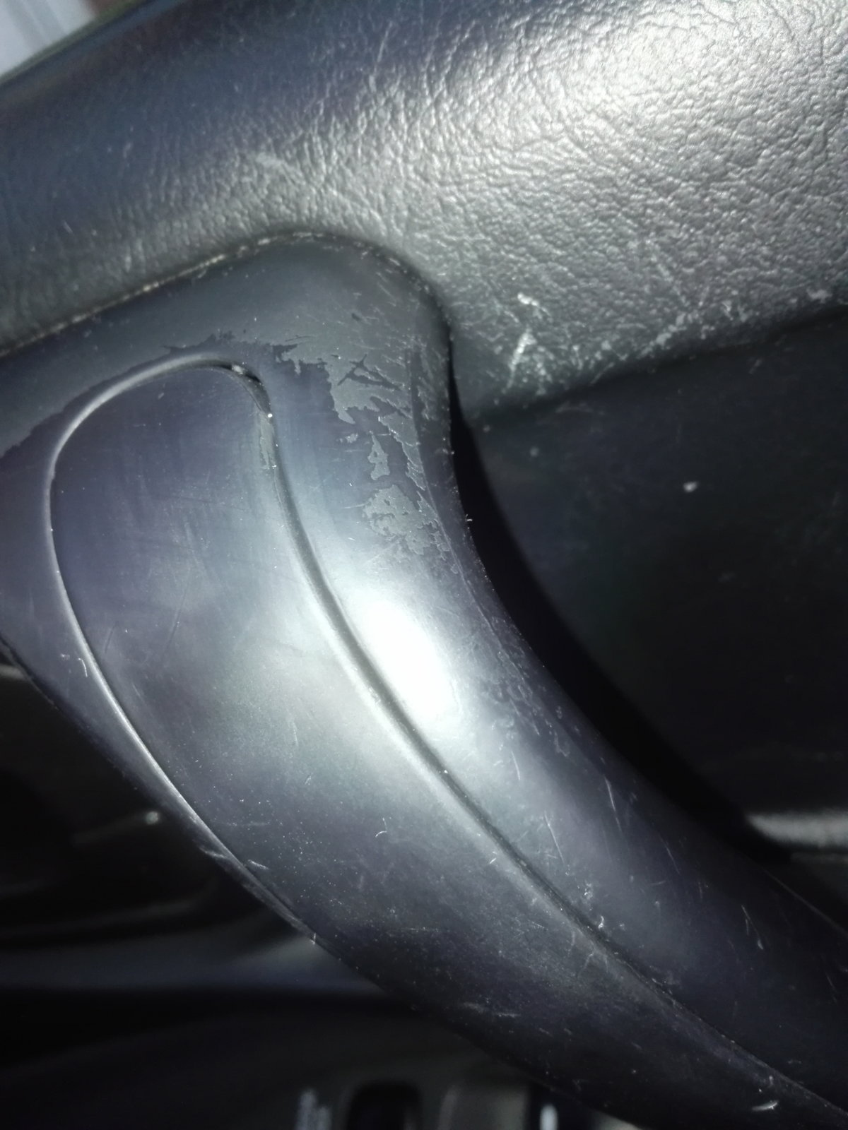

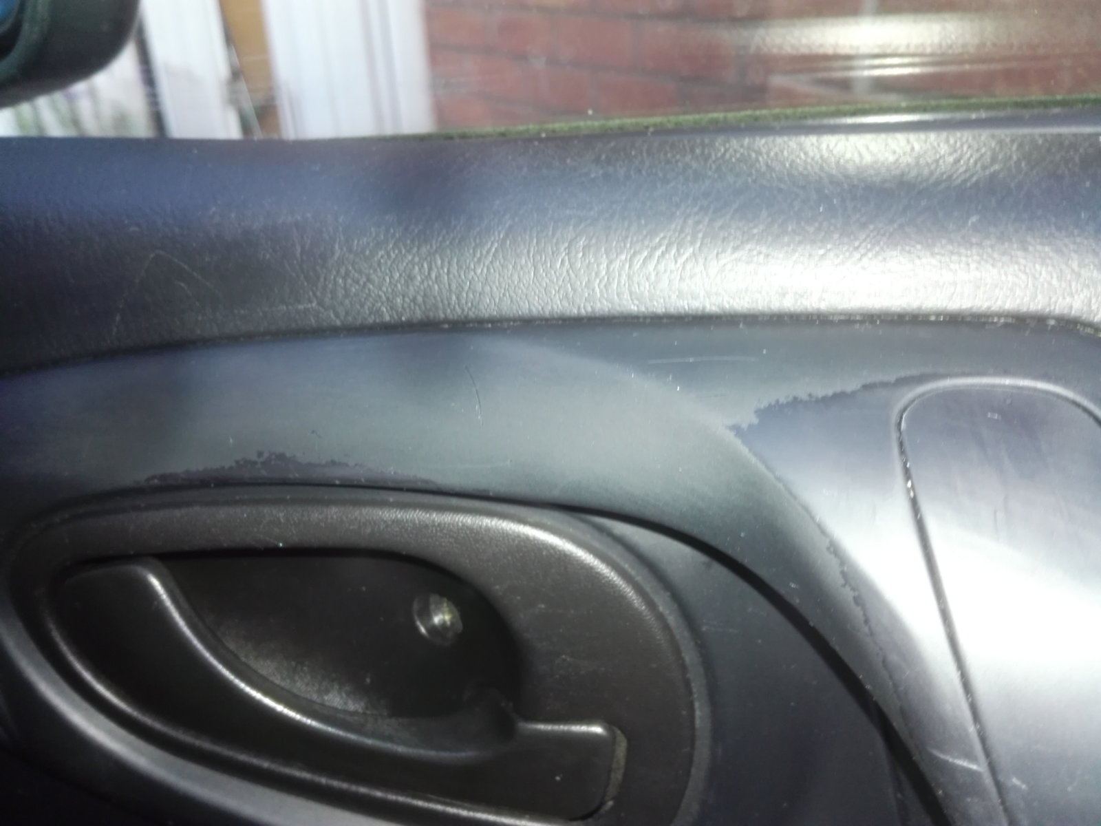

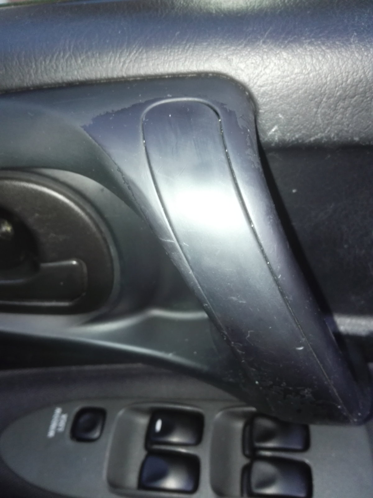

The interior front door handles have what looks like filthy, sticky gunk stuck to them. I used G101 and tar remover and, with a bit of elbow grease, it cleaned off, leaving a dirty mark on the microfibre cloth and a clean, smooth surface underneath.
Then number one son pointed out that maybe the ''sticky gunk'' was actually the top surface layer of plastic on the door handle and I had rubbed it off!
I must admit he may have a point. I mean, the gunk was so sticky and appeared to be adhered to the surface of the handles, I thought it was just years of handling with dirty hands. But now I'm thinking again.
The pictures are below. What do you think?
It's what's left of the rubberised coating on the handles. Originally put there as a 'soft touch' coating in an attempt to give it a better quality feel.
Used on many plastics, not just in cars.
It deteriorates over the years and becomes a sticky mess. There is no repair.
The only options for improvement are clean it all off, or buy new handles.
Consider yourself lucky that it can be cleaned off so easily - it can be next to impossible to remove.
Well, it wasn't that easy! But not mega difficult, either. Maybe I shall look for some replacements.
