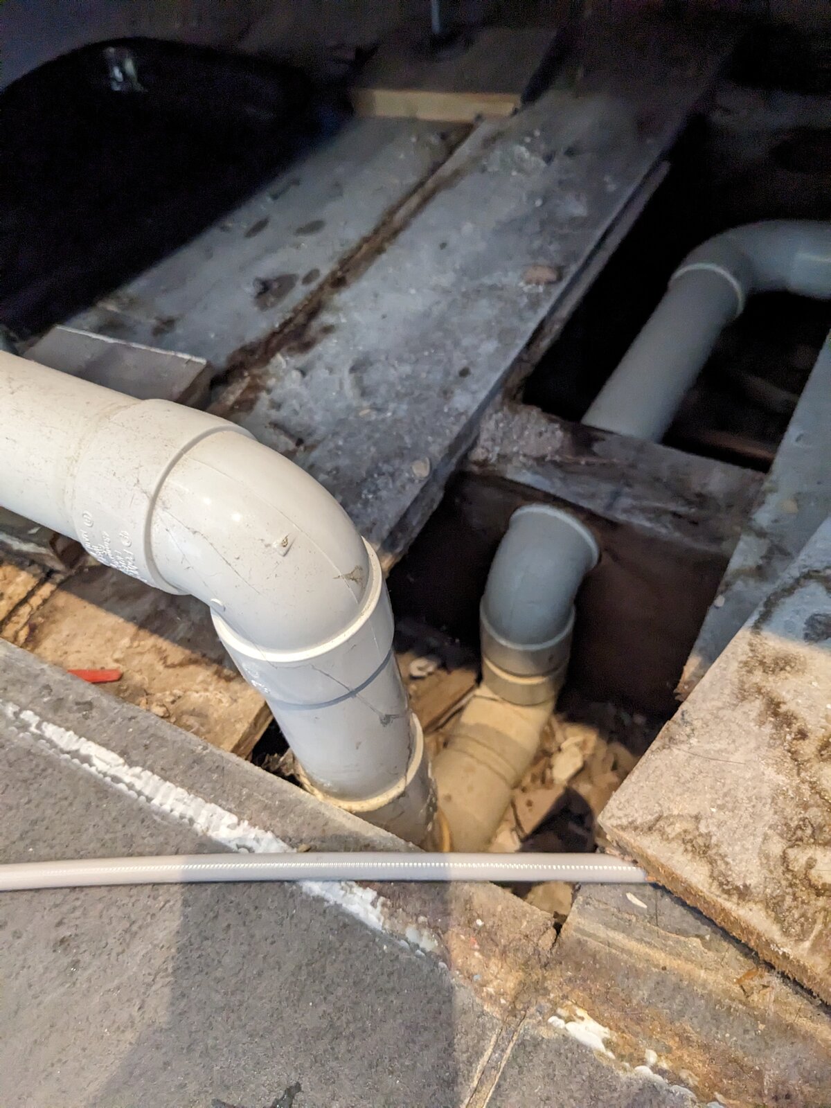

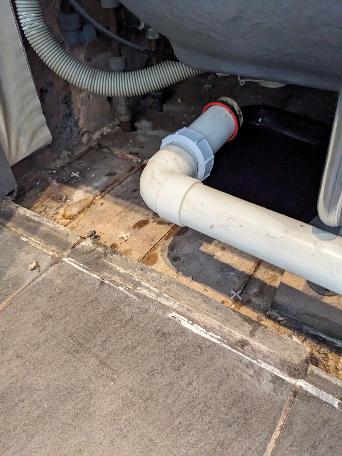

I've finally managed to remove the bath panel tonight, as the tub has been draining incredibly slowly. I thought this was due to soap and hair build up so was expecting to have to pull a load of crap out. Instead the trap was clean. But I discovered a few things which have been confusing me.

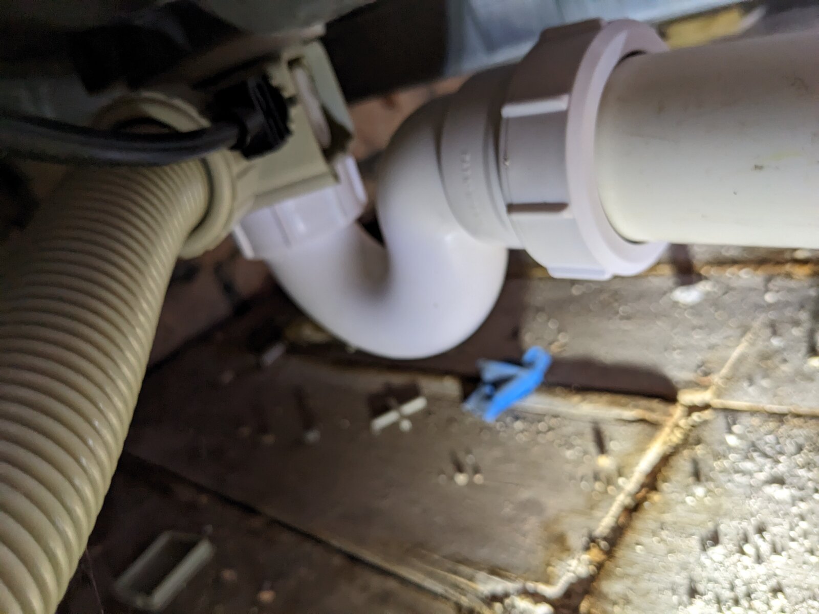

Firstly the plumbing under the tub is a bit odd, there is a normal p trap and then a second u bend made out of elbows under the bath. Could this be because there used to be a tub with a drain in the middle?
Weirder still, when I disconnected the overflow Flexi pipe to clean that, I noticed a constant trickle of water backing up and into the bath waste into the tray underneath. See video.
What the heck is going on? The bath and sink share some common plumbing, and there has started to be a lot of gurgling as the sink drains. The drainage from the bath has never been great, but the backing up is getting progressively worse over the last few months.

That's Not a normal P trap, that's a shallow bath trap and unless the waste is heading out to a hopper or open gulley then it's the wrong trap for a bath. If it's into a stack then it should really be a min of a 50mm seal on the bath trap, that one is only 19mm. The trickle may be be down to not enough fall on the pipework immediately downstream of the trap and there is just enough water in there to run back up through the trap.
The pipework under the floor looks like someone has attempted to make up a significant homemade running trap just using pipework, possibly because they weren't able to fit a trap to what was there before, sometime the case with floor standing baths that use flexi's straight from the waste. Problem with a home made running trap like that is it can get blocked/restricted with no way of servicing, especially if using elbows rather than all swept bends.
Time for a wet vac to see if that clears things and check all the waste pipe has an adequate fall.

@Madrab would you recommend swapping the 19mm trap for a 50mm, preferably with cleaning eye?
Edit: scratch that, there's no depth for it

If there is that homemade seal then there's no real point in adding a deeper trap. it would have been better if the culprit had used compression fittings, then at least it could have been taken apart. If it was me then I'd be looking to cut all that out and connect something smarter in there, say a waterless or remote trap.

Embarrassed to say that a couple bottles of Mr Muscle drain unblocker did the trick overnight.
I think the bottles recommend a small dose, but with my plumbing arrangement it wasn't getting anywhere near the issue. Once the existing water was displaced the gel did a great job.
