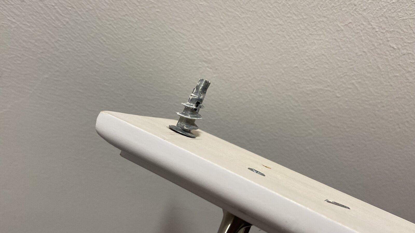

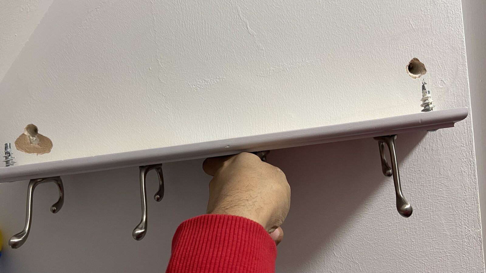

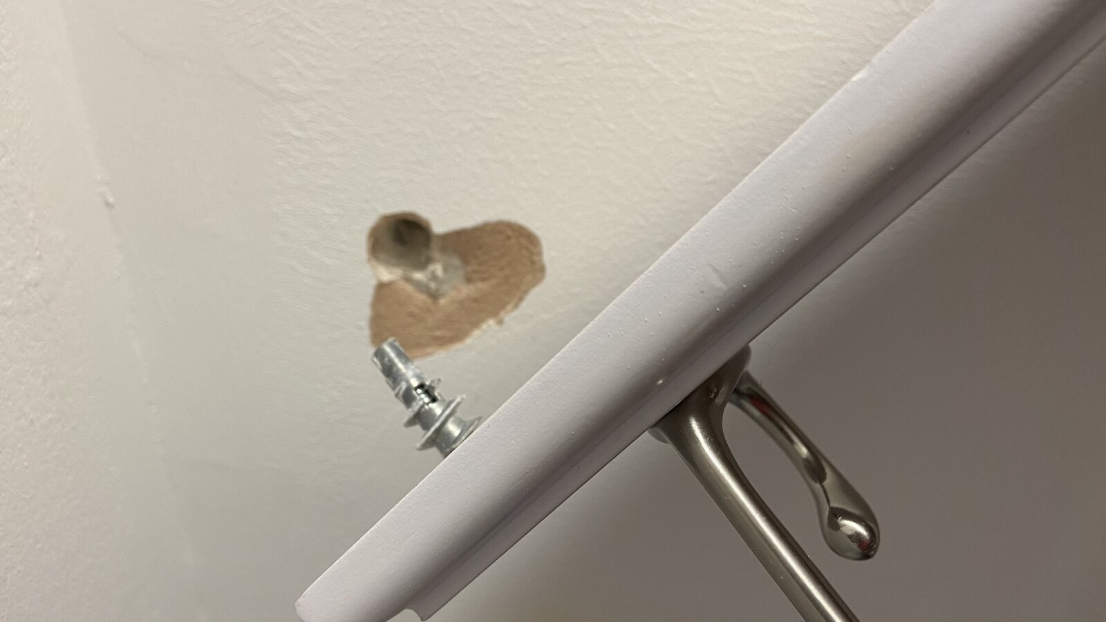

One two many coats from the kids and now this has happened. Any help please on what to do and the correct plasterboard plugs I should be using?

Horrible things, those self cutting fixings.....is the wall hollow? If so, google 'hollow wall fixings' - if it's solid, drill a hole (maybe 8mm) into the brickwork and insert a 8mm plastic plug.
Use 4.5 or 5mm gauge screws with these ones.

fixing into plaster is not much good as it has little strength
It looks to me like your wall is plastered blockwork, in which case a screw and plasplug, as @Burnerman suggests, will be a hundred times better.
but if, when you drill your hole, you find that there is an airspace, and the plasterboard is attched to wooden studs, you can use one of your coathangers to find where the studs are, and put screws right into the woodwok. Which will be fifty times better.
Something like these will hold 20 or 30 kgs, the constant pulling on the coat hooks would probably weaken the plasterboard before the fixing gives way. Fitting one in the middle as well as at each end will help. The thickness of the plasterboard and the gap is relevant in deciding which size/length fixing to get

but is it a hollow plasterboard wall?
to me it looks like plastered blockwork.

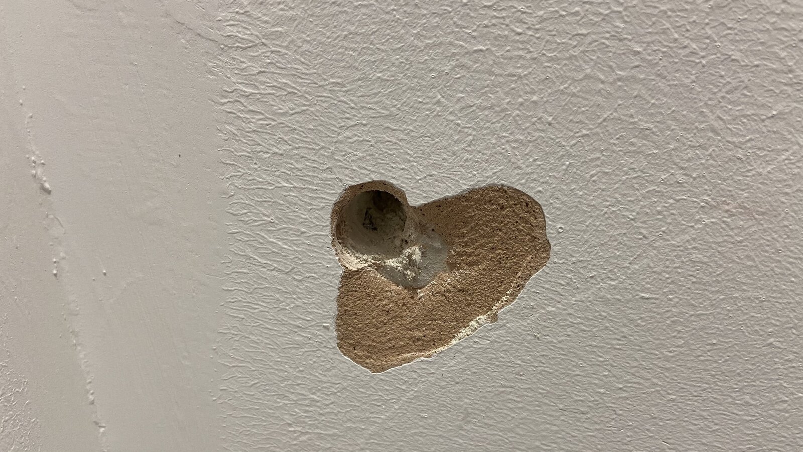

So I don't know if this is plaster board, my screw driver goes pretty deep into the wall. If I use a drill to make a pilot hole for the plug how do I know how far to stop drilling as it just keeps going.
Thats plasterboard, bend a piece of wire and push it round the side of the hole to give you an idea of the plasterboard’s thickness. Using a straight piece push it through until there is resistance, measure it, and subtract from the thickness if the wall. That will tell you what the gap is.
Blup
With that sort of gap you can get by with either conny's or blup's fixing choices.

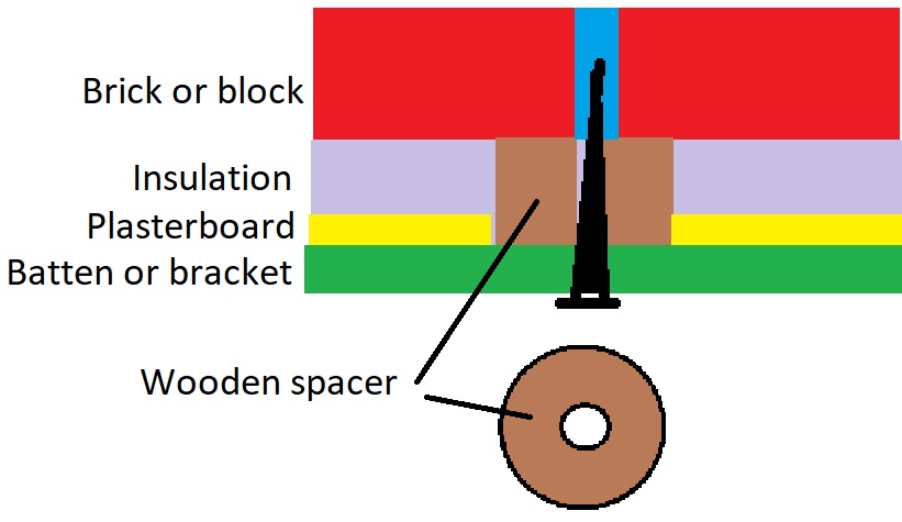

If there is a void or soft insulation between plaster board and the wall then using a spacer as in the sketch below will provide a secure fixing to the solid wall without putting pressure on the plaster board. The blue is a wall plug and the screw could have been drawn a bit longer
