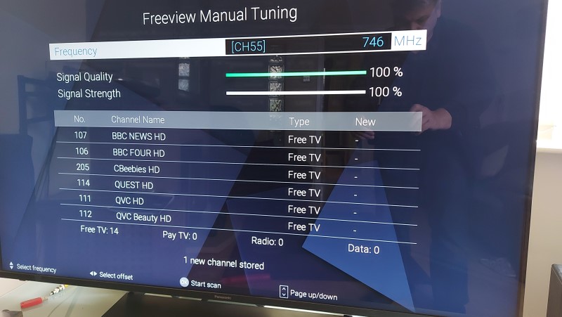

COM7 is still on ch55 AFAICT. I have just checked the Freeview tuning on my TV. It was still tuned to ch55 for COM7. I then did a manual rescan of ch55. The channel list changed a little compared to the last time I listed it out. TV ch 83 - Now 80s has gone. There's a new channel called That's TV Gold which appears on ch 91. I get a total of 14 channels on COM7 rf ch 55.
To doublecheck, I had the TV do a whole new Freeview retune. After completion, and confirming the region set-up for N.West > Manchester, I still have Com 7 on RF ch 55, and it's showing it is receiving 14 channels in the mux group.
I can think of a few reasons to lose a mux such as damage to the cable causing a notch filter at that specific frequency, or a change in an aerial to one which receives ch 21-50 only. However, if you've has rf ch55 reception at the current address with the existing aerial then so long as nothing is broken then it's hard to see why you've lost that mux.
What else has changed for you? New TV, or was it the aerial change, or has something pressed on a cable somewhere?
Have you tried a manual tune of RF ch55?

Ah, all becomes clearer now. It's not to do so much with channels moving; it's just range. You're on the fringe of reception for the 25,000W transmission of COM7. The other main muxes are transmitting on 100,000 Watts so your reception of them is better because tge field strength is higher.
