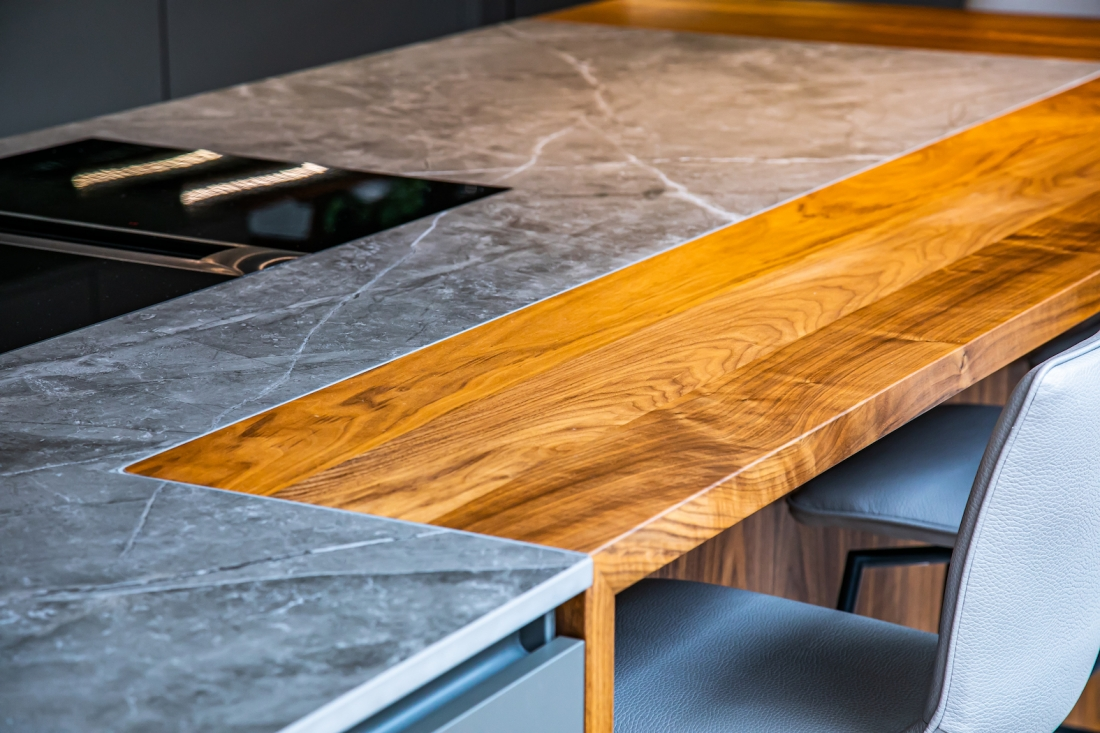

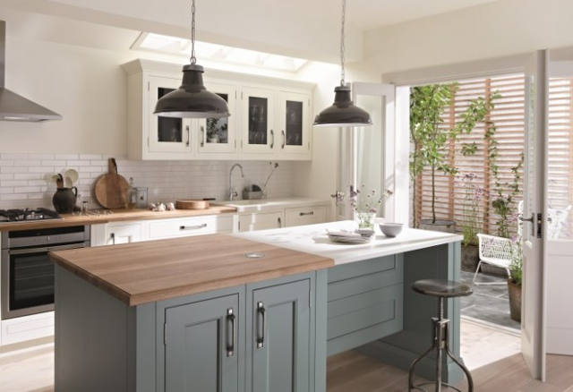

Sorry, Probably not helpful! But could go for something completely contrasting in colour/material, that picks up an accent colour from somewhere else in the kitchen?
