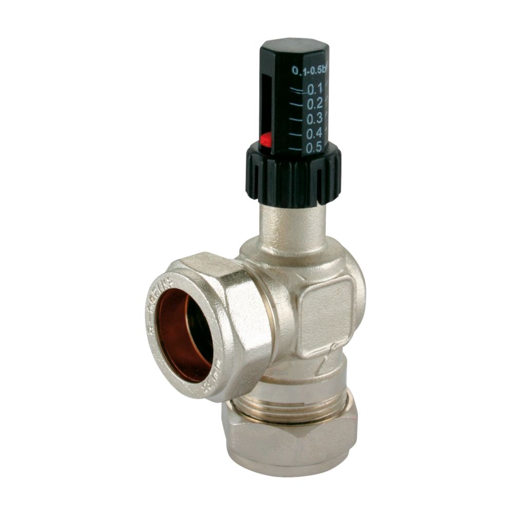

The pump is fixed speed and was causing noise in the system so I had to install an external bypass to slow it down.
I have done these tests with the bypass set to a minimum to avoid too much hot water going back to the boiler
Is this pump internal?, what type of bypass have you got is it a manual bypass or a ABV, if a ABV what make is it?.

The pump is internal
This is the bypass valve
