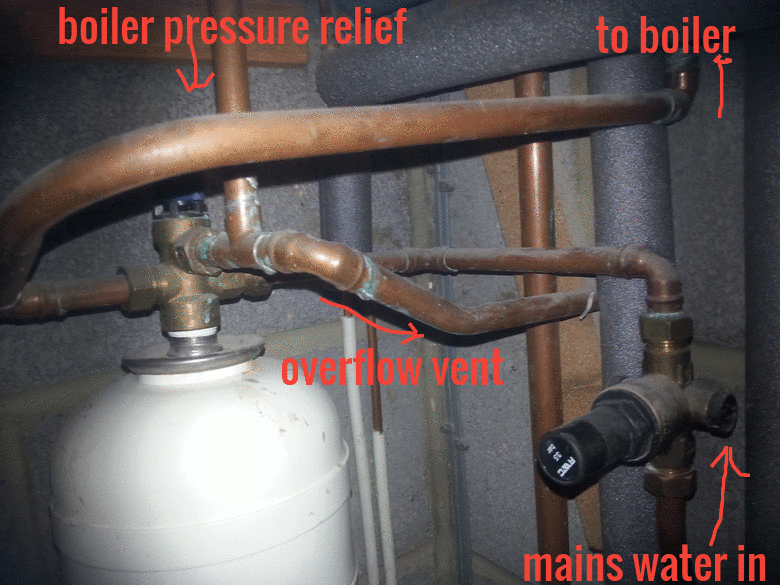

would you be able to expand (pun intended) and explain this logic please
encountered the exact same situation. Can you see why this was happening?
because when the water expands, the EV is there to absorb this expansion, if that fails next line of defence is the PRV , it opens at 3 Bar to protect the boiler, once it has released the excessive pressure then when cold the boiler or system pressure is too low, so you add water and it simply cycles again
