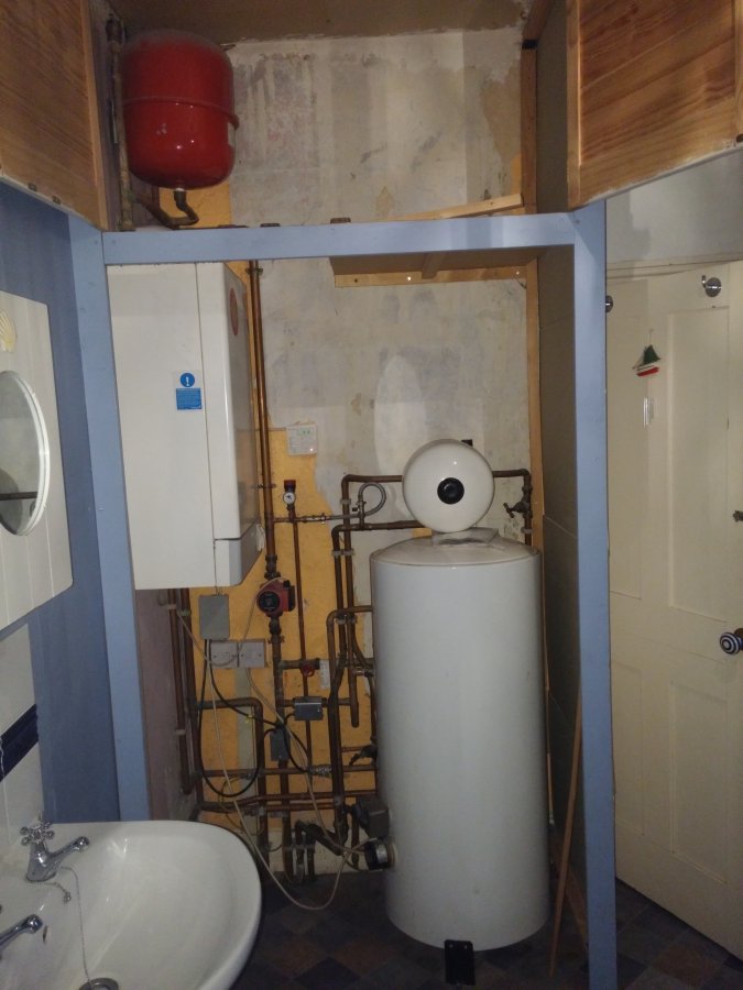

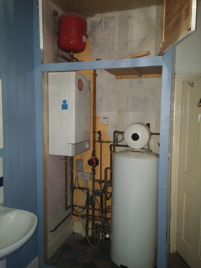

Hi
Just move into this house.
Never seen so many pipes and equipment,
need help understanding it all.

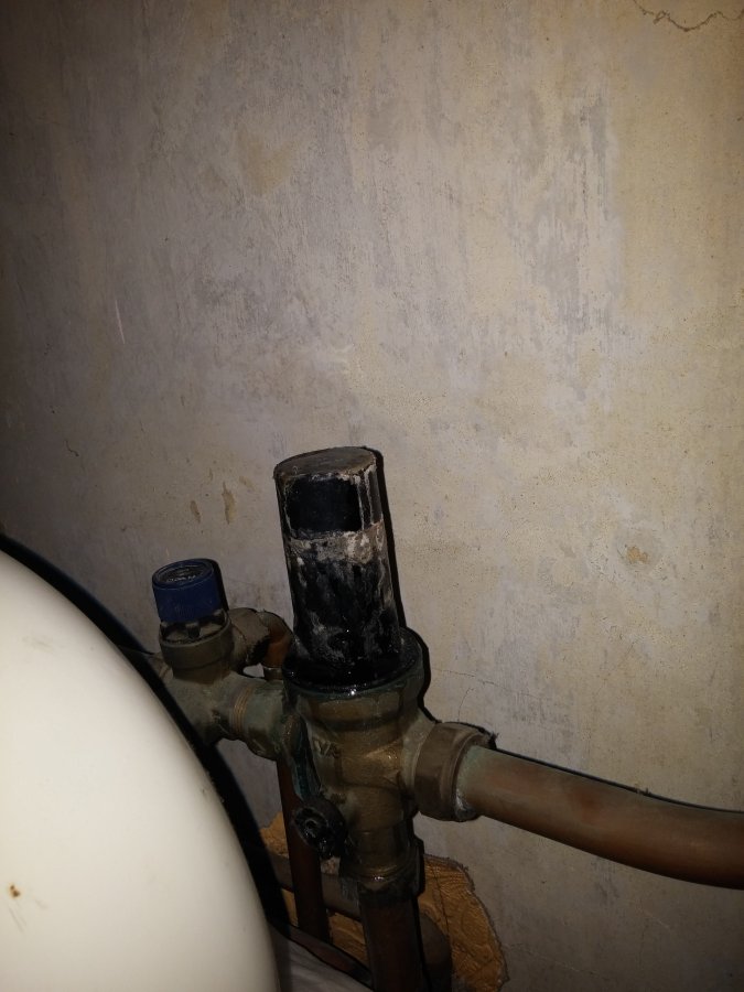

Also got a small leak from one of the parts, please advise.
See pictures
Many thanks
Sealed s plan , unvented hot water. Needing a new combination valve.
Standard Unvented cylinder (looks like an Ariston) on an S plan.
leaking valve is a pressure regulator and a critical safety device. Only to be worked on by a competent person with G3 accreditation.
Pump is knocking on a bit in years as is the boiler but if it works then leave alone.

Nope, you'd never be able to feed hot water to 3 bathrooms and a kitchen, all at the same time, from a combination boiler.
That's why you have an un-vented hot water cylinder.
Get the heating and hot water system serviced by a recommended qualified engineer ASAP.

Any cover from BG will require an inspection visit prior to the cover, therefore the valve will be picked up as being faulty and wouldn't be covered. Need to get it fixed independently
The service will ensure your boiler is running safely and the un-vented cylinder's safety devices will be checked and tested and the valve that has issues should be replaced.
You can change to a combi but you wouldn't be feeding hot water to all 3 bathrooms plus the kitchen at the same time. Keep it as is.

Also, leave your system well alone. It's the best possible setup for your house. If you're keen to spend money on it, upgrade the controls to more efficient ones and leave it at that
