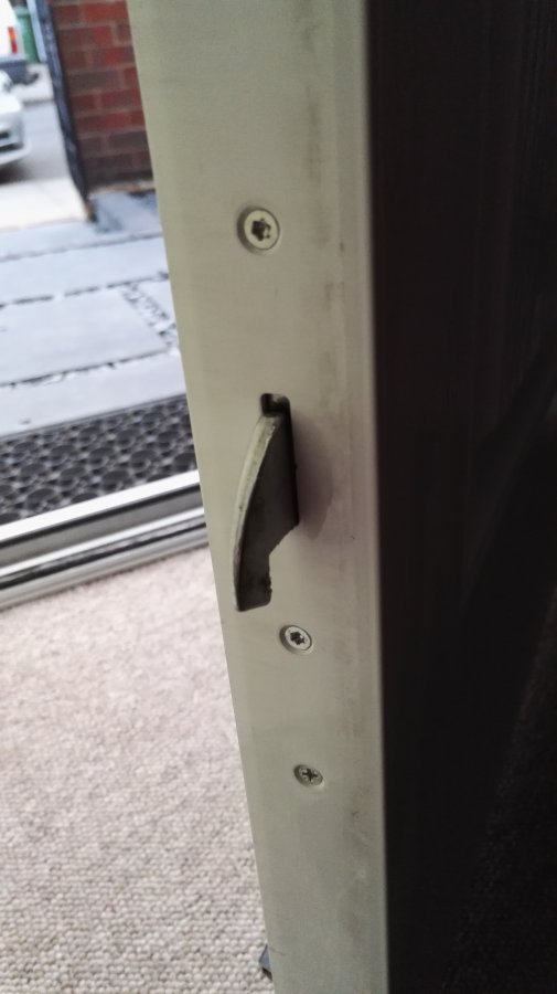

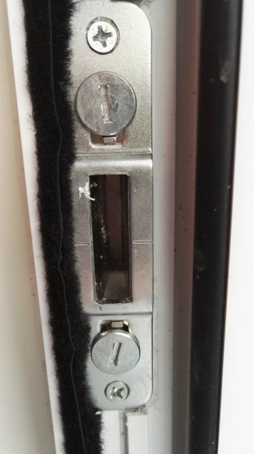

The keeps on the other side may be binding. Try taking them off one at a time to see which one (or how many of them) are the problem.
They can usually be re-positioned slightly if needed but showing us a pic of them wouldn't hurt first
Thanks again, Gazman. Was convinced it would be the top one but turns out it's the bottom one. With the keep taken out, it's locking fine.
Couple of pics attached. Turning the flathead moves it side to side but can't see if it can be moved other ways.

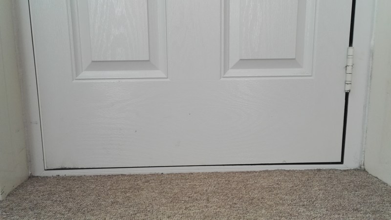

I think it's dropping on the hinge side (right hand side in original pic I posted). We've looked in more detail and it looks like it's dropped (and may still be doing so).

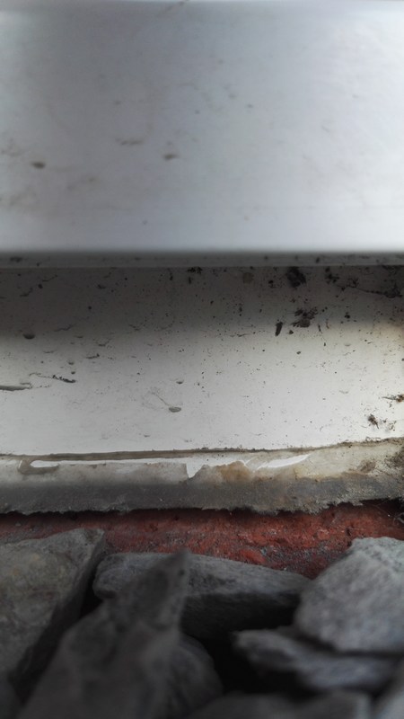

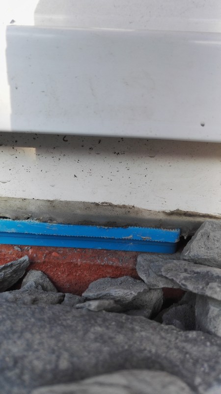

From the outside, we can see underneath there are 2 supports under the sill... and not much else! The guys who did the paving have been back to look but don't think it's anything they explicitly did and I think they are probably right. The bigger concern is that aside from 2 supports, there's nothing under there - you can just put your whole arm under there.
The window that's next to the door is also dropping by the hinge so the whole thing has probably dropped and needs fixing? Starting to feel a bit of of my depth - is this something easy to rectify e.g. trying to get some more packers under there to raise it up, or am I better off getting someone in. If so, guess this is now a builder not a window fitter we need?

If it's dropping on the hinge side, then you need to take the door off of it's hinges, undo the screws keeping it to the wall, and then see if you can lever it up with a crowbar. If that works, then you need to pack something under the frame to make sure it doesn't happen again. A few pieces of a slate tile are more supportive than the blue packers they've used, and you'd do it at several points across the cill.
As to builder or door fitter. If you need to take the door frame out, then fitters should be able to put some cement down underneath it, put the frame back in, and then pack underneath with slate or packers if the cement shrinks back a bit.
Now if the frames dropping on one side, is there any evidence inside or out of the frame sliding down the door reveal. Is there a gap appearing at the top of the frame on the hinge side.
