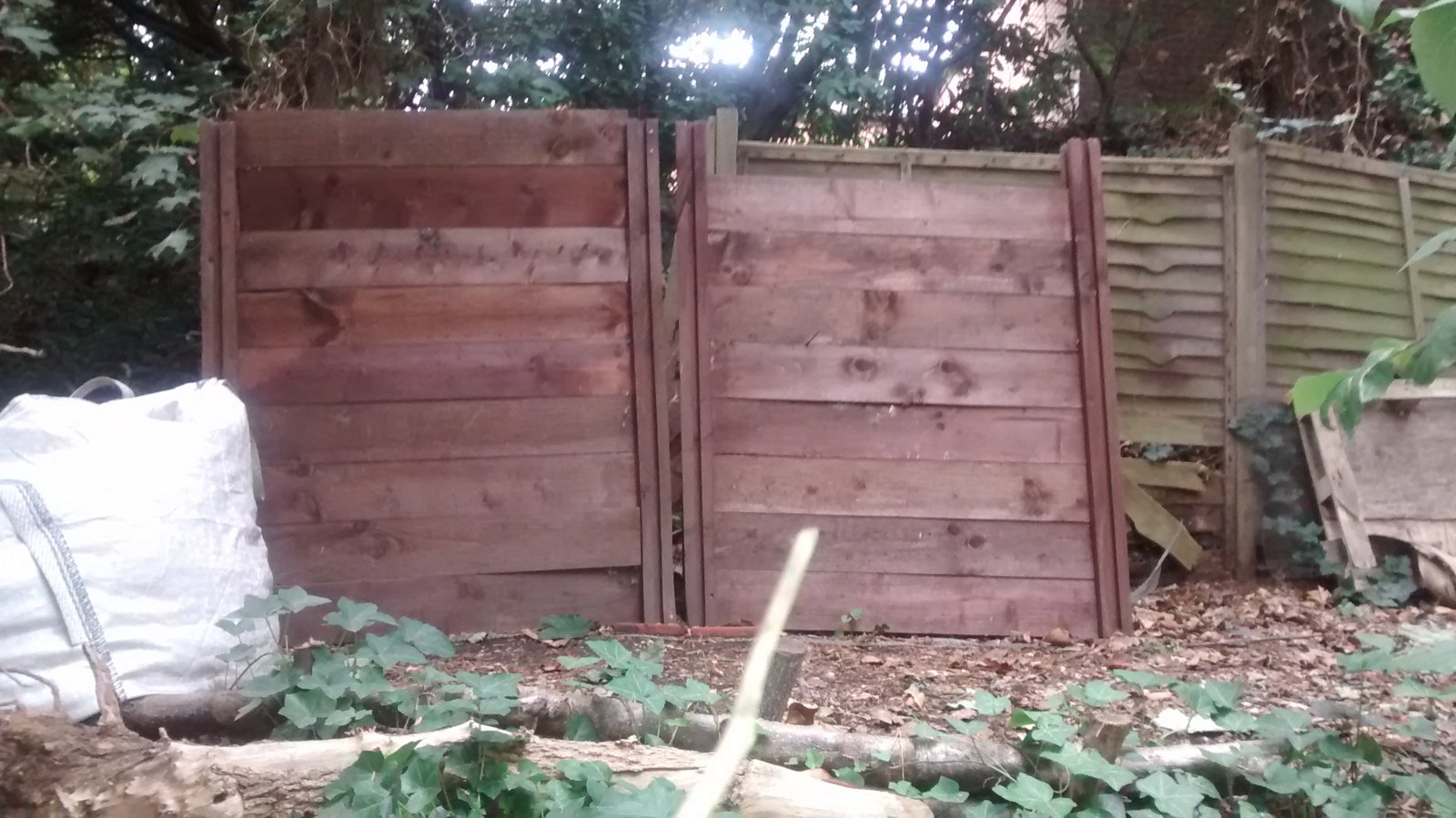

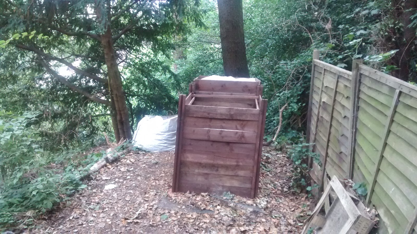

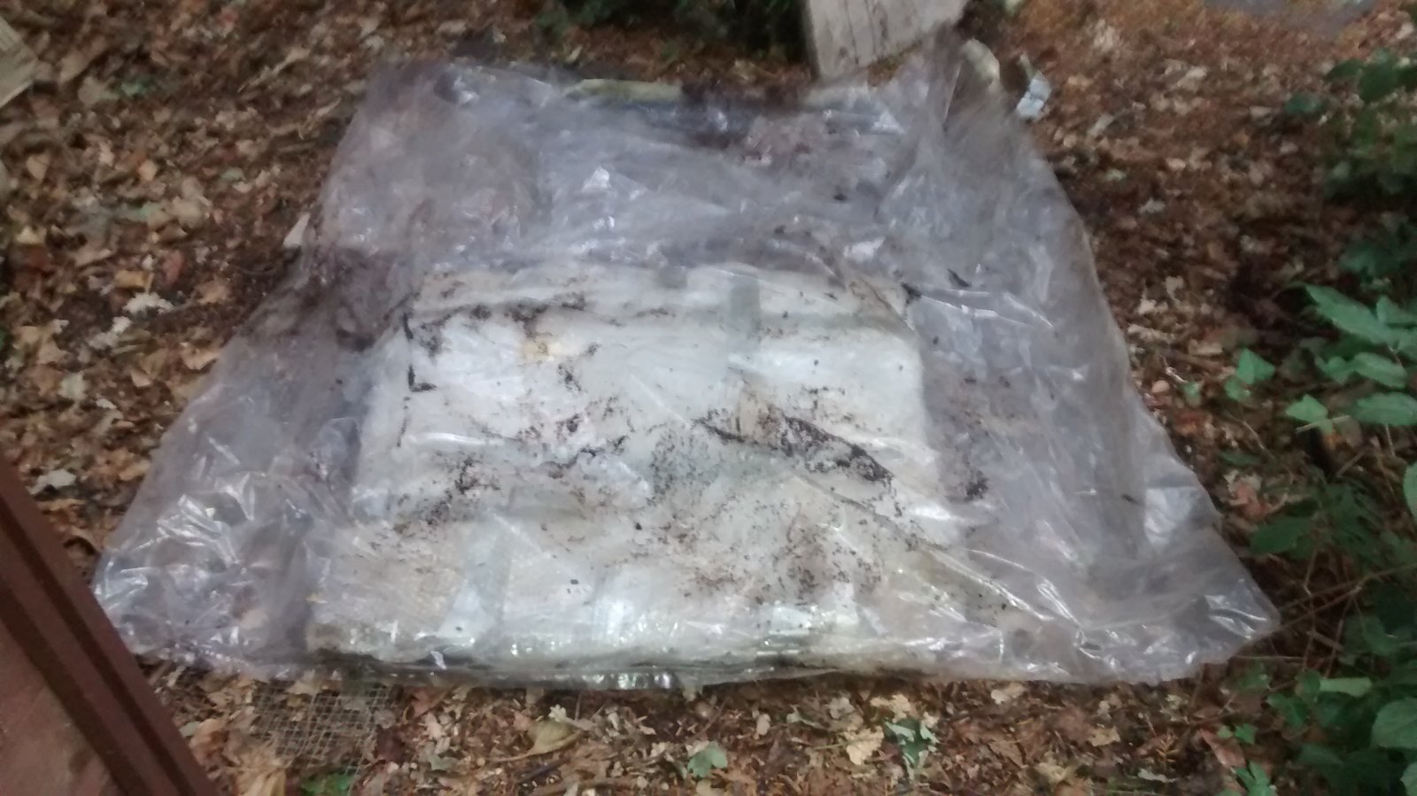

Some photos.
2. View coming down to the bins, roughly south facing IMG_20180818_140223147.jpg trees providing shade, downhill steps to the left

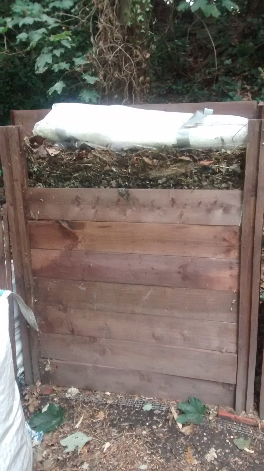

4. IMG_20180818_140540613.jpg RH bin, older contents, filled between end Dec 17 and mid April 18

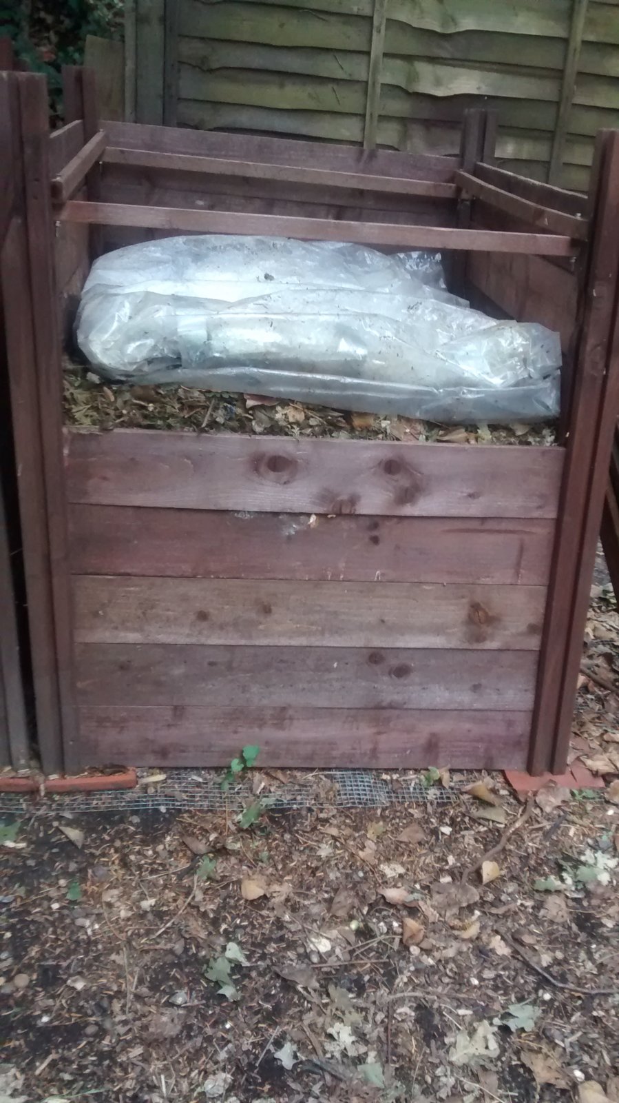

5. IMG_20180818_140545937.jpg LH bin, younger contents, filled between early May 18 and end June 18

The boards are 130mm wide so a full set (of nine) is 1170mm. When I filled the RH bin some of the stuff had been in a smaller compost bin (waiting for me to empty this one) and had broken down somewhat but I filled the bin up to the brim with that and new material. As you can see, the contents are now only c. 515mm high.
The LH bin I also filled brim full all with new material, then when that had gone down I topped it up (two? three? times) in order to include the last of a huge amount of shreddings. For that one the contents are now c. 1040mm high.
