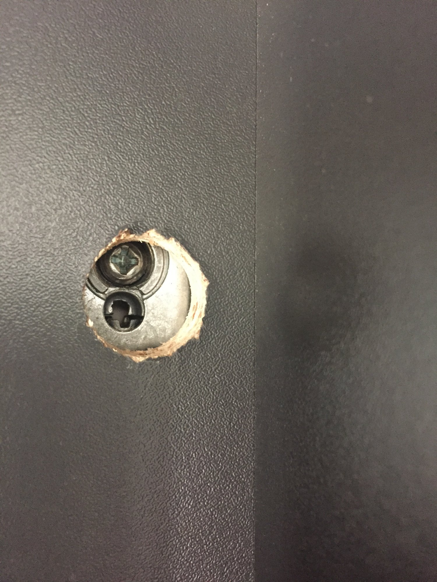

Hi all,
I am in the process of stripping out my kitchen but have come across issues on the wall units. The brackets have a small round cover within Phillips screw behind. The only has a few turns in each direction. Is there a knack to removing these?
Any help appreciated.

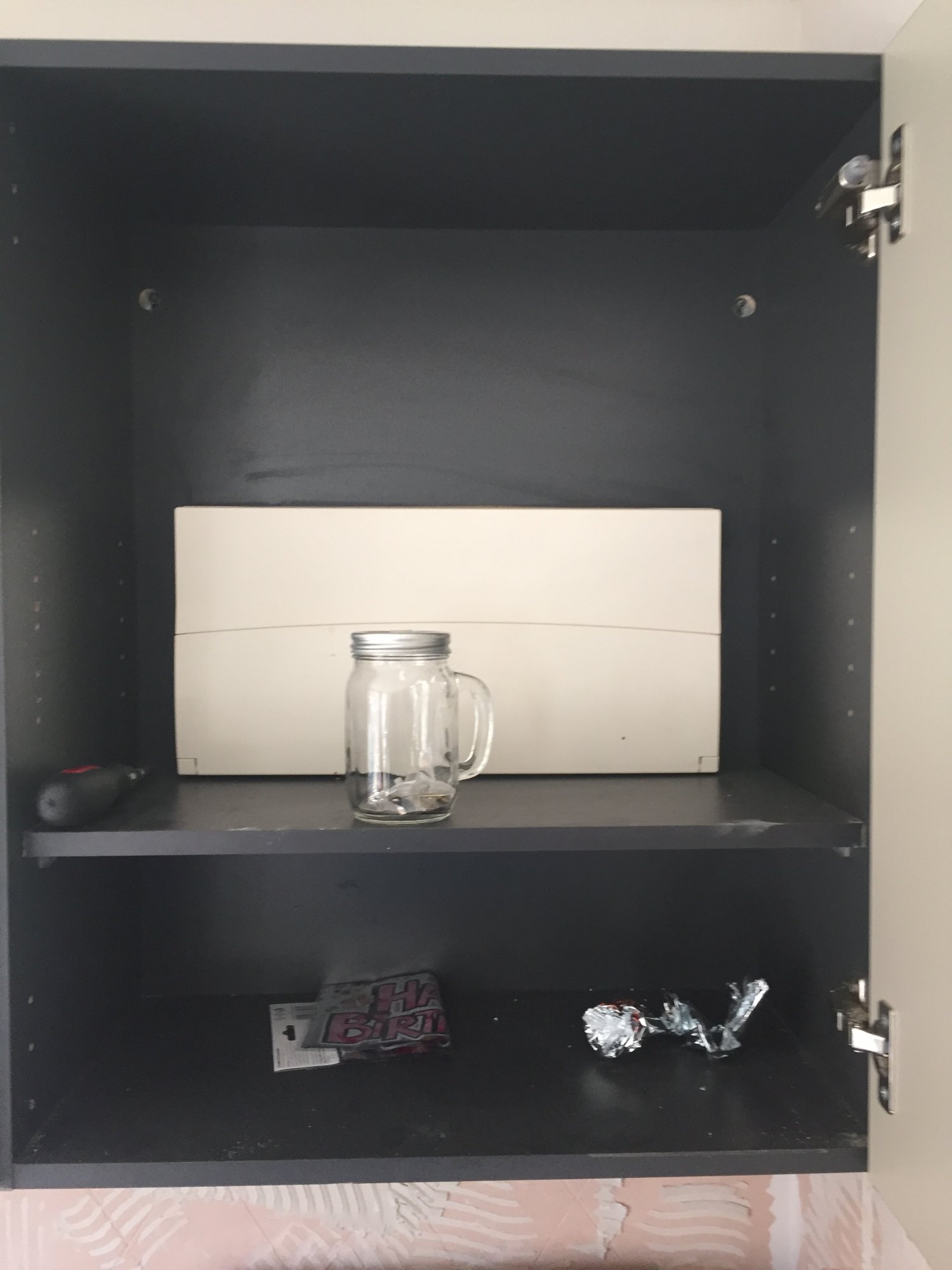

The wall cabinets will be sitting onto brackets - lift the unit and it should come off the brackets.
Have a look for securing screws low down in the back of the unit - if there are any then remove them first.
Take the doors off the cabinets before you lift them off the wall brackets.
The screw tightens it to the wall bracket , loosen and lift off wall brackets.
Thanks all. Was being a bit dumb. Loosened screws but still wasn't budging. Cut sealant away and all good! Didn't realise the sealant would be that strong!
