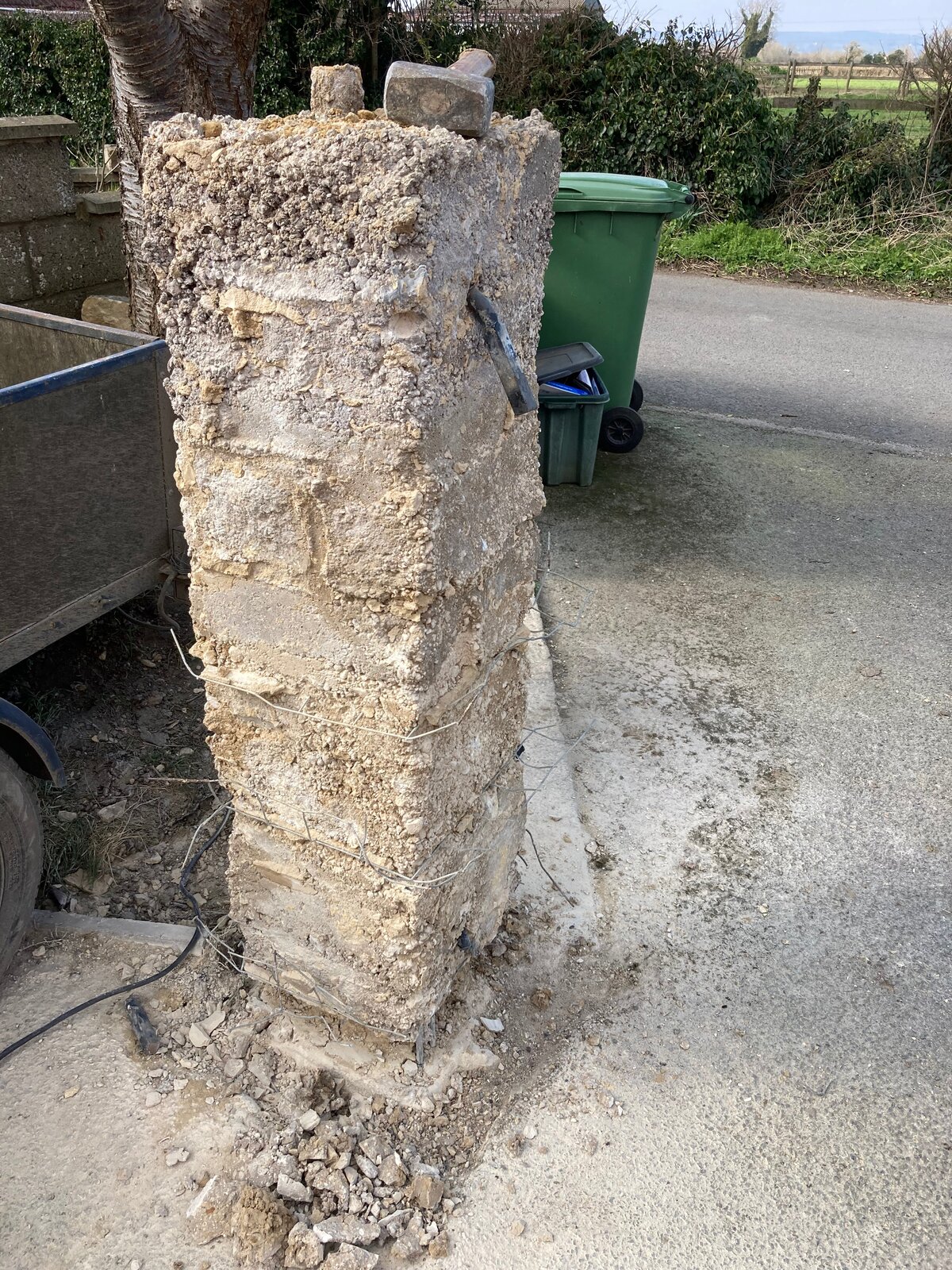

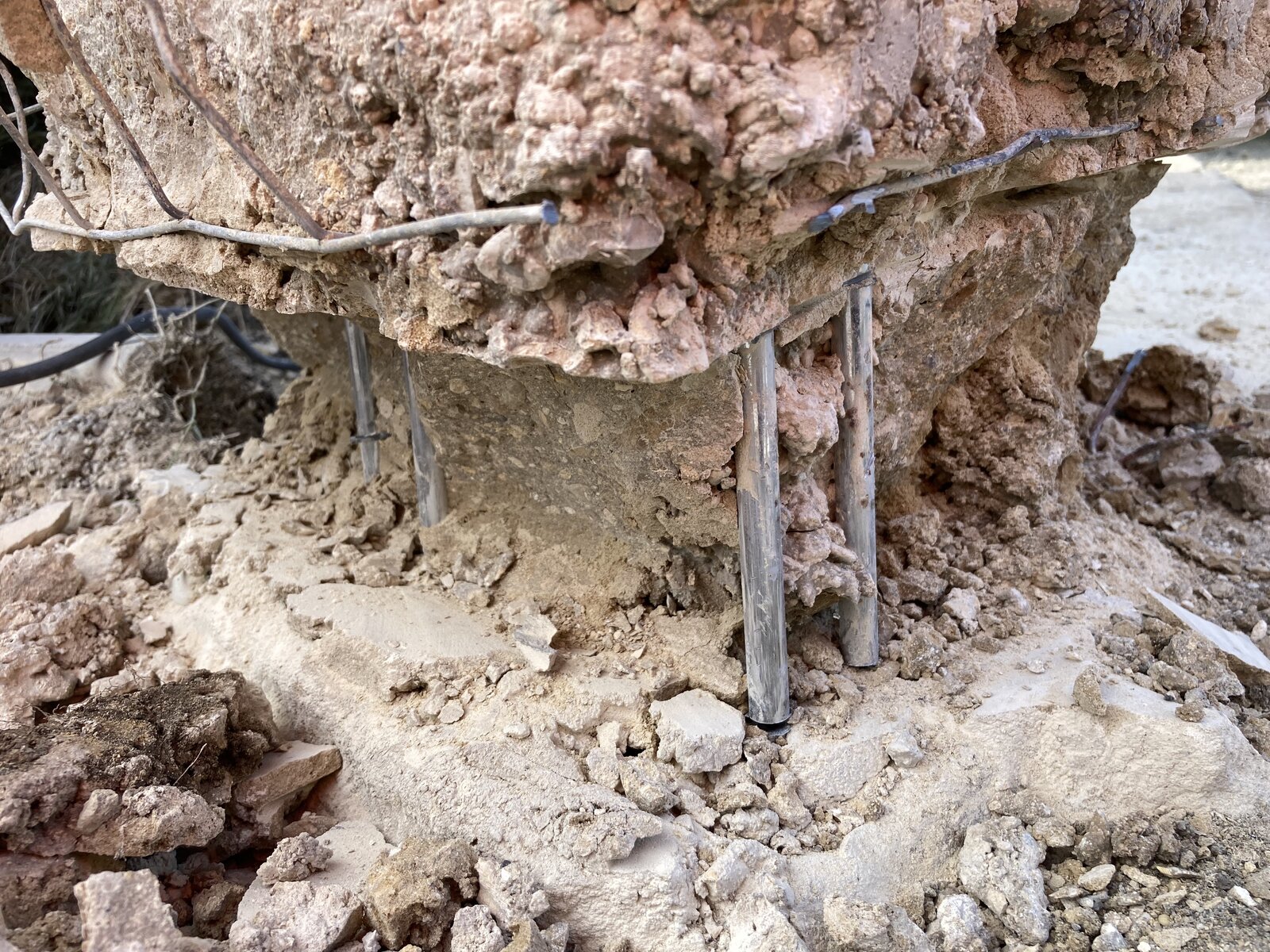

Just spent best part of a day (well I'm currently suffering with Covid o_O) demolishing / removing the outer brick skin of a 1.5 metre high brick gate pillar and am now left with the central concrete core, same height and around 35cm square. It's worryingly solid, with a small stub of scaffold pole poking out the top and what looks to be smaller dia steel rods around at the base about 3cm in where I started chipping it away. Looks like someone did a proper job but it needs to be gone in the next 2 days.
Whilst I sit nursing sore arms and sipping max strength lemsips with a foggy head the only immediate option short of an airstrike or pulling the back axle off my 4x4 is to start cutting away all around with my 9" angle grinder - but that's only got around a 3" depth cut ..... or am I missing a trick? There's a tool rental co. not too far away but any recommendations to allow me a more relaxed sleep greatly appreciated.:(
It's nigh on impossible to know how deep it all goes as its locked between driveway, a tree stump and, just to add some fun factor.... the gas main :eek:. It only needs to be removed down to ground level though.

You can cut deeper with a 9" grinder - a series of horizontal slots and bash it out to make space for a deeper cut. The turbo blades I have will cut rebar as well.
As King says - and I guess means a petrol one ? You could stand it on the ground with the blade vertical and just push against the concrete- make enough cuts to weaken it and carry on with smaller tools . Hire shop will advise ;)
Personally I have an Evolution electric one, but petrol will do the same and will have the benefit of water to suppress dust if needed.
A 300mm disc will cut around 100mm deep, so I'd chop enough out on one side to allow a second deeper cut (i.e. to 200mm depth). That'll take you through the scaffold pole (the disc cutter will cut through this.
Then you can cut round the other side and that'll be pretty much all the way through.
Be careful to always stand to the side, as it may topple early.
Thanks all for the input - it came down a bit easier than expected in the end and with just my disc cutter doing the horizontal cuts as mentioned above. That's the beauty of just asking others - as I would have done angled cuts (like chopping a tree down) whereas going horizontal and whacking out the section worked a treat.! Bizarrely... and luckily.....the central scaffold pole stopped a fraction above where I was cutting so once I'd gone in so far it was just a brittle core which snapped with a some hefty pushing rather than the reinforced nightmare I was anticipating. It really was a hard solid concrete chunk.... but that's also the strangest looking rebar I've seen in a while o_O
