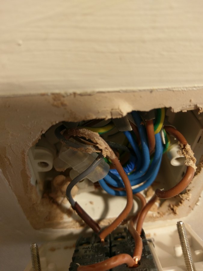

Hi,
Been getting into home automation over last 12 months. Nest thermostat, smartthings hub, some lightwaverf relays/wireless switches for outside lights etc.
Have a couple of lifx bulbs in the hall, and its always annoyed me about the ongoing issue with smart light switches (someone turns the switch off, and the bulb cant be controlled etc) that afflicts users in the UK. Anyway, was looking at various solutions for resolving (relays, wireless switches etc) and decided to take a look at the wiring. Surprisingly it appears to have a neutral wire feeding the switch (in hindsight this makes sense as the switch was added during some building work a couple of years ago). The original switches in the house don't have a neutral. This allows me to consider using various powered smart switches. Just to be 100% sure, can someone check the picture and confirm if it has neutral (done a fair amount of electrics around the house over the year, but never had a neutral to the light switch before). I can buy the smart switch if I know there is a neutral.
The pic is back of 2 toggle switch (common at bottom of pic, and S1 towards top). Its the blue wires that I think confirm it?
Thanks in advance...
Kris
Why not just test them and find out?
They probably are neutrals, but it's possible that the switch was installed by a numpty who didn't know you could use both cores in T&E for switch drops.
I'm not sure what easy to fix solution exists for this problem, assuming you want to be able to use the switch still, and not rely just on apps? For the outside lights, I use a lightwaverf relay, and have covered the powered lightswitch with a lightwaverf wireless switch!
Testing will be next on the list, just wanted to get a idea I was going in the right direction! The sparky who installed all the electrics couple of years ago, was pretty sound, and knew his stuff, so hopefully its 'probably'... :)
I'm sure it will be.
How would you know that he "knew his stuff"?
He was onsite for a few months (was also a carpenter, so all in one solution for fitting the kitchen), and was always happy to explain what he was doing. Also got complimented by the third party part P certifier, who was very happy with the job done!
