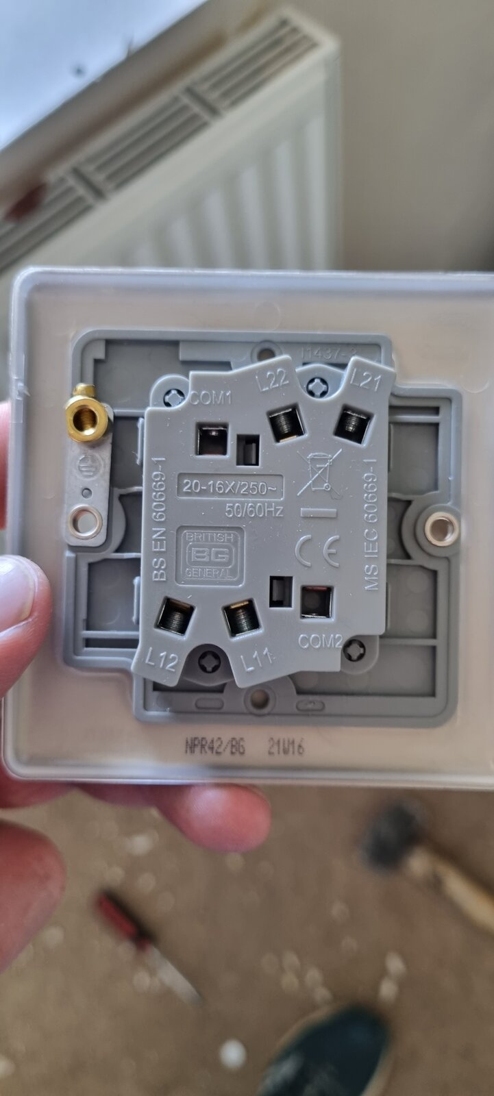

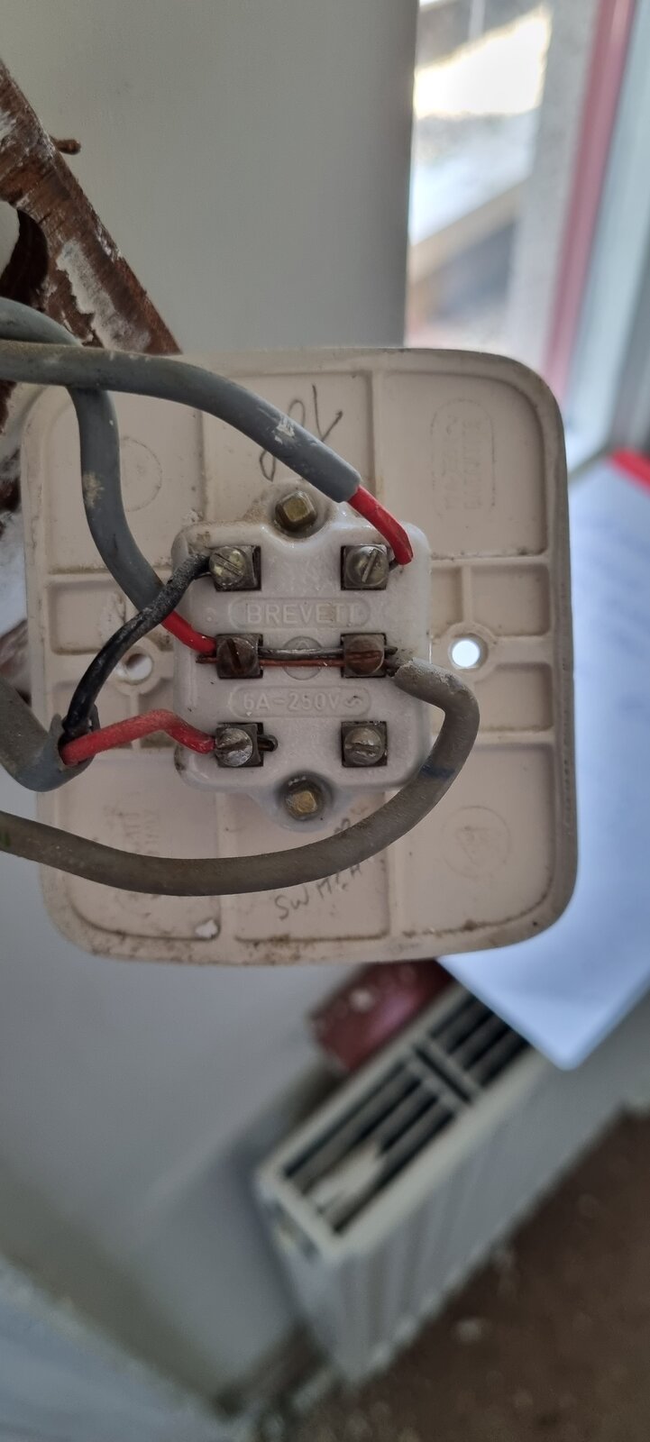

Hi,
Swapping out some old switches - including fitting back boxes. House is 30s and presume original wiring.
Just been tested by an electrician and all OK, and having a full rewire when we have some work done next year. But for now, not sure how to wire these.

The wiring is not from the 30s, probably 50s or early 60s.

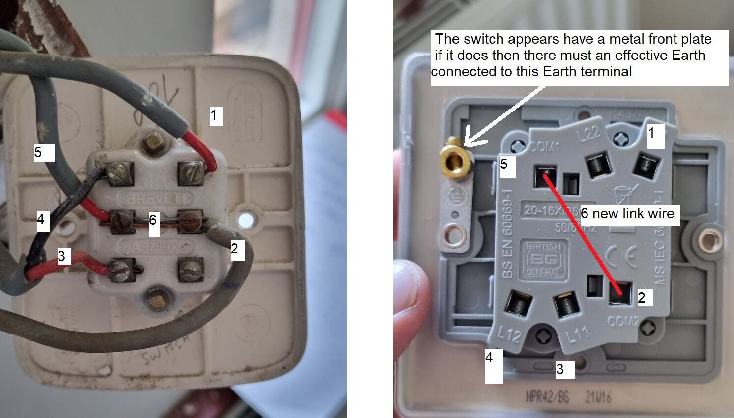

It's unlikely you have an earth connection at your light switch position, meaning you cannot use your new switch.
The backbox is wood, and no earth. The new faceplate is metal so won't be using it. Got plenty of plastic ones so will use those.
Thanks for all the replies- very helpful!
Does it matter? He is fitting new back boxes.
A new back box is likely to be metal, and there is no earth.
Old switch back boxes when no earth was present, at the time when this age of wiring was used, tended to be wooden, or metal ones with nylon lugs.

Note: The terminal numbers on other (plastic) switches may well be different to the ones on the metal one in your photo.
