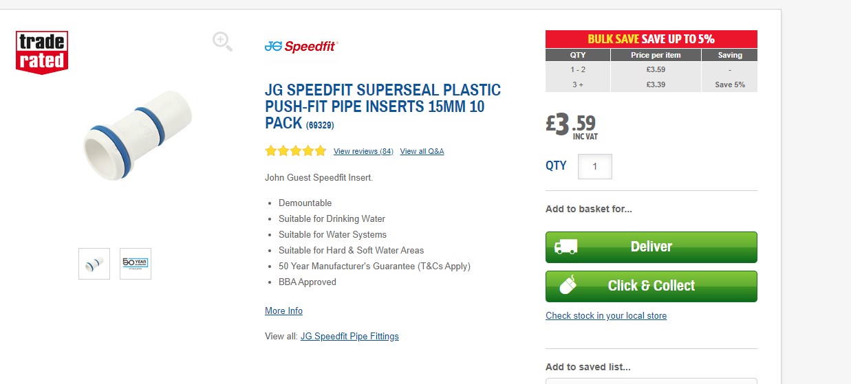

That link doesn't work ? Anyway ,your plastic pipe coming out the wall should already have a stiffener in it already ,and as you are using copper ,copper doesn't need one ??
Yes that's one type of insert ,it's best practice to use pipe stiffeners from the same manufacturer that makes the plastic pipe. As they are made to match. No guarantee that the INTERNAL diameter of 15 mm plastic pipe is the same from one brand to another.
