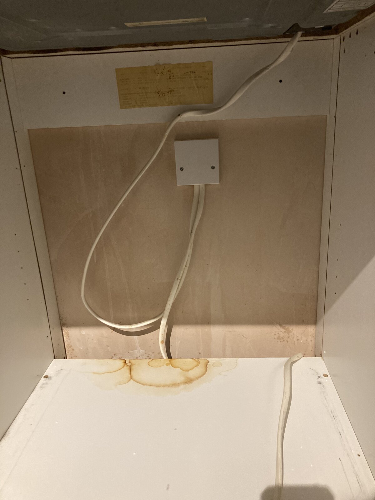

I have a hardwired 13a hob and 13a oven that is connected to the cooker circuit. The circuit has a 32a MCB.
Do I need a seperate spur for both the oven and hob for protection?
How / where are they both connected to the circuit ? If in a dual outlet connection unit ,you could run 2 single sockets from there ,one for each .
It’s wired in to this.

What are the kilowatt ratings of oven ,and hob /What makes you think they are both 13amp appliances ?

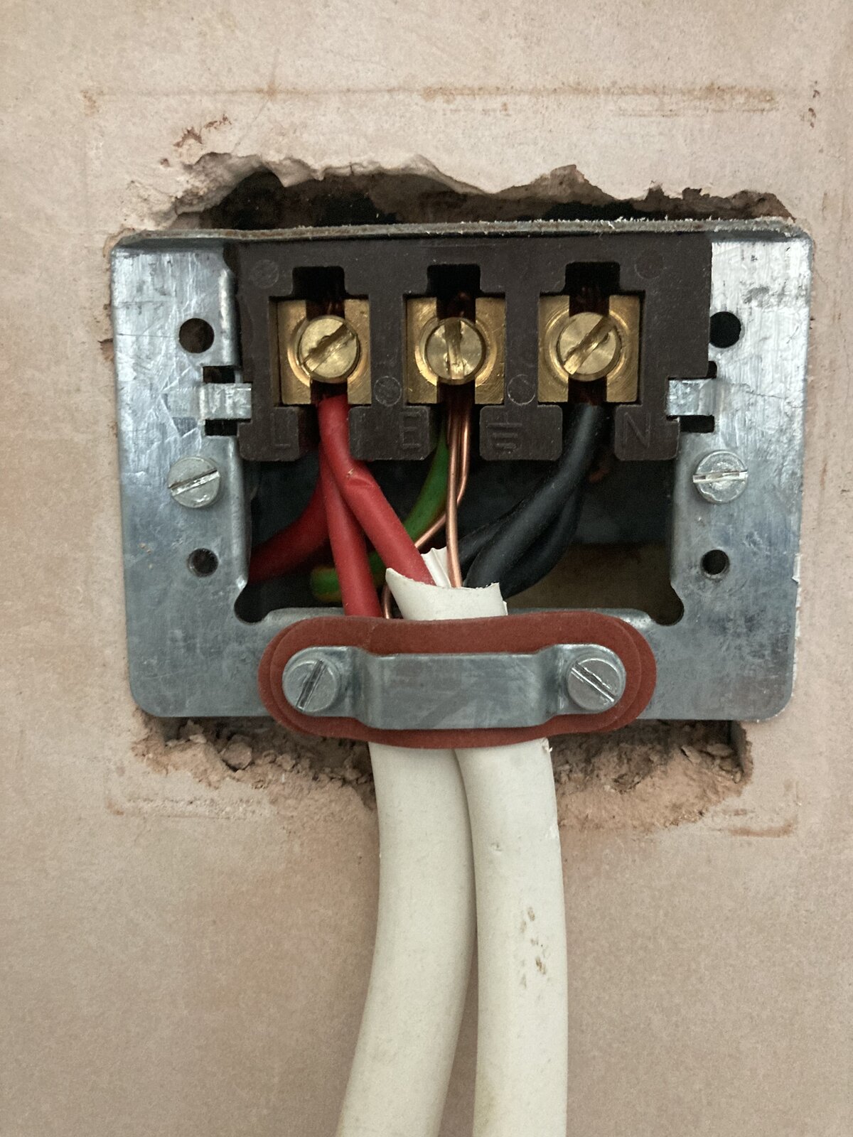

Directly behind the oven

Both user manuals state they are 13amp. The hob itself had a plug connected which has been cut off and wired directly into the circuit.
More than a plug cut off ,it's had the original flex removed and Twin and earth cable used instead ,and no sleeving covering the bare CPC's in the connection unit( and very likely the same at the appliances ).
Installing a single socket for each ,and using correct size FLEX from each appliance to a plug is one way forward.
The photo was taken when the old 6.6k ceramic hob was connected to the circuit which had the thicker cable. The new induction hob had a more conventional domestic appliance type cable with a moulded plug.
The oven was replaced last year and I reused the cable from the old oven. To be honest I didn’t even realise it was 13a until I read about it.
Assuming those white cables emerging from the cooker outlet are 6.0mm2, I think I'd just cut them where the cable enters each old appliance.
And fit a single socket on the end of one of them.
And a 13amp fused connection unit on the end of the other one.
Assuming the wiring at the cooker outlet is sound.
