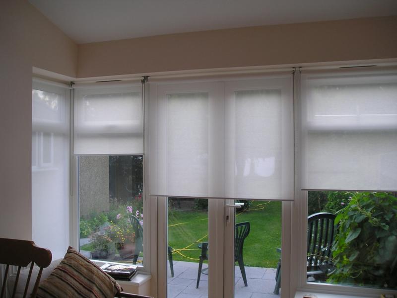

If it's only the windows you want to do IKEA do some excellent gauze blinds really cheaply. They can cover a drop of 2.4m and come in a variety of widths. I recently used them for a 3.5m run of windows. Total cost was £55.
If you want blinds for the roof be prepared to spend significantly more.

Hi again. Here's the blinds in all their glory.
We've been very happy with them. Far less prone to picking up cack than Venetian blinds. At this price you can chuck them away when they're filthy.
I agree with masona, though, about getting the heat out. The extension in the photo was originally planned as a conservatory by the wife until I vetoed the idea. We compromised on a proper extension with lots of window, 6" of Celotex in the roof and a Velux for ventilation and even more light. It's very comfortable in all seasons.
